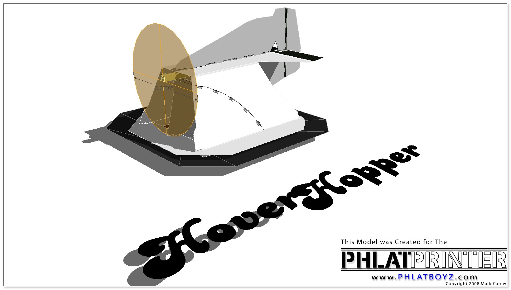

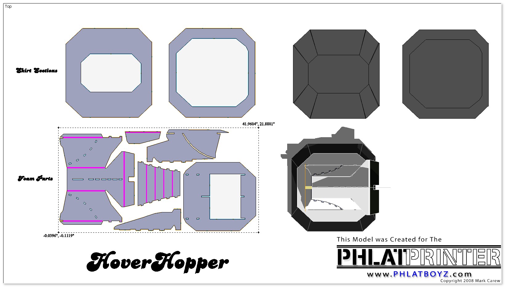

    The Hover Hopper is an attempt at creating a hybrid hovercraft/aircraft of sorts.
    We are going to take this to the indoor fly-in tomorrow night (1/14/10) and give it a test :D
    This is the first prototype and there are parts that do not line up right, but I said I would post it and so here you go.
    I will rework the code after testing tomorrow there may be more changes at that point.
    The prop is 10x4.7 with a Blue Wonder Motor
    The Skirt is made from 3mm contractor bag'
    The craft is from 1/4" fan fold foam
    Have fun!
    Mark and Trish Attached files HoverHopper.skp (644.7 KB)Â HoverHopper_FOAMPARTS.cnc (16.2 KB)Â HoverHopper_SKIRT.cnc (2.8 KB)Â [​IMG] [​IMG]
