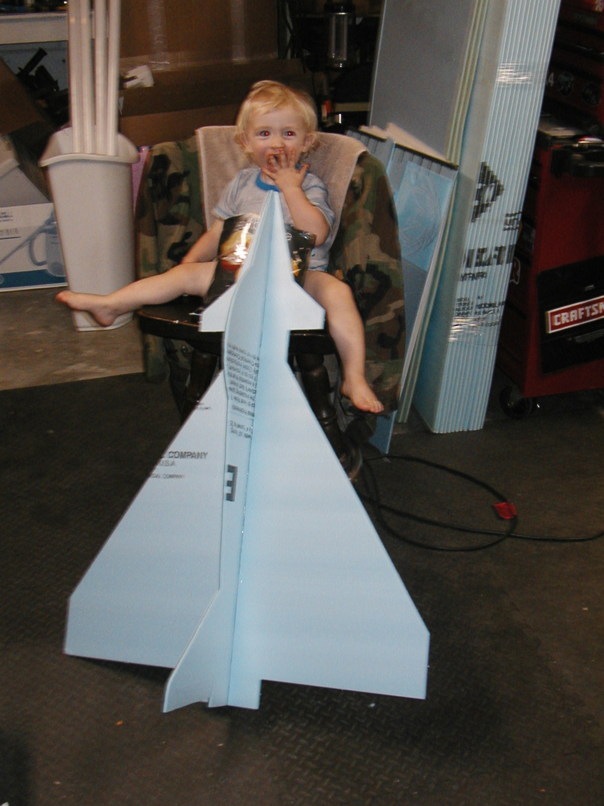

    Here is a picture of Eli with the Guru 364.5! This is a 40" long, 31" span pusher that we hope will be both a 3D machine, as well as a faster Parkjet.
    This one is a chuck glider, and Eli loves to "help" me toss it around to check the CG.
    As soon as I get some electronics in one, I will let you guys know how it does.
    The 3D version will have a close to mid-mounted motor and prop, to get some prop blast over the surfaces. The faster version will be a pusher..
    I just wonder how long before Eli wants to take the radio??
    Tim

    Tim/Lucky that is too cool bro! Congratulations!! on a job well done!!
    Soon Eli will need a radio of his own and that is going to be a great day indeed!
    I am looking forward to the 3D version of the GURU 364.5 as most of the guys here on the Phlatforum know I never had much luck with pusher/mid-motor designs, so I am looking to see what you guys come up with and how well it flies.
    Can't wait to see more you your creations.
    Great job Tim and Lucky now it just a matter of thinking up designs :)
