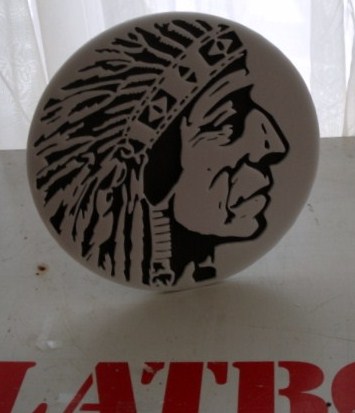

    Here is a cool looking Indian head that was created from a black and white picture file then cut out using 6mm depron (Black and White)

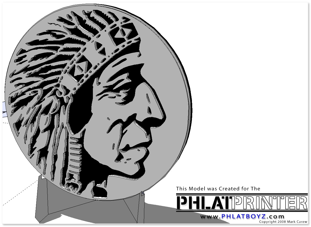

    Used Vector Magic to creat the vector to import into Sketchup you can find it here
    http://www.phlatforum.com/viewtopic.php?f=147&t=1541#p15106
    The head is cut from white and the backing and stand from black.
    I have not tried to cut the stand yet but it should work fine.
    I used 3M spray on the white head part to glue this to a piece of scrap black 3mm I had and cut around the circle by hand and it worked out fine.
    Enjoy
    Mark Attached files [​IMG] [​IMG] Indian Head Circle.skp (3.7 MB)Â IndianCircle1.cnc (7.7 KB)Â IndianCircle2.cnc (145.6 KB)Â [​IMG]

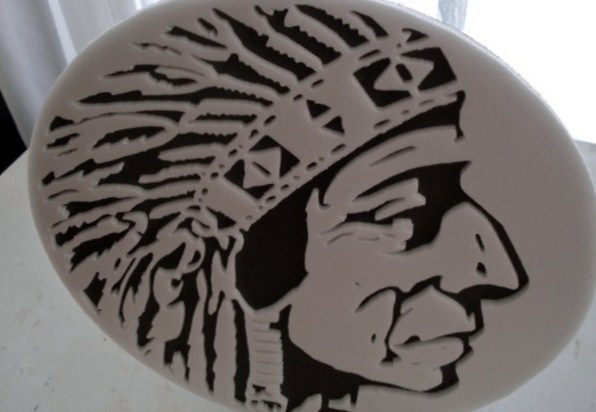

    Very neat project. I cut one out today but it did not turn out too well. Problem was (for me) deciding which pieces shoud be cut out and which pieces should stay. Lots of small cuts in the design and my machine ripped a few of the parts out during the cut. Would a different cutting speed help?
    Chuck
    ...somewhere in Indiana...
    You could try to slow it down some. Did you use the 1/16" bit?
    I did not want to tab all the small parts so as it would cut I would grab the real little parts that could cause it to mess up.
  10. Chuck
    Chuck New Member
    260
    Yep, used the correct bit and maybe could have cut it a little slower. Ill try another before long as I think this is a truly neat project. There should be medals available just for people who can and do design such things!
