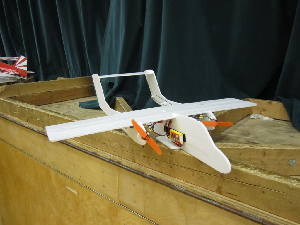

    Here is a new design I have been working on. It handles high speed and slow flight really well. It lacks the elevator authority to get into a proper stall and it doesnt seem to want to fall off to either side.
    Made out of 3mm depron and reenforced with CF rods. The motors are mounted with a tiny bit of upthrust and that really seems to help it pull through the coners. Only one rudder moves and it is really effective at turning left but not so much for turning to the left due to the non-counter rotating props.

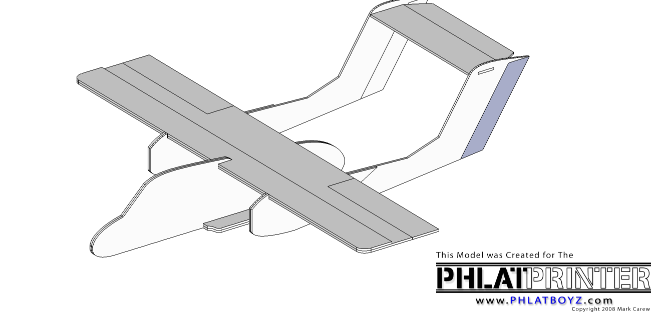

    I will have to clean up the sketchup file and possibly make a sharpie files for it now that I know it flies well.
    Here is all the crap I used to power this little gem. Wingspan is 26"
    C10 Micro brushless outrunner 2900kv
    http://www.hobbyking.com/hobbyking/stor ... oduct=6584
    TURNIGY Plush 6A /.8bec/6g Speed Controller
    http://www.hobbyking.com/hobbyking/stor ... oduct=4318
    GWS EP Propeller (DD-5030 127x76mm) (6pcs/set)
    http://www.hobbyking.com/hobbyking/stor ... duct=10033
    Flies best with a 360mAh 2S but has no trouble hauling around a bigger pack.
    Servos are some 2.5gram ones I got from a clubmate.
