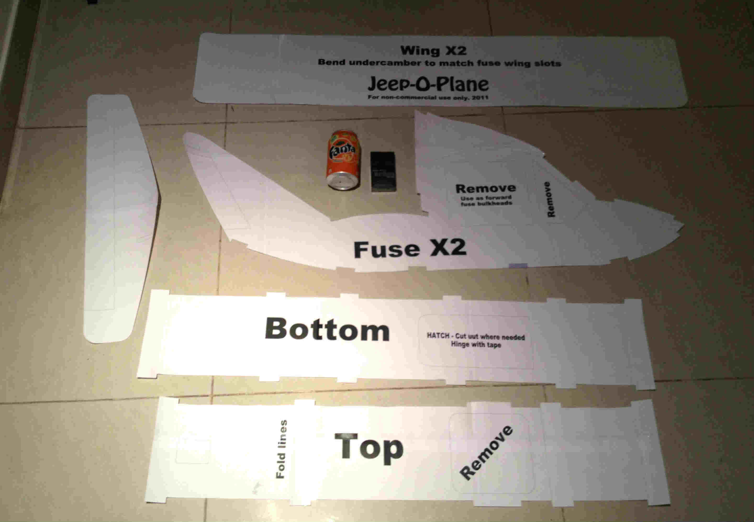

    I agree with you buddy, here is a little update. Cut out my templates and place some scaling object that will give you a bit better feel of how big this Jeep-O-Plane will be...

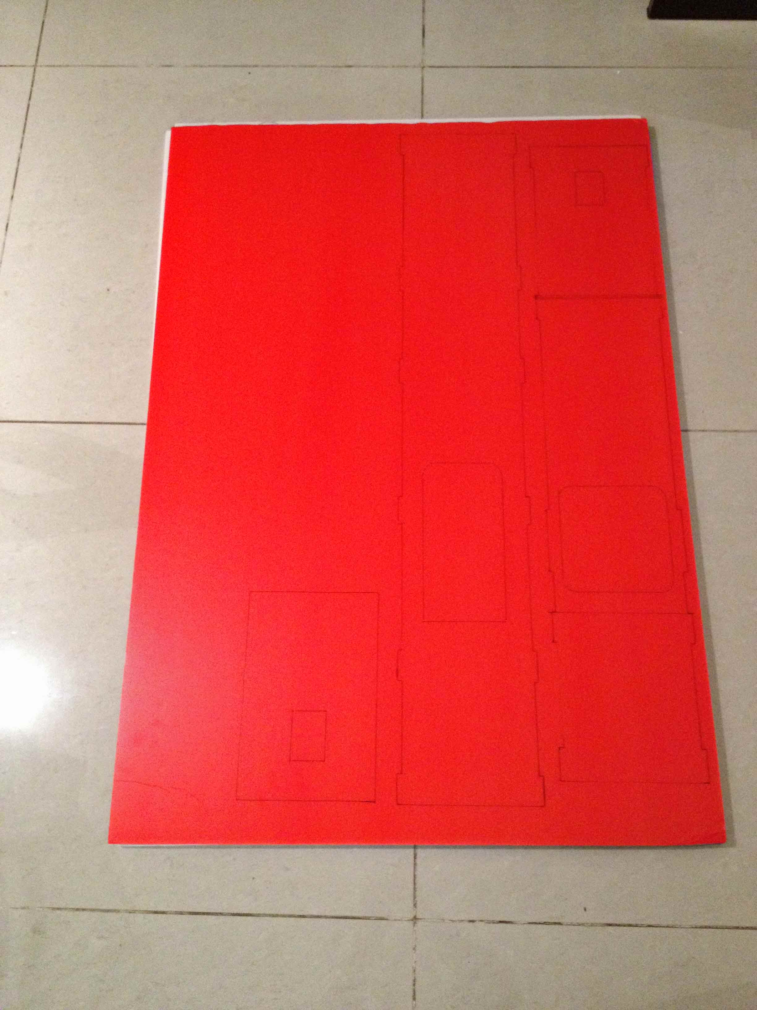

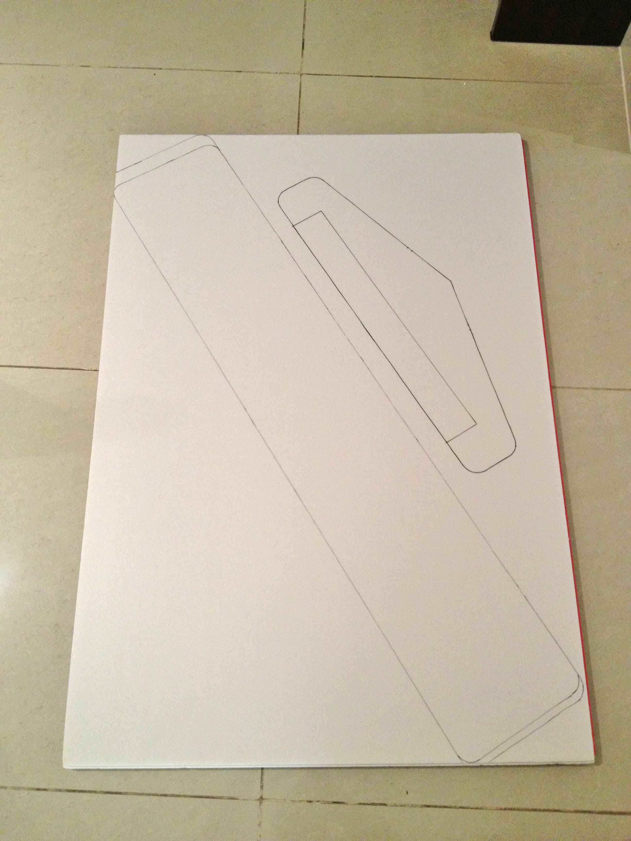

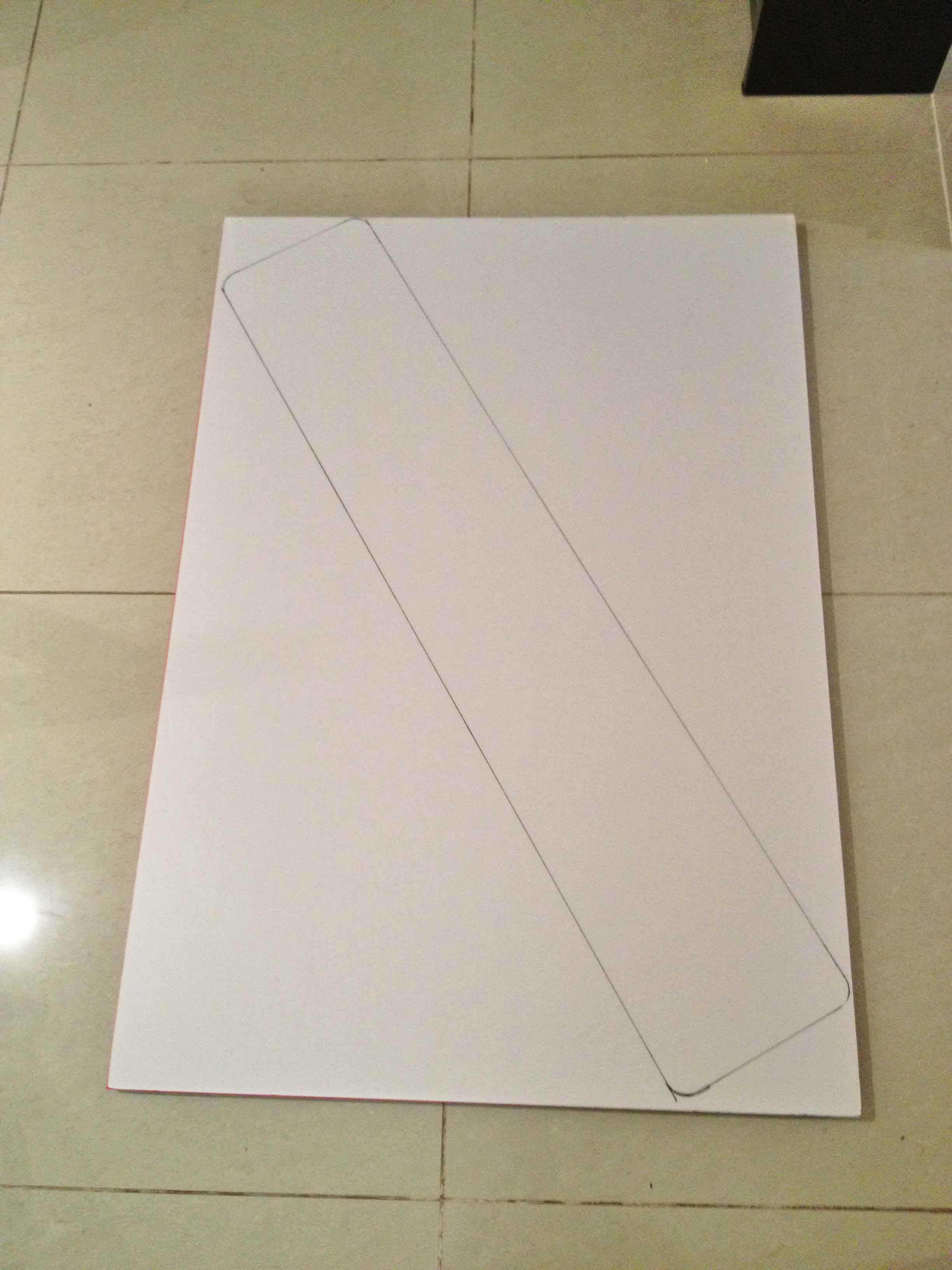

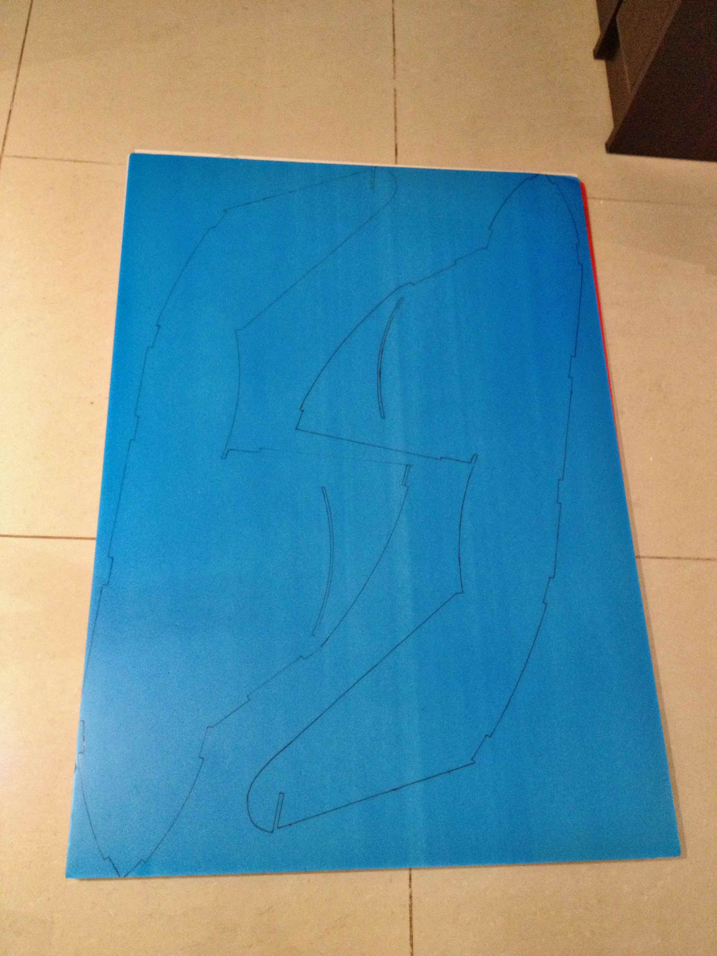

    Well I traced out my parts Yesterday and the complete build came onto 4 Depron sheets as I wanted the wing to be in one piece instead of making 4 half wings.
    The fuselage only fullfil 1 sheet alone for bothe side, another sheet is used for the top and bottom part and the firewall.
    The top wing is place on diagonal along with the horizontal stab/elevator and the second wing occupies another sheet.

  7. RCSquale
    RCSquale New Member
    Fuselage side
    Fuselage top/bottom/Firewall
    Wing with horizontal stab/elevator
    2nd wing
    There might be slight difference in wing size, if it is the case I will place the smaller wingspan as bottom wing. Attached files [​IMG] [​IMG] [​IMG] [​IMG]

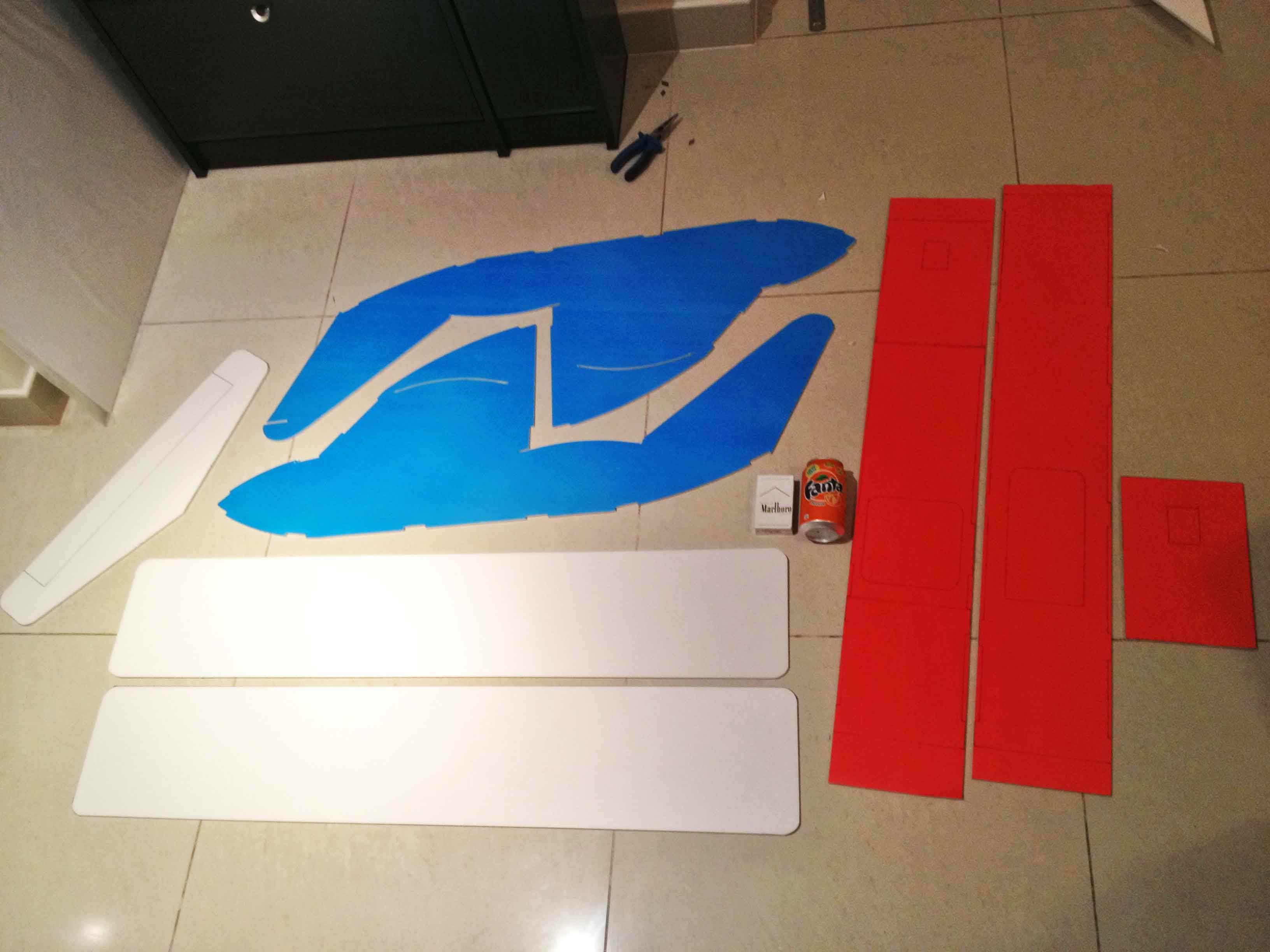

    My parts are cut now... still need to do the hatches and noches in the top and botoom fuselage bit.
    Altought it is a quick build, I'm having difficulties to find enought time to progress on it... I will see if tonight I can do my wings since that will be the most time consuming in all the build.
