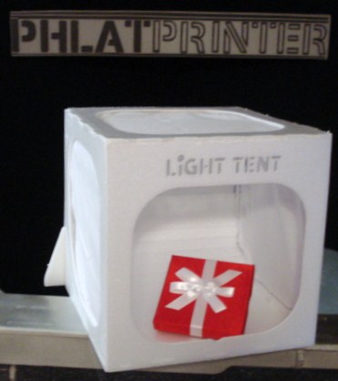

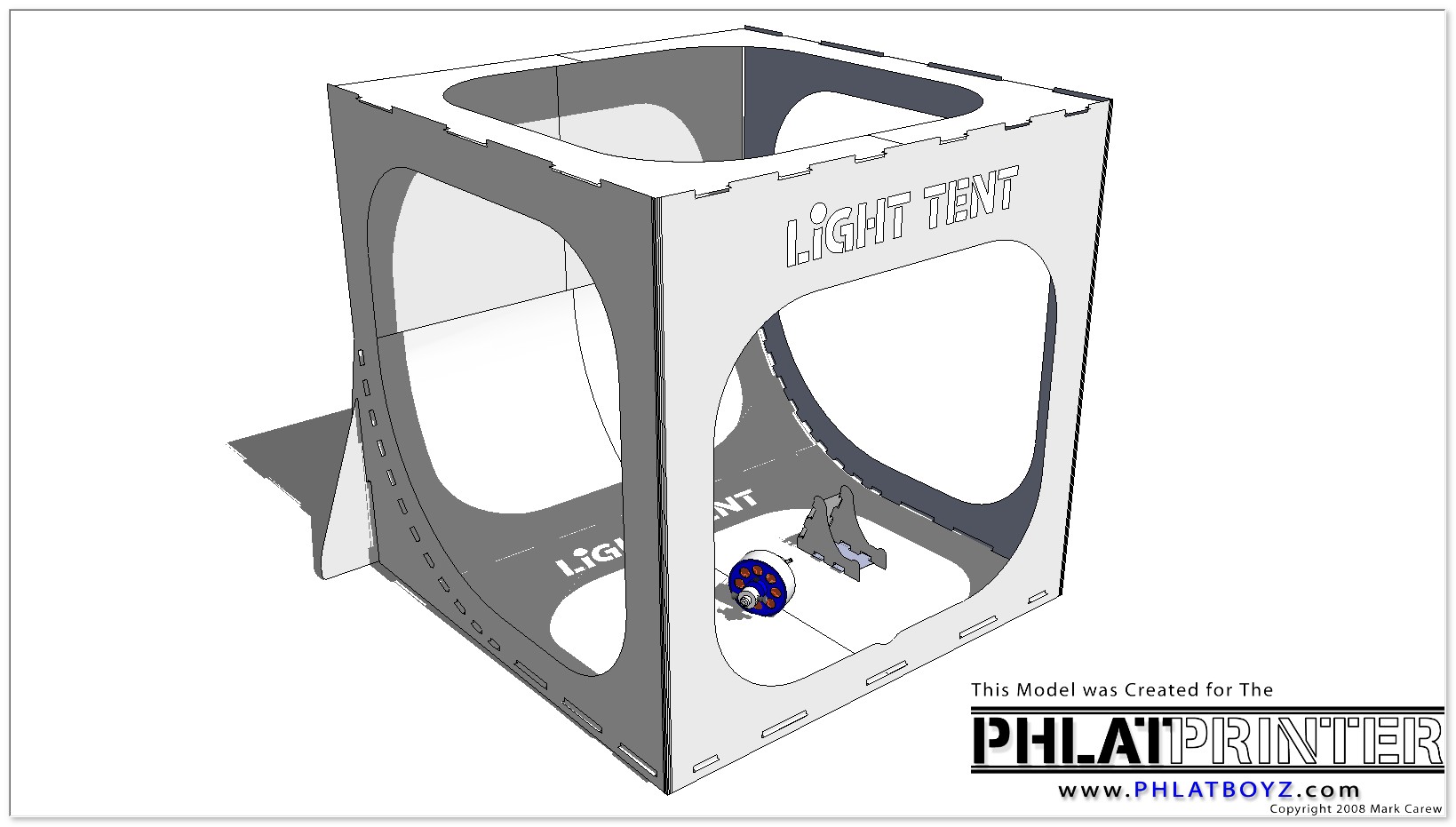

    Here is an inexpensive 'light tent' diffuser for you guys to use to snap professional photos of your products to post.
    This is the link where I learned how to make one. It may be helpful as well.
    http://digital-photography-school.com/how-to-make-a-inexpensive-light-tent
    Here is a the live build show video so you can see how it goes together.
    http://www.phlatforum.com/viewtopic.php?f=180&t=1493&start=0
    The material is any thin white fabric that lets the light through. Make sure to save the inside window cut outs for the sides and top to use as a pattern. Also make sure that you add a good 1/2" around the edge to allow a gluing surface for the material to the foam.
    This was cut from 3mm depron with a 1/16" bit, but maybe a better suited size for larger products would be 1/4"/6mm, just scale it and rework the cuts to the new foam thickness.
    Have fun Enjoy and if you take cool pics using it please share your technique and photos here.
