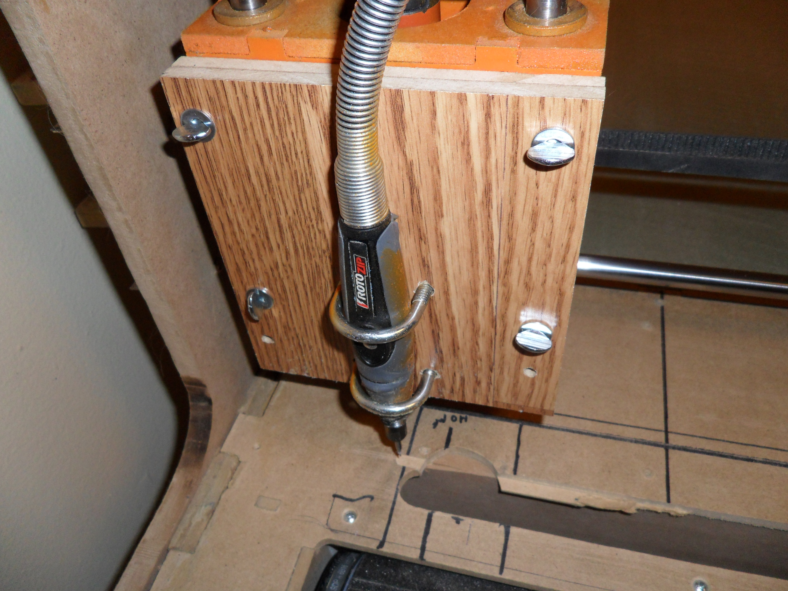

    mark and Trish were talking about a pen adaptor before for use with the phlatprinter. i decided this would be a very useful tool for qualifying cut files before cutting foam. also i already had the pens that are used on my vinyl cutter. they are like a felt tip with black ink. i cut the attachment on my phlatty using 1/16 ply. also it uses a light tension spring for the pen. i have a carrier sheet i can use from my vinyl cutter. i can stick roll paper i have to draw on. also i know i am giving up 2in on my y-axis, but was to lazy to mount to the center line of the dremel.my brother has my good camera, and i am unable to get a video of it in operation rite now. so for now here is some photos of what it looks like. peace, randy.

    Wow!Randy your mods are all really coming together to make a machine with so many more capabilities! It would be cool to see a foamie plane with all plotter pen graphics on it! Sounds like that may be your next step after using the pens to check cuts.

    thanks Shaun...my main reason for the mod is that i always dry run my programs. with the pen, i can tell better were the cuts are going. common man, get them latches installed, lols. i am still waitin on my motor mount for my new project. and when i get rollin on it the pen mod should help me alot, as you know my programing skills are rather lame....hey great job on your speed plane project, your almost ther...randy.

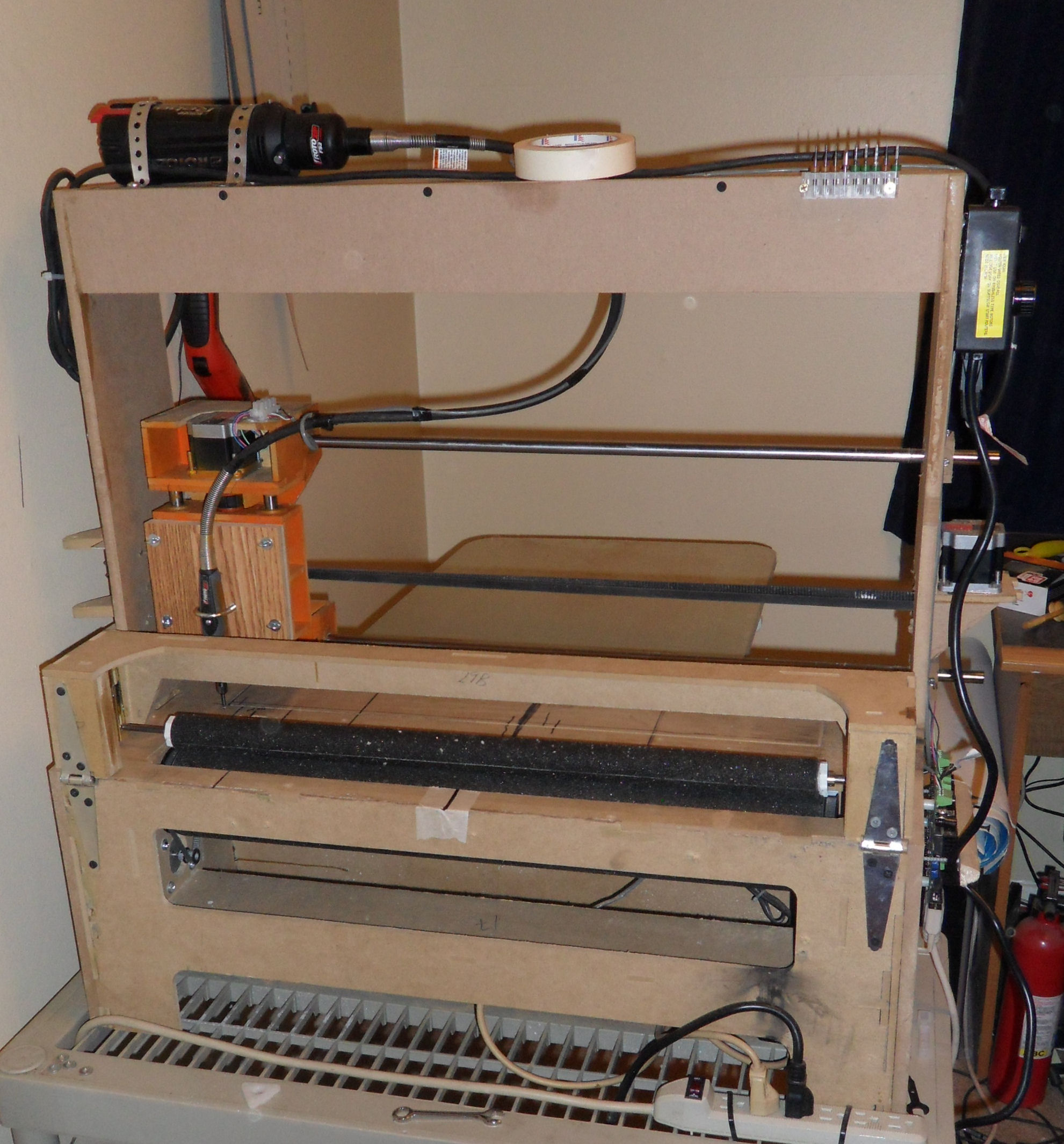

    I am close to having this mod done on my machine, I was having problems with foam dust getting into my bushings with the gantry below the table and causing chatter.
    I got tired of having to pull it all apart to clean out the bushings so I went ahead and started the mod.
    I just have the belt to put on it and make the pressure roller lid.
    I built mine so that it can be put back to stock if needed, I just screwed the sides onto the existing sides.
    It should give me over 23 inches of width cut, I could get 24 but I don't like getting the gantry that close to the sides )
  23. rjarois
    1,263
    36
    royal oak, michigan
    cool jeff....should be cool with the belt drive mod. randy.
  24. Jnida63
    Jnida63 Member
    749
    Ok, it's done except for a few little tiny things I want to do.
    It isn't near as nice looking as Randy's but it works really well.
    I modified the Z gantry for a removable front plate so I can switch out different things, I am going to put a plotter pen faceplate on it once I find an old plotter pen to set up Attached files [​IMG] [​IMG]
