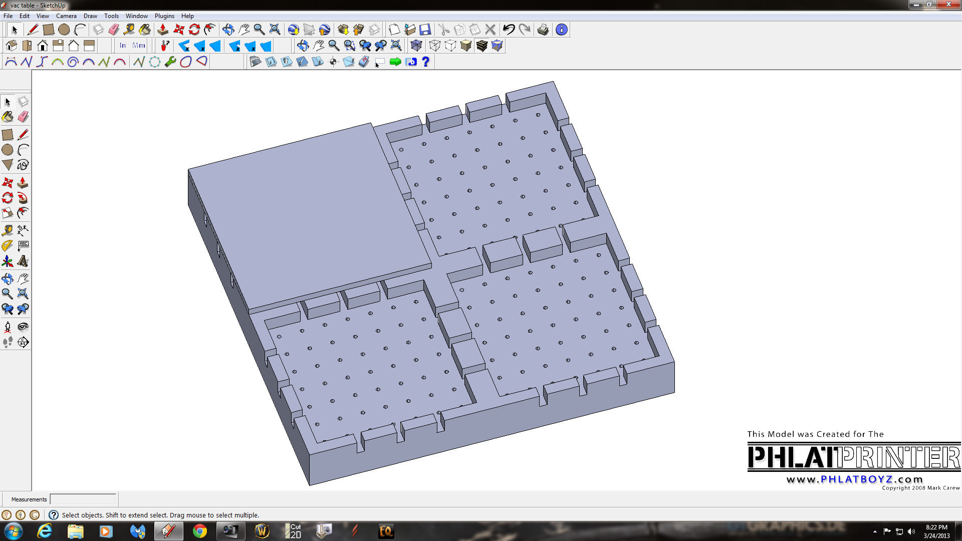

  23. Jnida63
    Jnida63 Member
    749
    Here is a beta version that I am working on made from 1 1/2" blue foam.
    Each piece is 12 inches square that you just tape or glue together to make the size you need, I have 1/4 of the picture covered with 1/4" fan fold foam as an example for the bottom.
    I am hoping it is strong enough for simple foam jobs being that the thinnest part is 1 inch thick.
    Do you guys think this will work? I am open to suggestions as always Attached files [​IMG]
  24. 7up
    7up Moderator Staff Member
    1,090
    Kentucky
    $65.00 for 16 sheets? :roll: I better stick to FFF and DT, I leave the skin on anyway and enjoy painting my planes. Looks like fine material though.
  25. TigerPilot
    1,578
    Jeff, did you try to slow the feed rate down? I don't know how this foam works with the bit, as in 'does it melt', but the symptoms that you've described are typical of high feed rate. With the DT foam you have to have the rate high otherwise the foam melts and sticks to the router bit, with this foam too?
    I read that this foam is made by the same company that makes the DT foam I just don't know if it is the same material, just thicker.
    BTW, what is it that you are making with these squares?
    @Buk, I reacted the same way as you! I don't get FFF here in SoCal so I stick to DT foam, which I can get in other dollar store too, btw. :dance3:
