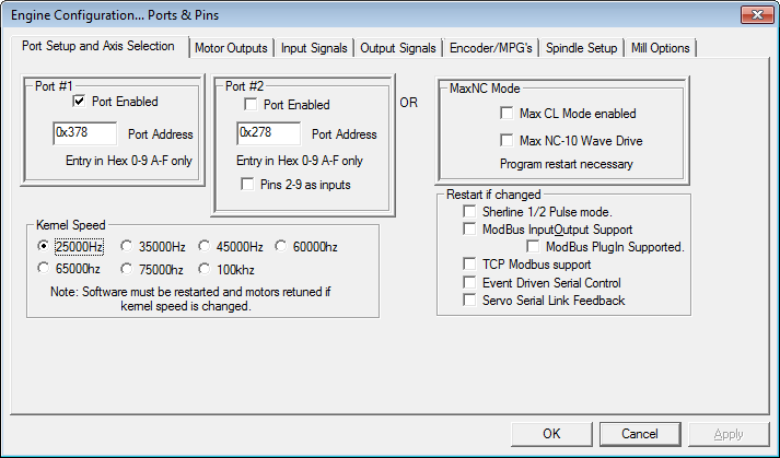

    You can change the port address in mach3: Config > Ports & Pins > Port Setup and Axis Selection > Port # 1 > Port Address > 0xc010

    Tried that and got nothing. I then noticed my new motherboard has headers for a parallel port on it. I got a cable for that so Now I have a real printer port. I went into the BIOS and saw where the onboard port was disabled and I enabled it. I checked in device manager and the ports address is 0x378 so I put that into Mach3 but I still get no movement. upload_2014-4-16_21-57-23.png
    What else am I missing? I know the cable is good and the phlatrinter is good cause I can move the cable over to the old PC and it works.
    Any thoughts?
