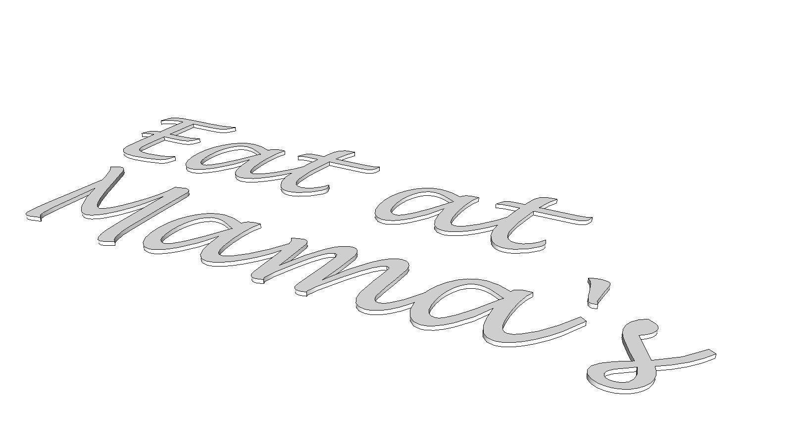

  7. Flashsolutions
    And my neighbor saw the medals and wanted me to cut out some letters for a tin wall piece she had purchased so that it reads "Gerry's Kitchen". It was a bit tricky, but I did it much like the medals and then cut out the individual letters and glued them to the wall art.
    The medals turned out great! :doubleup:
    I did a kitchen sign for my sisters house cut from black 6mm depron. It turned out better then expected. Not a 3D carving just the cut outs, she really likes it :)
