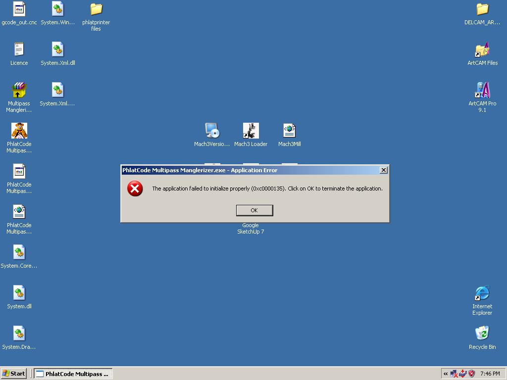

  10. rjarois
    man i can get is a big error with mine...installed the 3.5 net framework also.. :( suppose frankenstein don't like monkeys, just hamsters, lols. randy.

  14. rjarois
    tim the error in with the install...does the pc have to be online??

  16. rjarois
    sorry bear....i posted to tim before this post...his name musta stuck in my brain, sorry. yea thats the problem, it dont unpack rite. and throws up a error. randy.
  17. FozzyTheBear

  18. rjarois
    yea, its when i double click on the bear i get the trouble...i will try to downloag again. randy.
  19. rjarois
    tried again...no dice...just pops up a error when i click on the bear...
    edit...in case it matters the os is xp-pro.. Attached files [​IMG]

    Hmmm! Ermmmm.... that's a bit odd.... If it's extracted those files then the download must be ok.
    Right! next thing to try is to make a new folder, and copy all 9 of the extracted files into it. Put that folder in your root directory C: and then try running it from there. I'm not sure why that would happen. It runs fine on both XP Home and XP Pro that I have here.
    If the above doesn't work.
    Microsoft reports that The most common cause for a 0xc0000135 error is that it indicates that you need to install the .NET Framework.
    First of all though... your copy of XP should be the most current service pack version. At the moment, that is service pack 3. If it isn't then you need to upgrade to service pack 3.
    As for .net framework. You need to make sure that you have Net Framework 1.1 and Net Framework 3.5 installed. Net Framework 1.1 should be installed as standard with your OS but if it's not then you need to install it.

  21. kyyu
    I'm running xp pro also, with the Multipass folder on my desktop. For kicks, I copied the loose files onto the desktop and it ran fine from there also.
  22. rjarois
    bear, did what ya said...same results...hey i don't want you to rack your brain on this...maybe it will work for me if they incorporate into phlatcode. randy.

  24. rjarois
    bear, i never update my machine computers....i have three of them that NEVER go online. ther just for my cnc machines. the only pc that goes online is this main gaming rig....the cnc pc's stay offline at all costs...i don't want them talkin....i kinda figured it didnt work for that reason. i will just have to wait, maybe a cool phlatcode will come along. thanks, randy.
  25. FozzyTheBear
    FozzyTheBear Member
    261
    OK! that's what the problem is then.... So! try this!.... copy the .dll files that were unpacked into your C:windowssystem directory. then try running the program again... it should then find them. If that still doesn't work, try copying them to your C:windowssystem32 directory.
    DON'T FORGET TO REBOOT AFTER YOU COPY THEM or windows may not find them.
