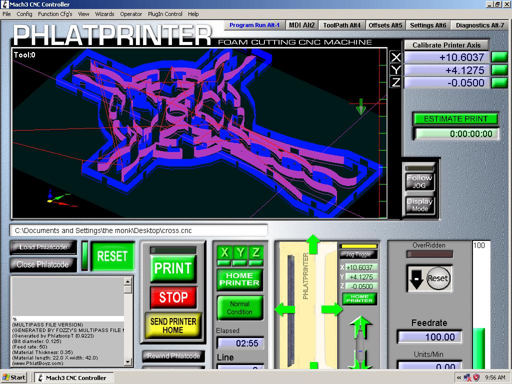

    bear i installed all the re-distributable framework versions, except 3.0 as it would not do unless i went online....i have 1.1, 2.0, 2.5 and 3.5 versions installed. rebooted installed the mangle program, and........it works!!!! man i could hardly belive it, lols. now all i have to do is try to convert a file....i will report back with the results.....thanks for all the fellas that helped. man we have a great crew in the phlatboyz...randy.
    edit:
    i stuck my sisters celtic cross thru the mangle program...now i can cut her a mdf version for her. Attached files [​IMG]

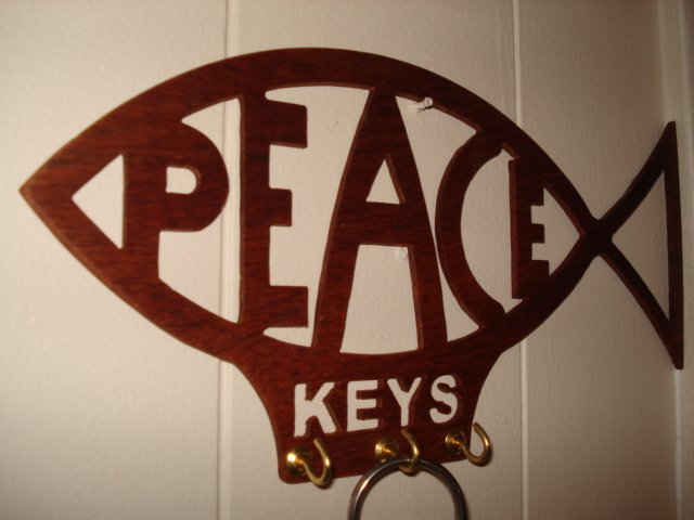

    bear, this is what i mangled up the other day.....after making mark and trish the phlatlab key tag, i figured they might need a place to hang it...this is why i mangled up that mahogany.....the tool used is a .0625 dia. man your mangler code is the whip....gotta tell you again...GREAT JOB !!!!!!!! im waitin for you to put mastercam out of business, lols. peace, randy.
  19. 3DMON
    Dude!
    Randy that is awesome!
    Did you put tape all along the bottom for grip?
  20. rjarois
    1,263
    36
    royal oak, michigan
    shaun, no tape, just my spring pressure mod :D with shallower cuts and faster feeds, the tool pressure is way way lower. randy.

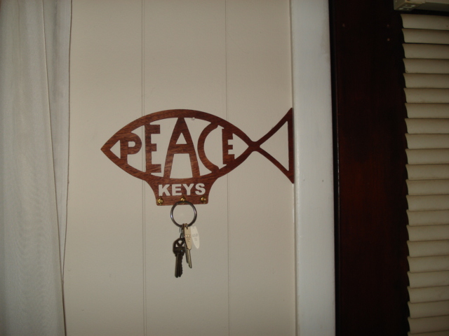

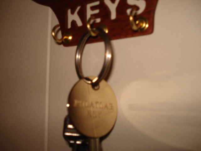

    Guyz check it out! Randy you are too much! This thing looks SUPER professional :!:
    It came out so nice with the stain added and you did a super job packing it.
    Well done we are honored that you sent us this. Its going to be and awesome addition to the PhlatLab! :D
    Man its sure great to have friends like you guys.
    Thanks Randy you rock!!!
    Mark and Trish Attached files [​IMG] [​IMG] [​IMG] [​IMG]
