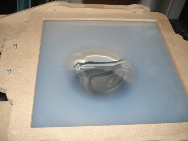

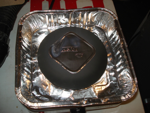

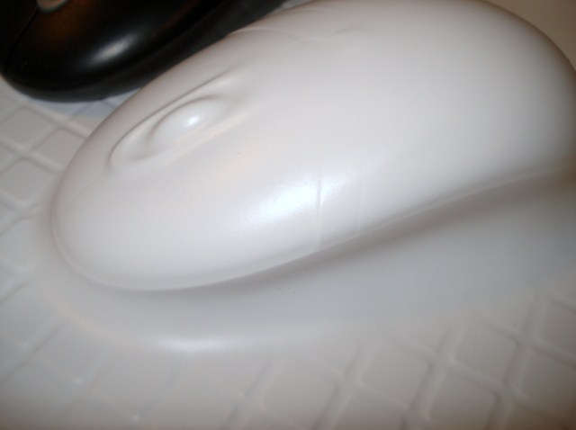

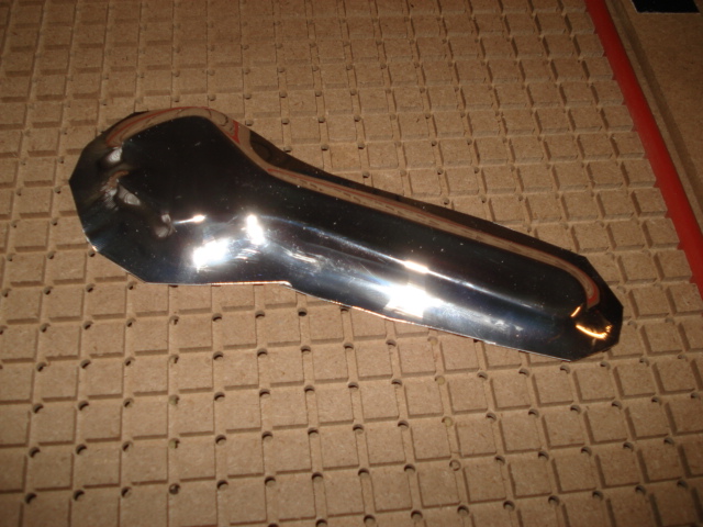

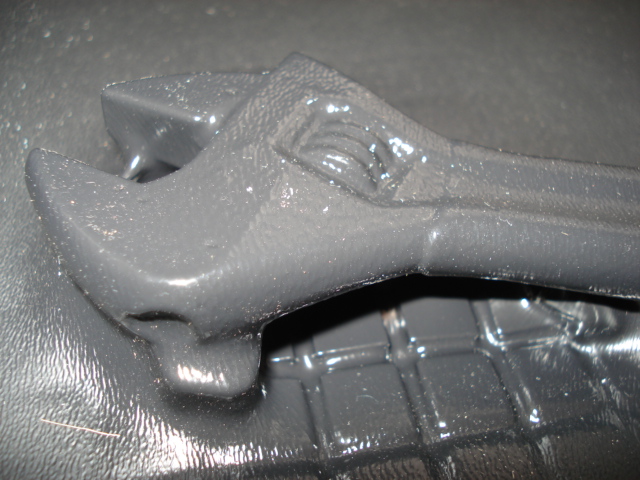

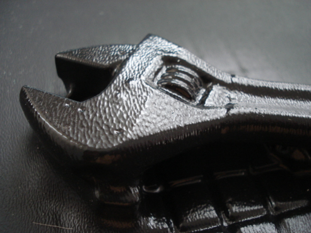

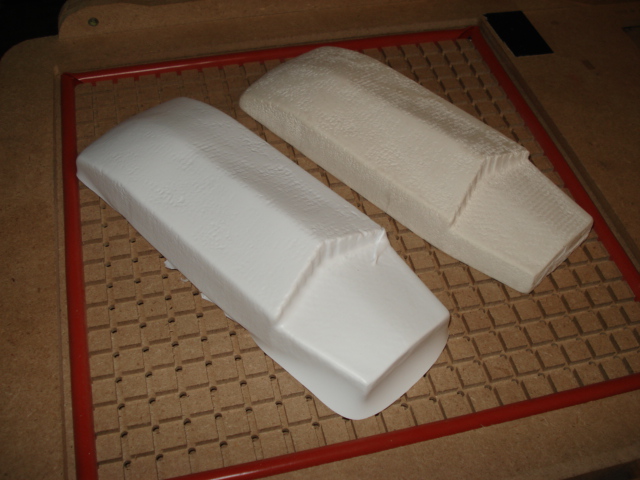

    After the last show where we used the heat gun and got the unsatisfactory results. We broke out the old toaster oven and it made a huge difference. Its seems that no matter how hard I tried with the heat gun I could not keep the whole sheet warm. But with the toast oven it did a great job and it looks like that would be the ticket. I still have more experimenting to do but its look better now :)
    I figured the toaster oven would do the trick. I have an old beat up toaster I use for getting bearings out of my glow engines. This way it doesn't stink up the main oven. My wife wouldn't appreciate that one lol. You can pick them up super cheap at thrift stores and garage sales.

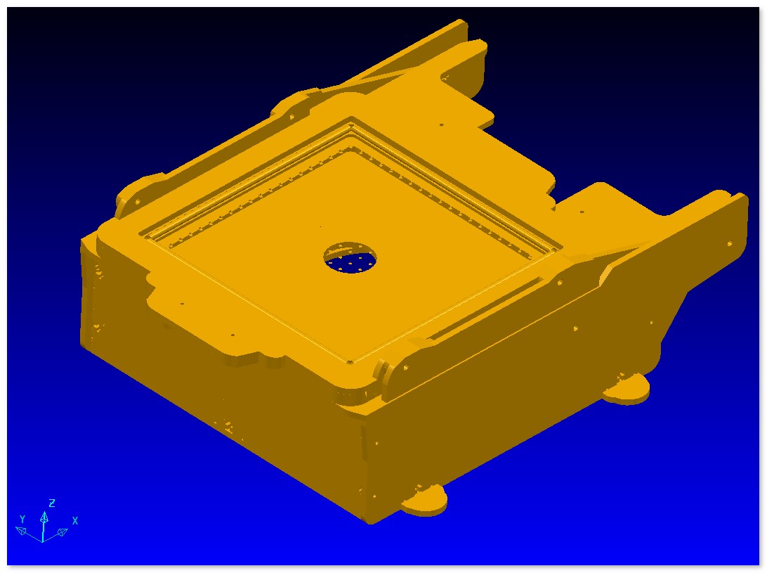

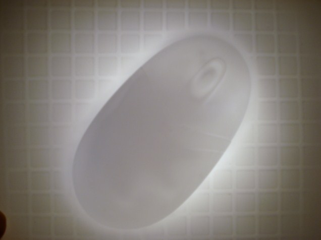

    Well guys, Just wanted to share a quick pic. I have been working on the Phlatformer as a complete redesign. I have tried many different Ideas which lead us to this one and will be ready (I hope) to try this prototype out on the Wed. live show. I have to say I am really looking forward to this one I think this will be the best one yet and I am really starting to like the look. The hinge system on this machine is set up like a four bar linkage pivot hinge, think tackle box.
    Hope you like it I know the pic is not that great but I really just wanted to let you know I have been working on it. :)
  17. 3DMON
    I was wondering if you were still working on it.
    I like it a lot!
    The hinge system looks a lot better, and I like the added tabs to hold it down.

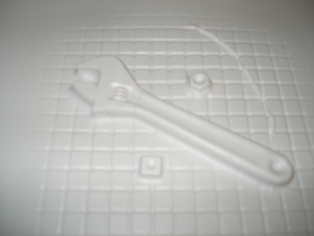

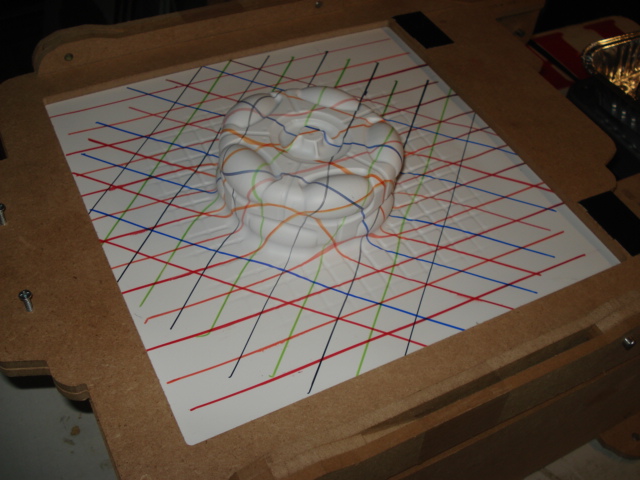

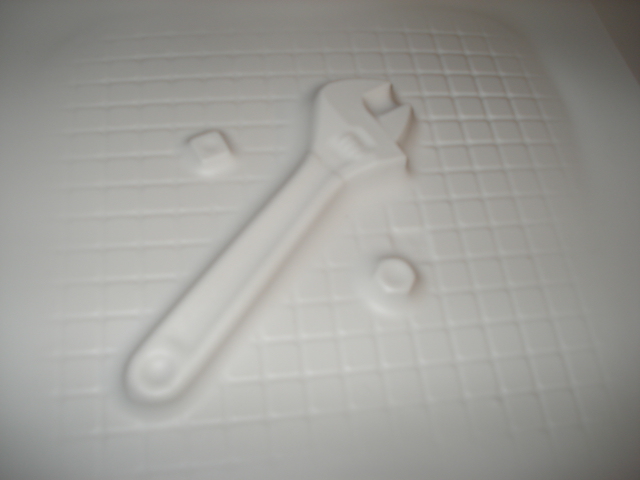

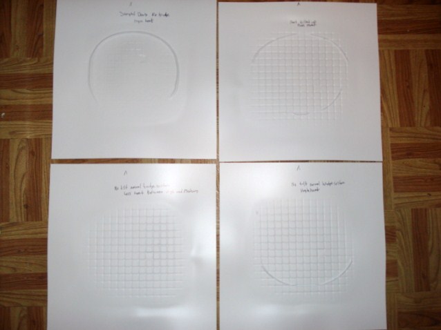

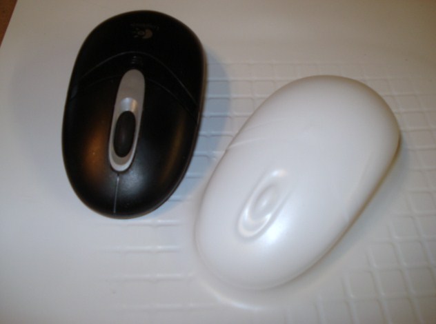

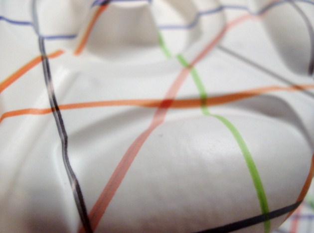

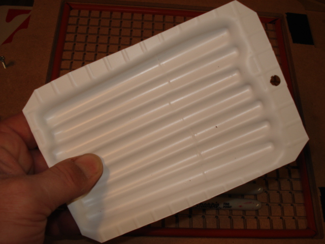

    I just got the plastic in for initial testing and so far so good. I have a few things to change in the design but it won't be long now.

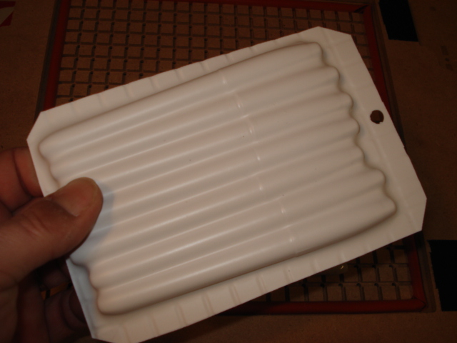

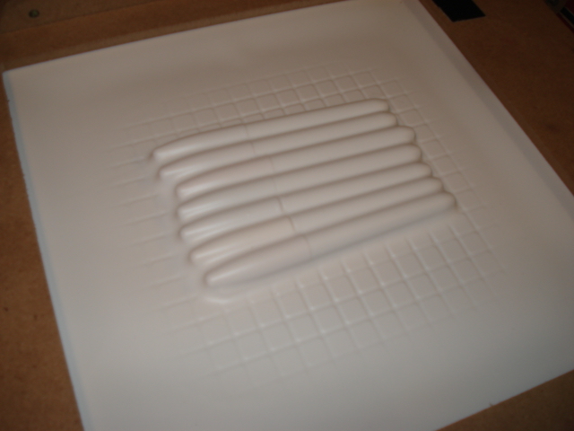

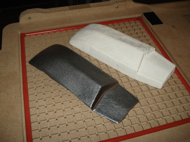

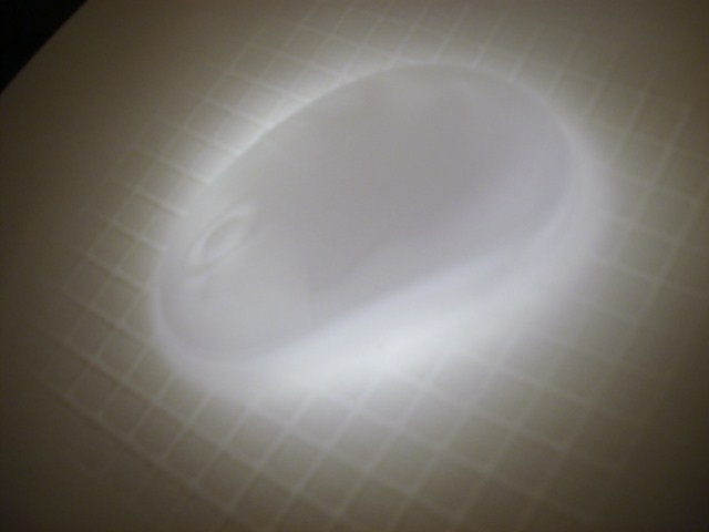

    Here are a couple teaser pics.

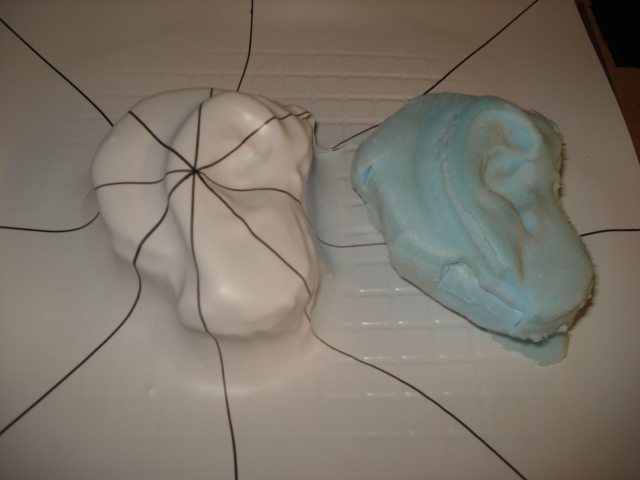

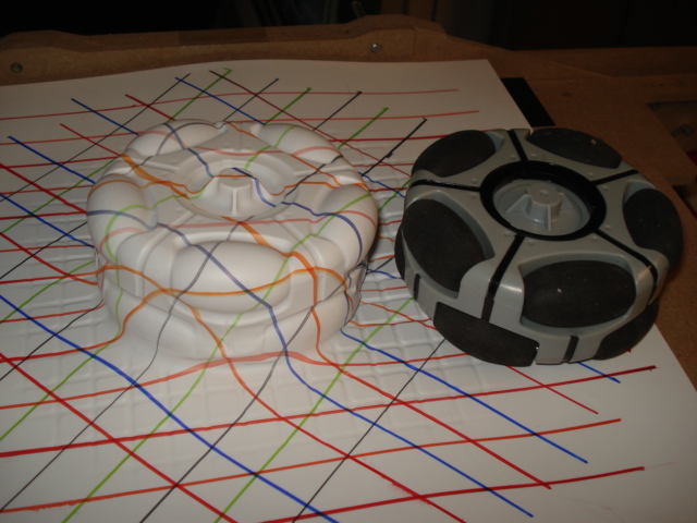

    Some of the pulls were good and some were not, the better ones were toward the end where I was getting the hang of the how much to heat the plastic. Its a learning experience for sure
