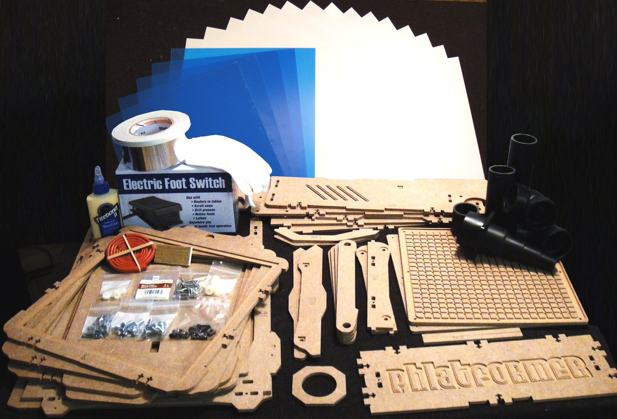

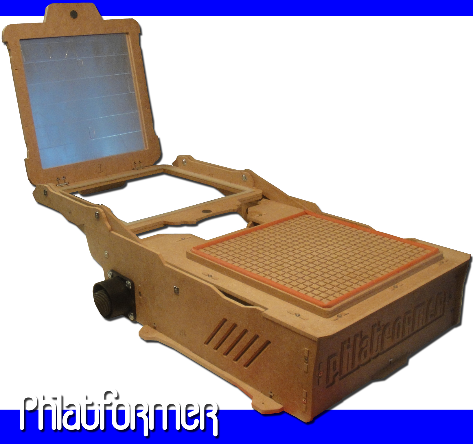

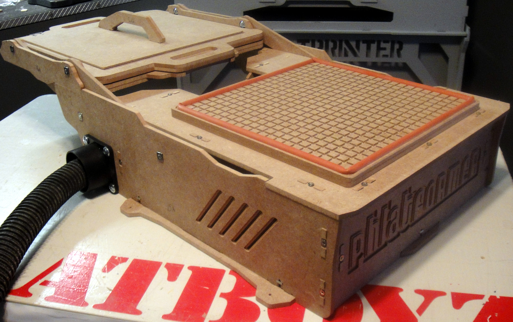

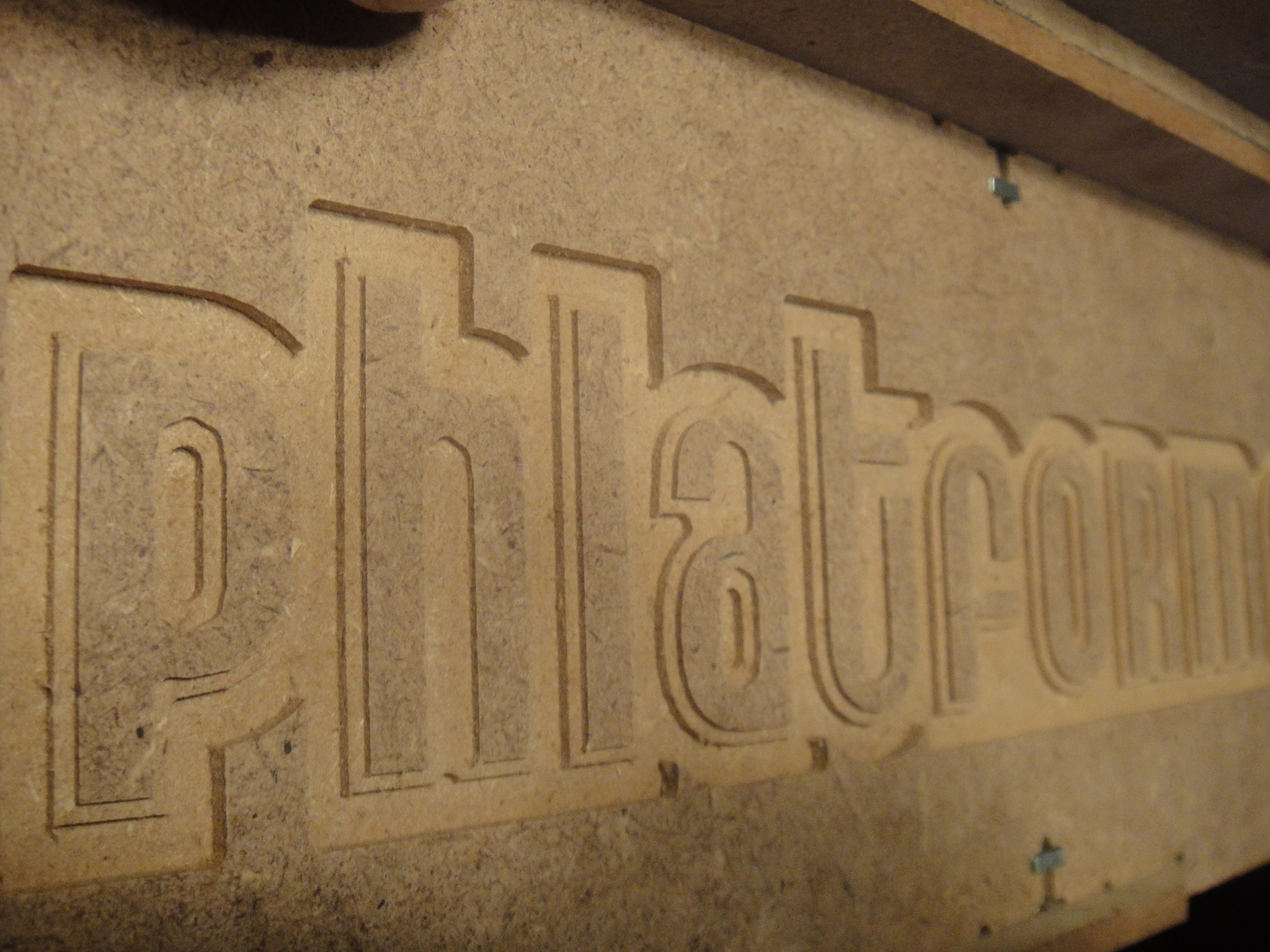

    Here are a few shots of the Phlatformer up close so you can get a better idea of the quality of this kit.

    Nobody should be able to complain about the quality job you have done with this kit and its contents. Excellent job of the machine parts and the kit is complete and nicely packed. I gotta give you two thumbs up on this one Mark and Trish!

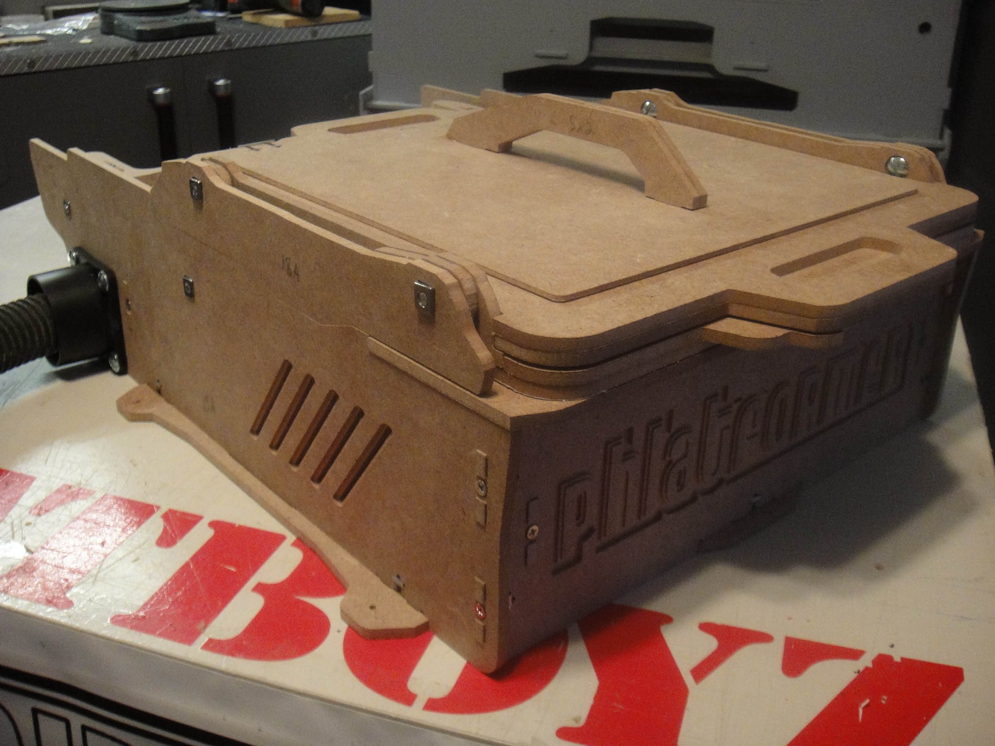

    George ( aka Thunder Hawk ) added the dual vacuum ports so we could do
    pulls with the shop vacuum attached on either side, just in case we had to do
    pulls at the table on the other side of the studio. Space is limited.
    [​IMG]
    Notice the vacuum port covers. More about those below. :cool:
    [​IMG]
    [​IMG]
    [​IMG]
    The port covers are "Shepherd Hardware Products" Model #9364
    caster cups for wooden floors. They are 2-3/8" I.D with a cup depth of 3/8".
    You can get them at Home Depot.
    [​IMG]

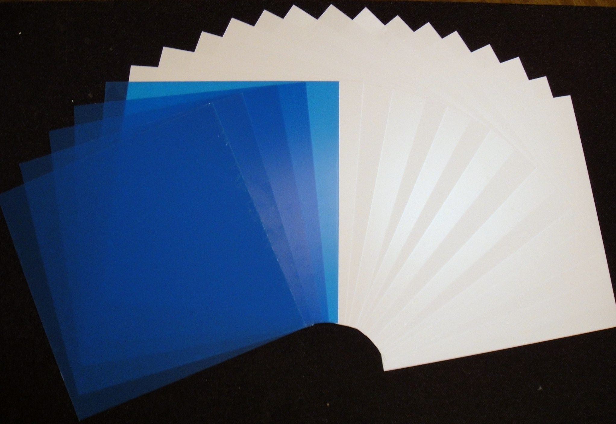

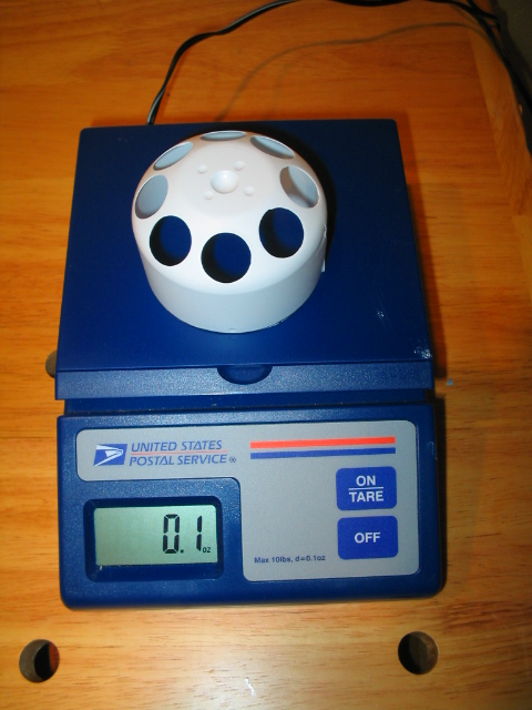

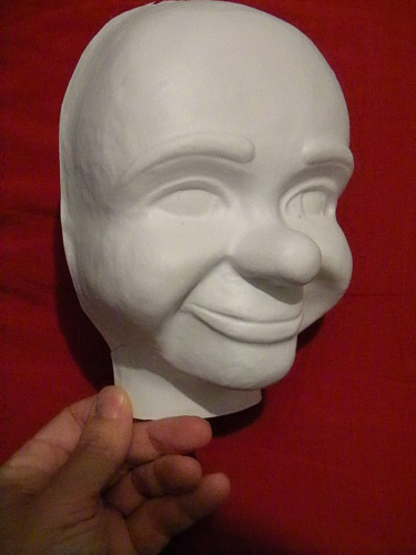

    George's first pull was of a Sullivans Narrow fuel tank.
    As you can see it was a very successful first try.
    You can see the letters that were molded on the tank.
    The Phlatformer captured every little detail even the seams on the tank. :shock:
    [​IMG]
    [​IMG]
    [​IMG]

  5. kram242
    :D AWESOME! :D I love the double port idea guys.
    Nice job, thank you for sharing.
    BTW how are you heating the plastic? We are using the Rival skillet from Walmart (20$) for ours.
    Edit: I see you have the skillet in one of the pics ;)
  6. thunder hawk
    thunder hawk Member
    287
    G.H. Boyd Systems, P.O. Box 235 Griffith, IN 46319
    Thank you Mark and Trish. You have one AWESOME vacuum former. :cool: :cool: :cool:
    We are using a Rival 11" square electric skillet. Very nice unit.
    Cost was $19.95 at Target. I almost bought 2 of them :p
    I had a good time right off the bat vacuum forming the fuel tank.
    I cut off the vacuum hose attachment 1/2" back on the second step away from the flange.
    Then taped the pipe on to each vacuum hose adapter. I have a large shop vac.
    Opening up the ports really helps when it comes to getting air out in a hurry.
    I found the caster cups to be a great way to close off the ports. They fit tight.
    For more info on the caster cups go to: http://www.shepherdhardware.com.
    Cheers.
    George

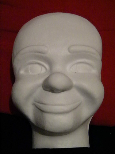

    Hey guyz. One of our Phlat Club Members, Mike P., shared these awesome pics of a project he is working on with his Phlatformer. Check it out...
    Attached files [​IMG] [​IMG] [​IMG]

    :cool: OUTSTANDING!!! :cool:
    GHB :doubleup:

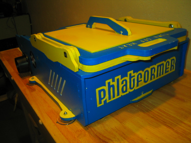

    Hey guyz. Check out EdwardG's Phlatformer. He just completed his build and has done an awesome job :doubleup:
  11. blindflight
    361
    CA
    Nice job EdwardG!!! I like the colors... :doubleup:

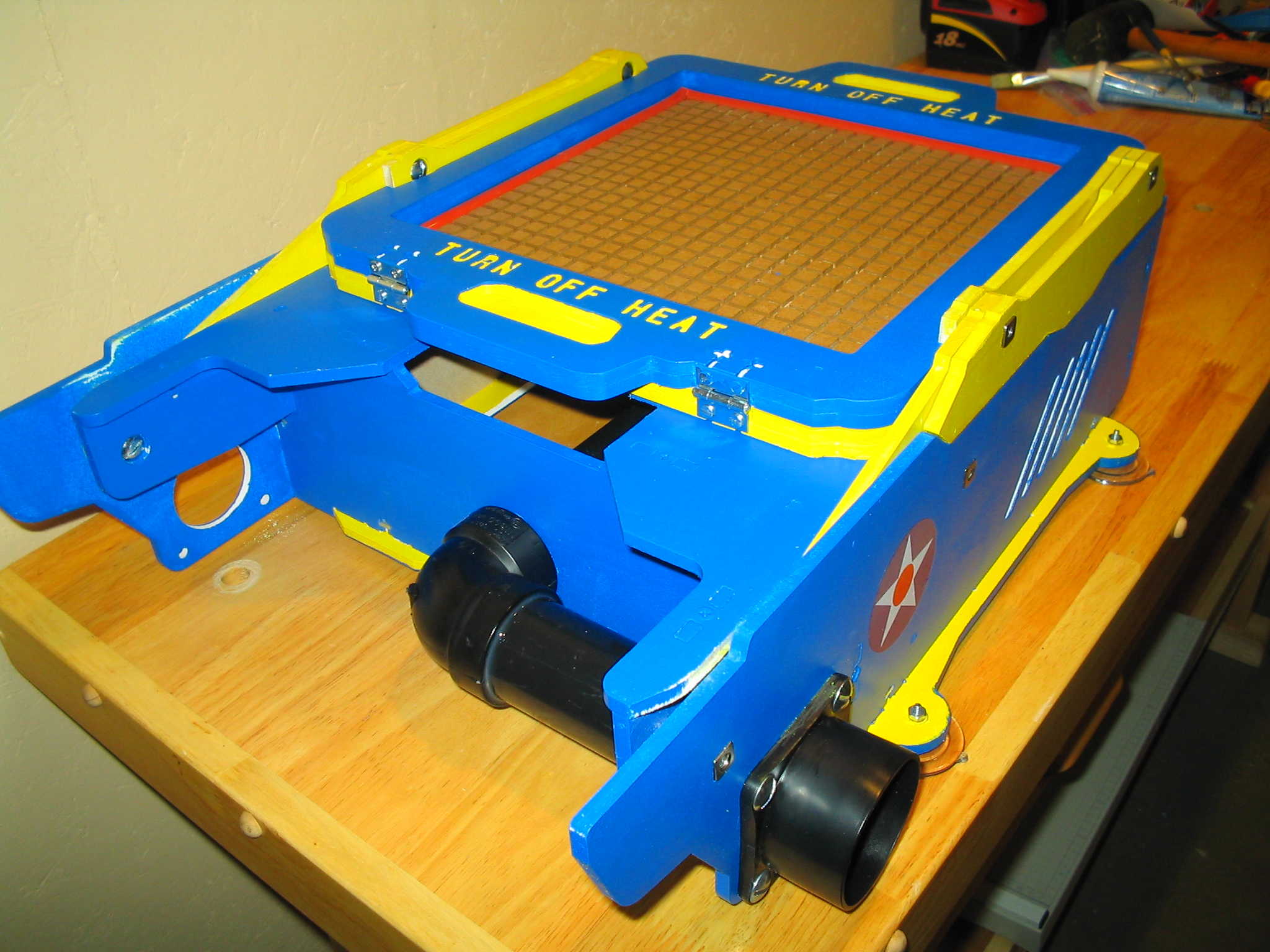

  12. EdwardG
    EdwardG New Member
    11

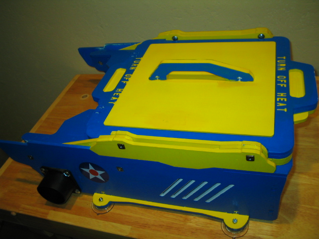

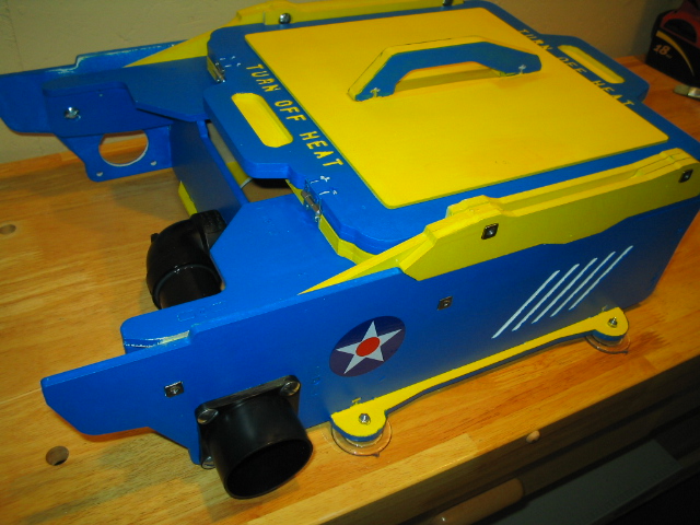

    More pics from my Phlatformer build

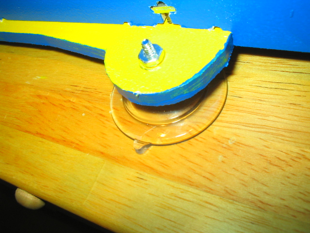

  13. 3DMON
    2,378
    Nice Edward! :good:
    I like the suction cup idea.
  14. thunder hawk
    thunder hawk Member
    287
    !!!Great paint job, and color scheme.!!!
    Bright & Happy colors. It has a Fisher-Price look to it. VERY COOL. :cool: :cool: :cool:
    Cheers.
    GHB :D

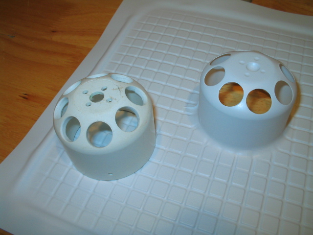

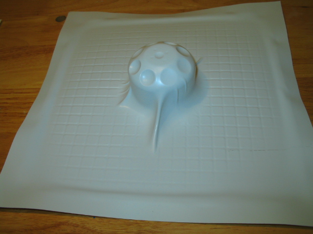

  15. EdwardG
    EdwardG New Member
    11

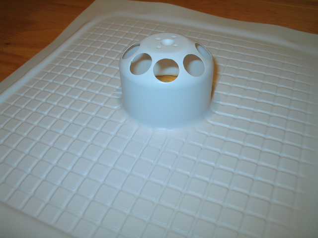

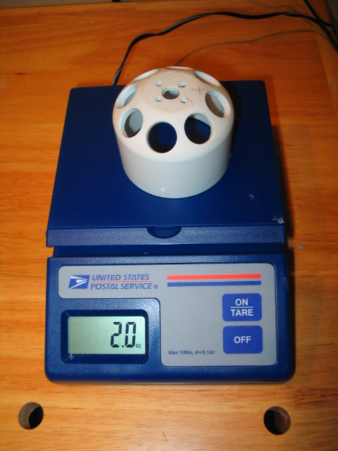

    Pics of my first pulls on my Phlatformer.
    Attached files [​IMG] [​IMG] [​IMG] [​IMG] [​IMG]
  16. kram242
    :doubleup: Wow that came out really nice! The holes you cut came out perfect. How did you cut them?
  17. EdwardG
    EdwardG New Member
    11
    Thanks guys.It does have a Fisher-Price look to it but I went with a WW2 military paint scheme used on the Stearman PT-17 trainers at that time.I will admit it does not look professional, but no one will see it but me and it works perfectly.The Phlatprinter will have a more industrial look to it with all of the safety wording attached to it when complete. ;)
