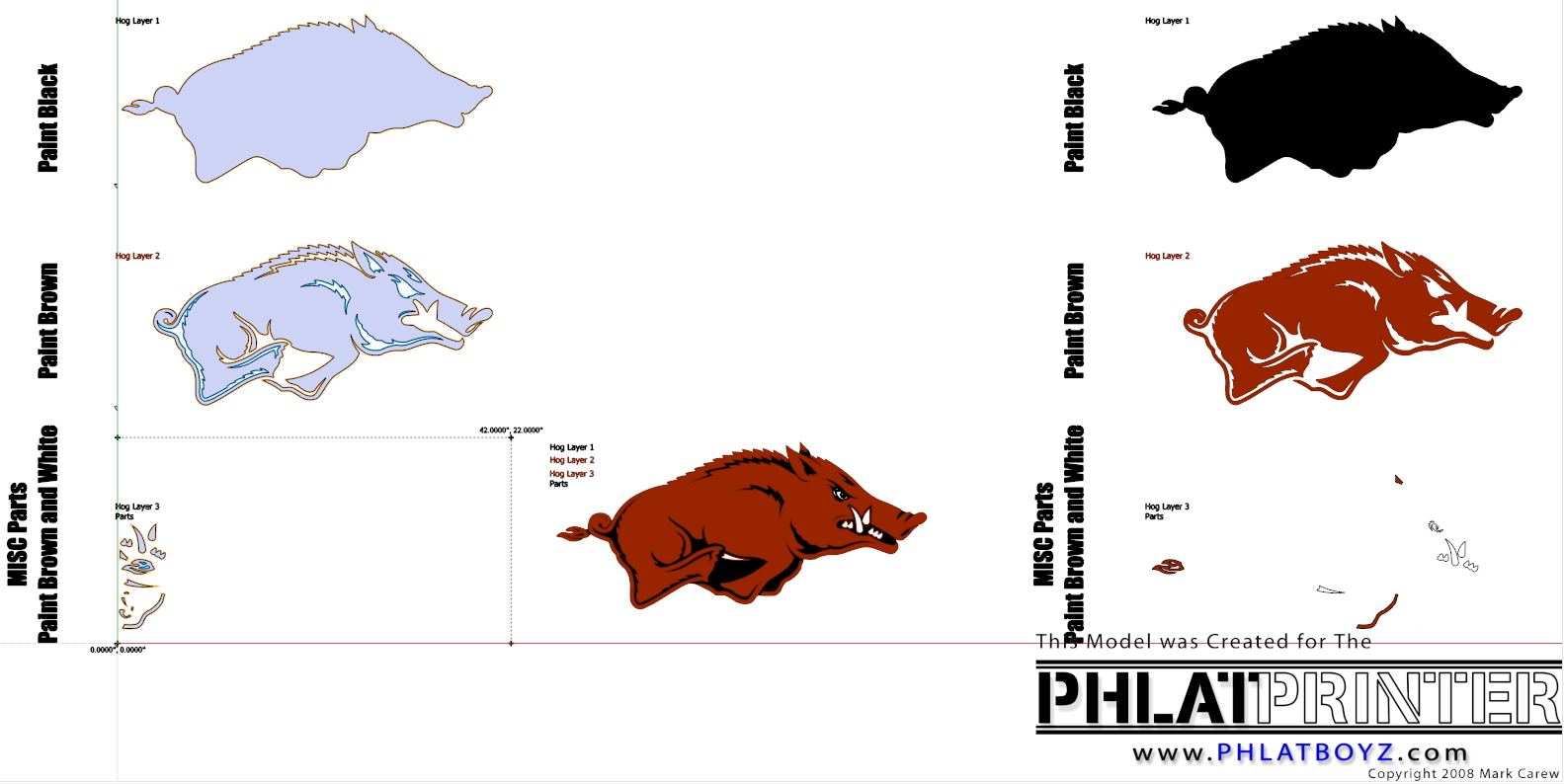

    The ARKANSAS Arkansas Razorbacks logo in layers for your shop! :good:
    You will need to use a carrier foam board for the cutouts as there is no tabbing. Just tape the two board together and use the same board for all three cutouts your parts should stick to the foam as shown in this tabless cutting video.
    Using the sketchup files as reference paint and glue the parts in place. Hang on the shop wall proudly! :banger:
    Enjoy
    Mark and Trish Attached files PhlatHOG.skp (3.6 MB)Â PhlatHog1.cnc (58.9 KB)Â PhlatHog2.cnc (205.8 KB)Â PhlatHog3.cnc (51.9 KB)Â [​IMG] [​IMG]
