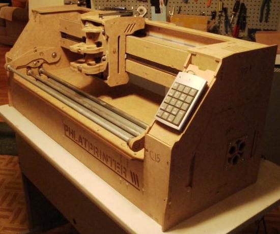

    Shaun that was the first concept for the logo and we did like it but it seemed a little to much like the quake logo so we back away :) We have since tried several different styles and this one just sticks, it reminds me of a arrow point :)
    Thanks so much for the suggestions and awesome words of support and encouragement from all you guys!
    Just curious, Mark, why is the hex rod better then round rod? Is it less costly?
    Hello Yoram,
    Actually the hex cost more because its bigger (the round rod was 1/4") and the shape of the hex rod itself makes it more expensive.
    Its worth it to use because the hex shape allows it to lock into place so that only the roller spins on the bearing and since it thicker its more of a straight axle. Coupled with the precision bearings its awesome! :) We have all different styles that we purchased for testing and this version is the best by far.
    Cool Mark,
    I didn't even think about it looking like Quake LOL. Looking at it more, I like it too.

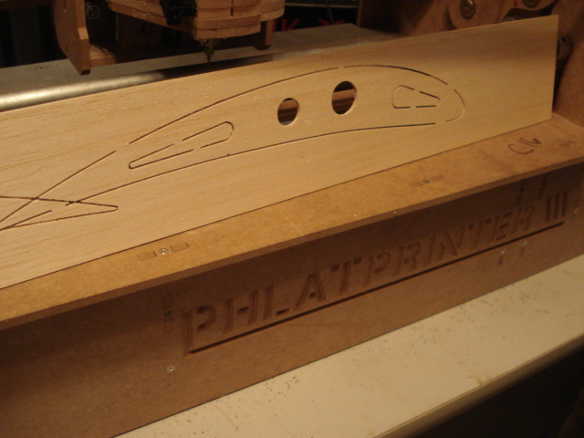

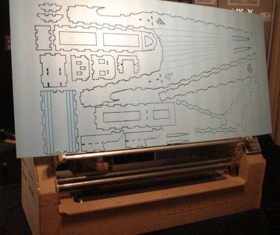

    More pictures :D
    Attached files [​IMG] [​IMG] [​IMG] [​IMG] [​IMG] [​IMG] [​IMG] [​IMG]
  12. jkarnacki
    jkarnacki Member
    140
    Good stuff guyz! The cut you did on the live show (even though the settings were wrong) was pretty cool. It's amazing how the bit can travel hundreds of inches and somehow end up at the exact same place (you mentioned this when it cut the fuse - you could not even tell where the cut started or ended). How does the machine know how far it's moving? Of course the computer is sending coordinates to the driver board, and the board to the motors, but how does it measure units? Do the motors literally have "steps" like servos do? That is, for example, 100 steps of the motor = 1 in bit movement.
