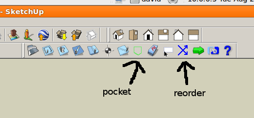

  9. swarfer
    swarfer Moderator Staff Member
    808
    Grahamstown, South Africa
    Just to tease you all..... seems my Phlatscript toolbar has a couple extra icons, as above.
    I do need to change the color on the pocket tool icon, the green looked so nice against black but that goes transparent, of course. I made the background on the group reorder button transparent too, much nicer, though I won't mind if someone makes some decent icons to fit the theme.
    A couple of things to tweak still on the pocket tool, but it does work. It uses the current bit diameter and the step-over percentage defined for the 3D cut, and of course you can change the depth for each cut. You can even change the step-over between pockets. The {shift} and {control} keys still work too so you can pocket complex shapes by doing the outline first, then subdivide that and zigzag each one seperately. I'll probably release the code tomorrow...

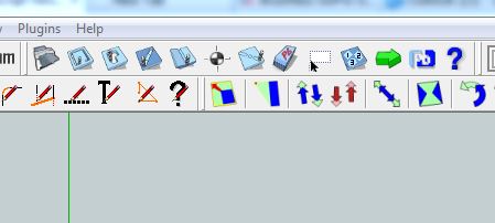

  10. 3DMON
    Hey Swarfer. Great job on the mods!
    I made another icon for the reorder groups. I would like some input before I try to make one for the pocket. Let me know if this would be good. I did my best to match the theme of the others.
  11. swarfer
    808
    oh wow that is NICE! that says 'reorder' so clearly.
    on the pocket icon, I searched the web and found some fancy ones that look like a patch pocket on jeans, which is the outline I was going for, I got the color wrong though :) but whatever you come up with will probably be better than that, so go for it.
    thanks a lot
  12. 3DMON
    I'm glad you like it. I'll try to work on the pocket icon later today.

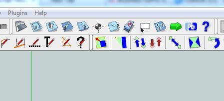

    Ok.
    I got a pocket icon made up. Let me know what you think.
  15. swarfer
    808
    delicious! installed....
  16. 3DMON
    Haha. Cool, I'm glad it works.

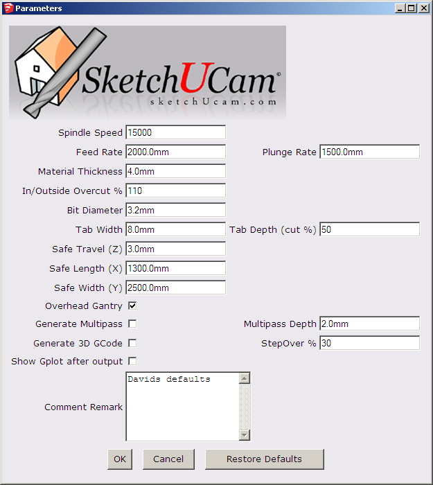

  21. swarfer
    808
    oh you guys are too nice.
    Teaser.... coming soon.....
    ToxicToast likes this.
  22. 3DMON
    Image isn't showing Swarfer.
  23. swarfer
    808
    tried again.....
  24. 3DMON
    Nice. I love the gplot integration!:good:
