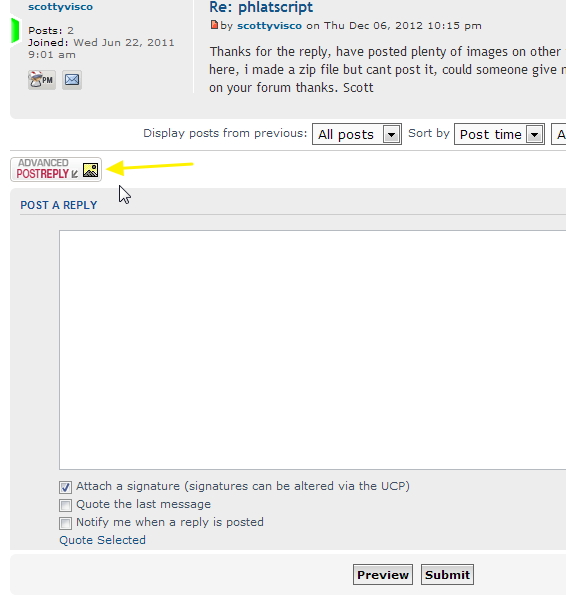

    Thanks for the reply, have posted plenty of images on other forums but cant seem to get it to work here, i made a zip file but cant post it, could someone give me a quick run through on how to attach on your forum thanks. Scott
    Hi Scott,
    You need to go to the advanced post reply to add files
