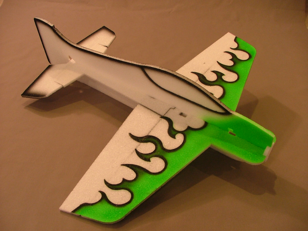

Last winter I worked up a variation of this plane in 9mm 1.3lb EPP. It's a 32" wing with carbon fuse bracing, larger control surfaces and I incorporated duel carbon wing spars. The spar configuration using one flat and one tube created a virtual I-Beam spar. I really like the strength of the wing using this configuration. Great for outdoor and indoor flying. I use this plane for mostly precision hovering practice. My flying buddy and I play pass the transmitter while the plane hovers in front of us at eye level. This plane hovers that well! Rolling circles are quite simple to work with this plane as well. We really like it a lot! Here are a couple of our backups we are getting ready for this years indoor season. Still need to add electronics and control rods. We have been busy flying helis and our big planes, need to get back to the foamies! Attached files

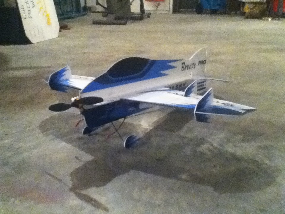

not yet, its made of dollar tree foam only because I was out of 3ml depron. I am hoping to fly it on the equipt. from a micro 4 site.

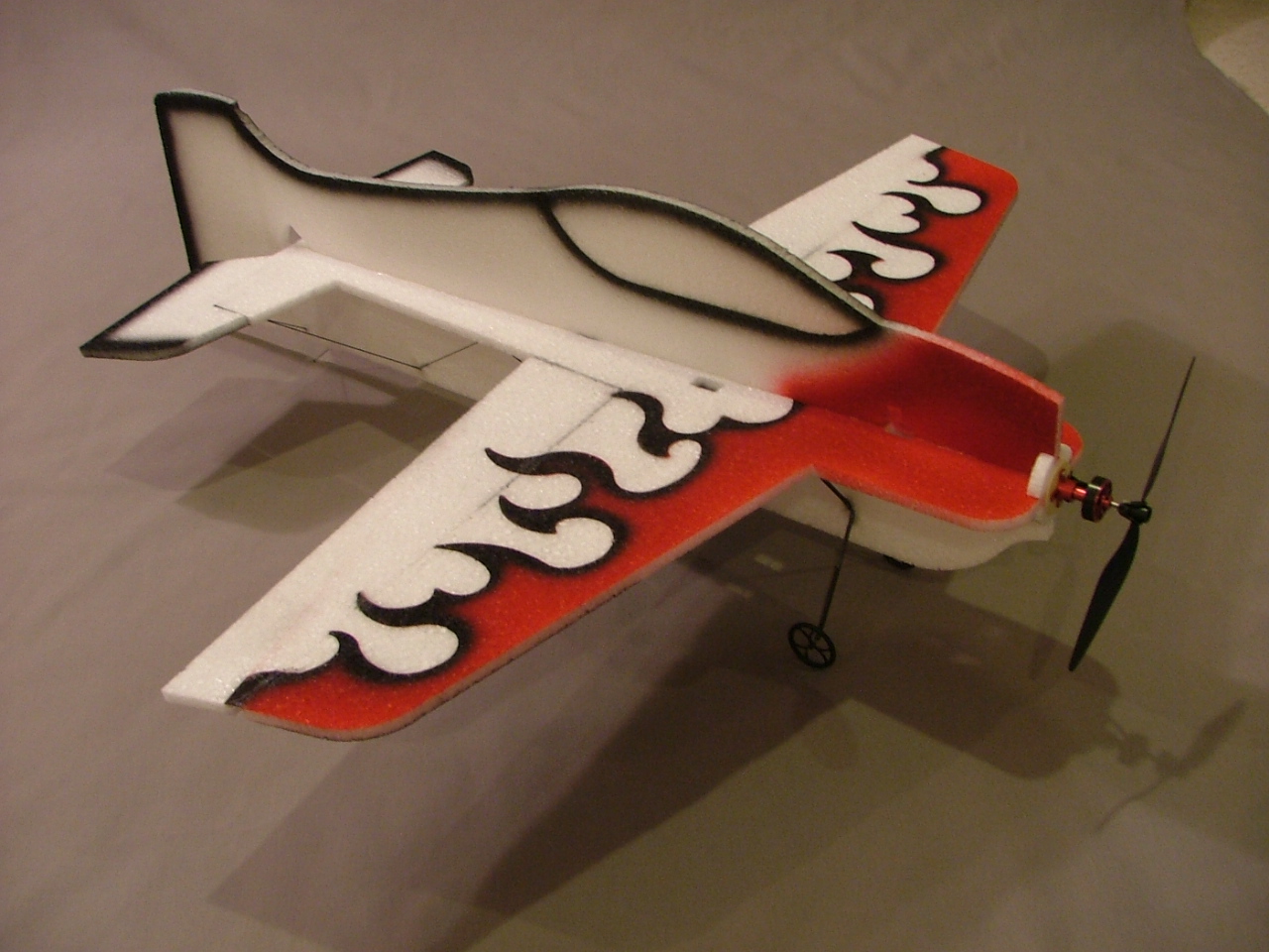

There's that Saran Wrap that is self stick. Sticks tenaciously and shrinks nicely with just a hint of heat from an iron . Don't go wild with the iron though as it will warp the structure.
It would be awesome if somebody came up with a sharpie pattern to draw those graphics on there. I have a ton of 9mm 1.3 epp.

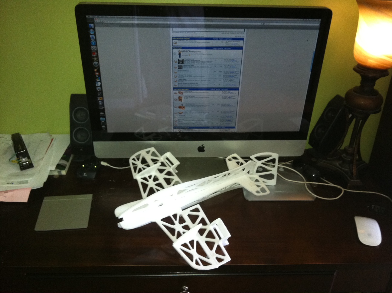

I cut one of these out today and it flys great. Now that my machine is cutting well I think ill work up a hollowed out version of this and maybe make some sharpie files for the top surface.

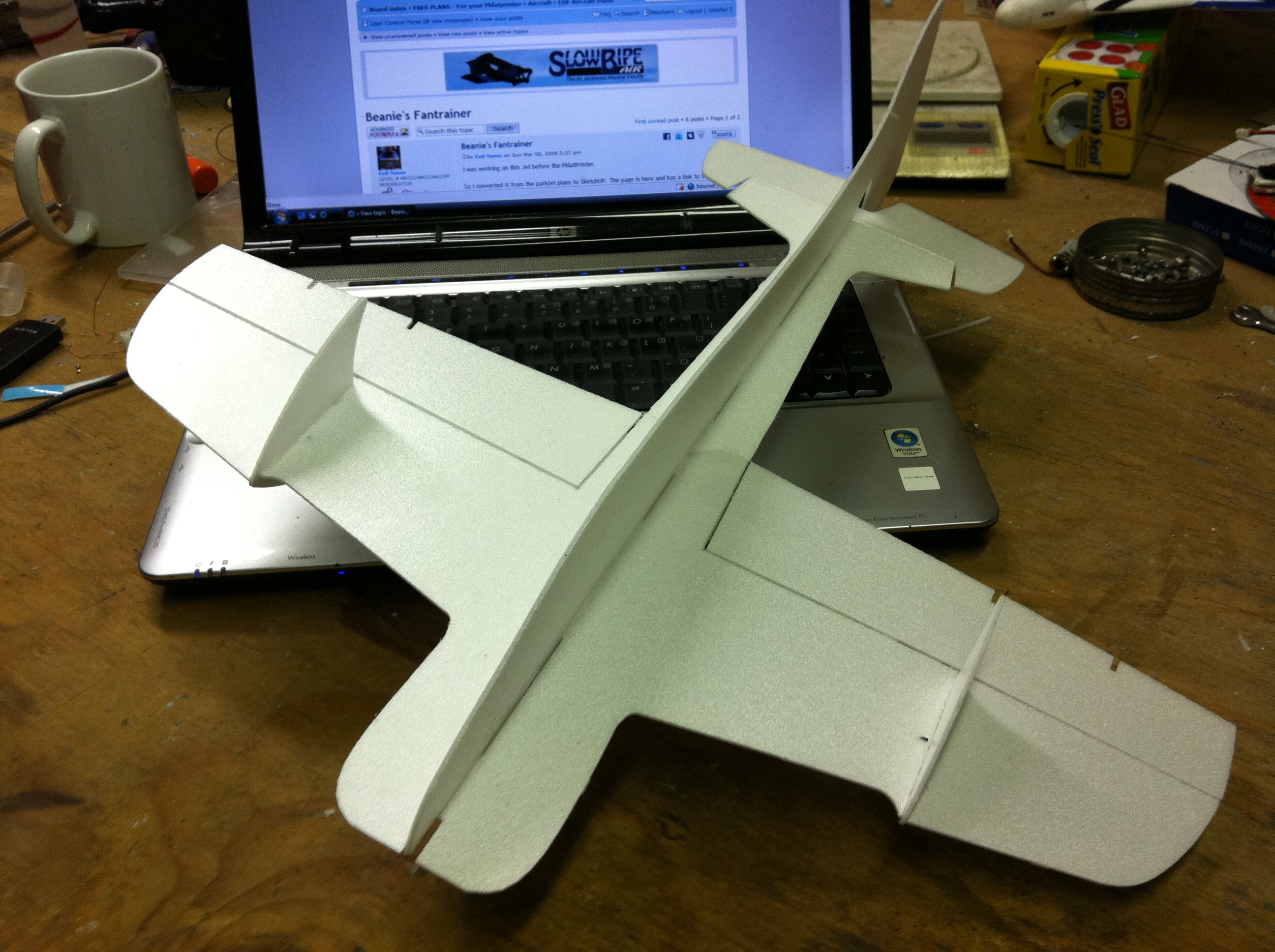

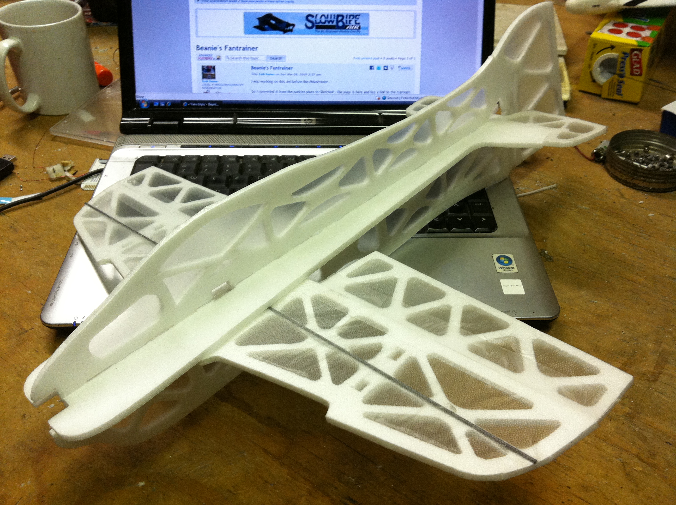

Heres another one I built, 2mm depron. Just have to add the gear.So far its about 1/4 ounce Attached files
Need to re-think this one. As it sits it weighs a porky 1oz Its covered with press and seal. Attached files
