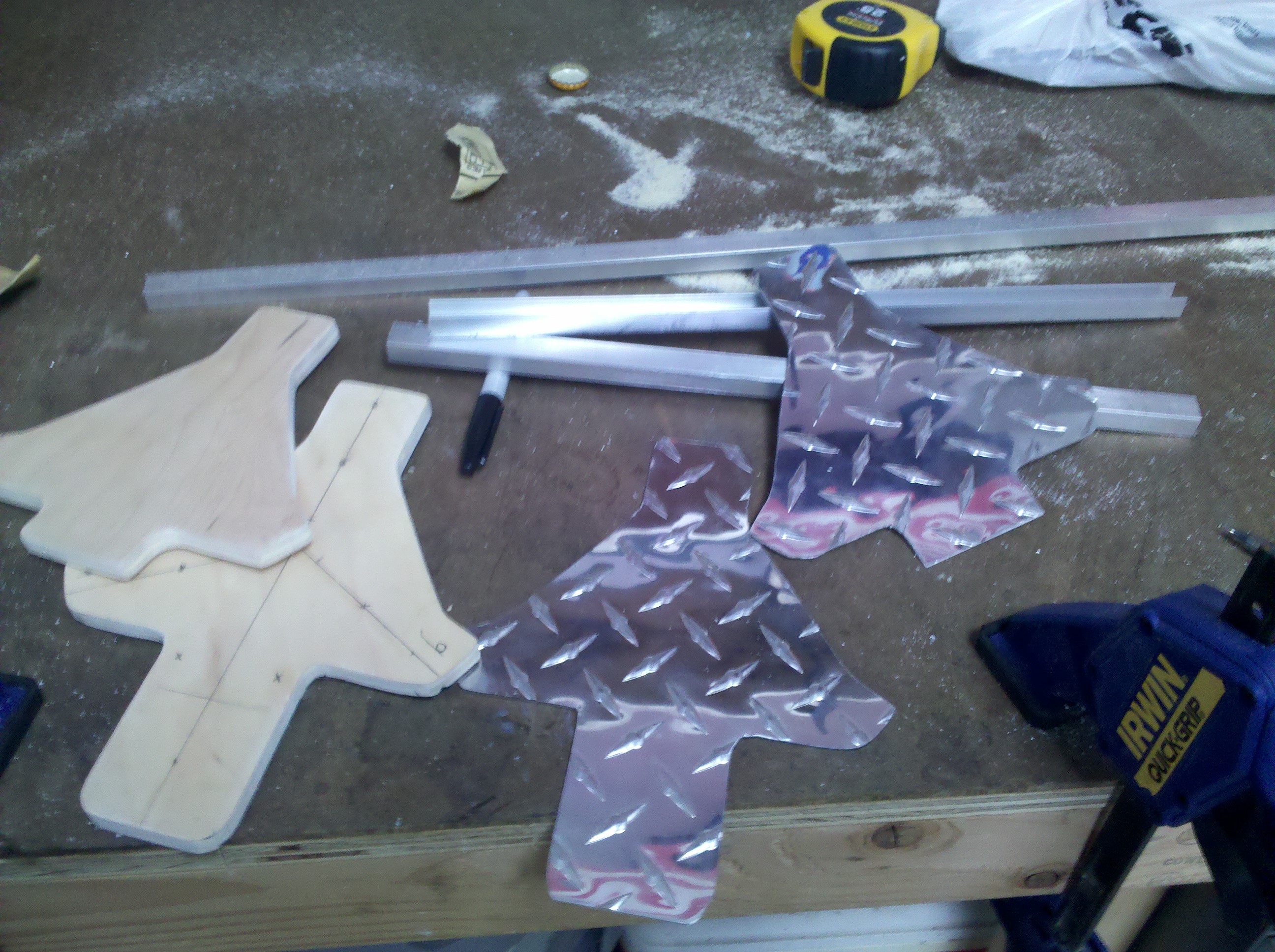

    I have been procrastinating for about a year now on building a Tricopter. I splurged and bought everything from rcexplorer.se electronic wise from Hobbyking. 45 days shipping is slow, but gives me plenty of time for the frame.
    I stole the plans from http://www.rcgroups.com/forums/showthread.php?t=1258649 boopido. The smaller of the 2 sections goes on top allowing room for a camera.
    I misread the plans for them and made the frame out of 1/2 ply instead of 1/4 in. It really isnt that heavy, but alot sturdier. I also had a sheet of aluminum that is real sturdy laying around so I cut it using the wood as a template.
    My question, I got it the aluminum looks alot better, what would you go w/? I will eventually FPV I heard the aluminum might mess w/ the signal? Vibrations carry through the metal easier than the wood I think. I did get some rubber washers to put on the screws that hold the arms on, will I still get vibrations? (I plan on balancing the motors and props).
    You can see the arms in the back of the picture. 1/4 U-shaped stock aluminum.
    Interested in what you guys think.
    Clay
    P.S. I need to buy a scale ! Attached files [​IMG]
  19. rjarois
    welcome clay....i would remake the frame plates from 1/4 thick ply. 1/2 is way to heavy...also the wood frame center will adsorb and have nicer qualities than the aluminum. randy.
    Welcome to the Phlatforum Clay! :D I love these quadcopters and soon you guys will have me sucked into this new branch of the hobby :D
    I agree with Randy on this one I think the 1/2 will be too heavy as well. If you want sturdy with out all the weight maybe some of that G10 circuit board material? or even PVC?
    Just my 2 cents :)

    1/16" G10 fiberglass sheet is hecka strong and stiff, and can easily be cut with good tin-snips and sanded to shape. I bought a few sheets from McMaster-Carr a couple years ago, but I prefer the thinner 1/32" stuff for control horns and kite panel templates.

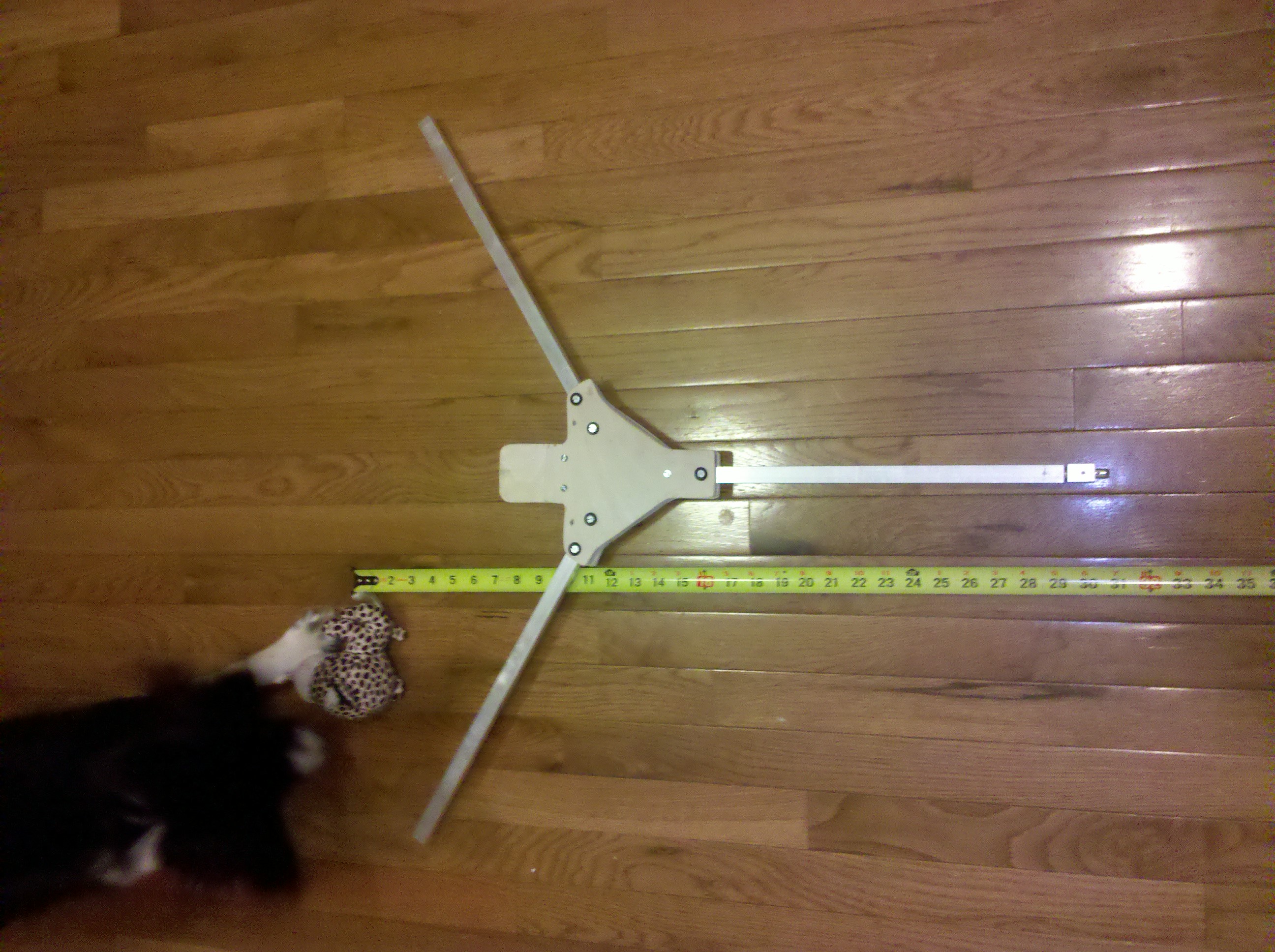

    I actually went to radio shack yesterday in hoping to buy some PC board, the sheets they had were just to small. I wish I thought of plastic. I just got done cutting out my 3rd and final frame out of 1/4 inch ply. It is very light and somewhat sturdy. I dont like how it chips when i run my drill press through it. But I am just sanding it down around the edges. The arms are drilled and the yaw control is being epoxyed as we speak. Again I think I went to heavy and used 2x brass bushings and a large pin. It has zero slop, rides on rails, but feels as heavy as all 3 arms put together. I am usually pretty handy DIYing everything around the house, but I am used to working with projects that do not concentrate on weight so much.
    Thanks for the input, I will upload a picture of the frame all bolted together possibly tonight. I dont think the arms are long enough either. It is hard to measure other tripcopter arms in photographs.
    Clay
    edit : The arms are 16 1/2 in on center

    Heres the frame all together. I dont know how much it weighs but im scared. Hobbyking says all of my parts are in the pacific somewhere.
