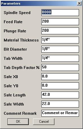

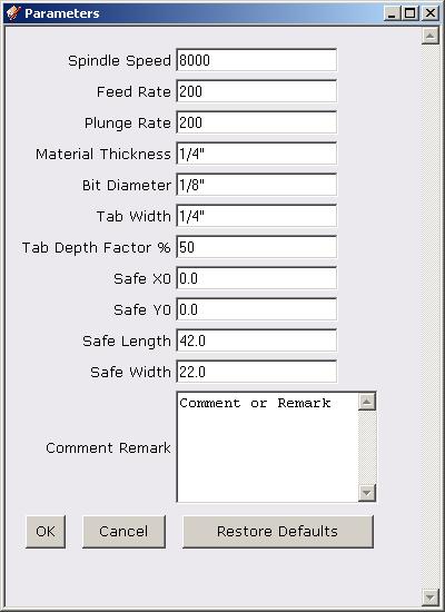

    To fix the empty parameters dialog on linux it has to be moved to a Sketchup input dialog vs the SU webdialog. The gecko window under wine that Sketchup shows for the 'webdialog' call doesn't respond to the skp protocol so there is no opportunity for bidirectional communication. I think this is a deficiency in gecko and the javascript engine. It has nothing to do with a bug in phlatscript.
    I don't know if this is going to be a problem for windows folks but it is really just a cosmetic change. I think this change should be made but it could also be an option in the constants.rb file. What do you guys think?
    The look would change from this:
    to this:
    tvcasualty, a.k.a beta tester, I am sending you a PM now. Attached files [​IMG] [​IMG]
