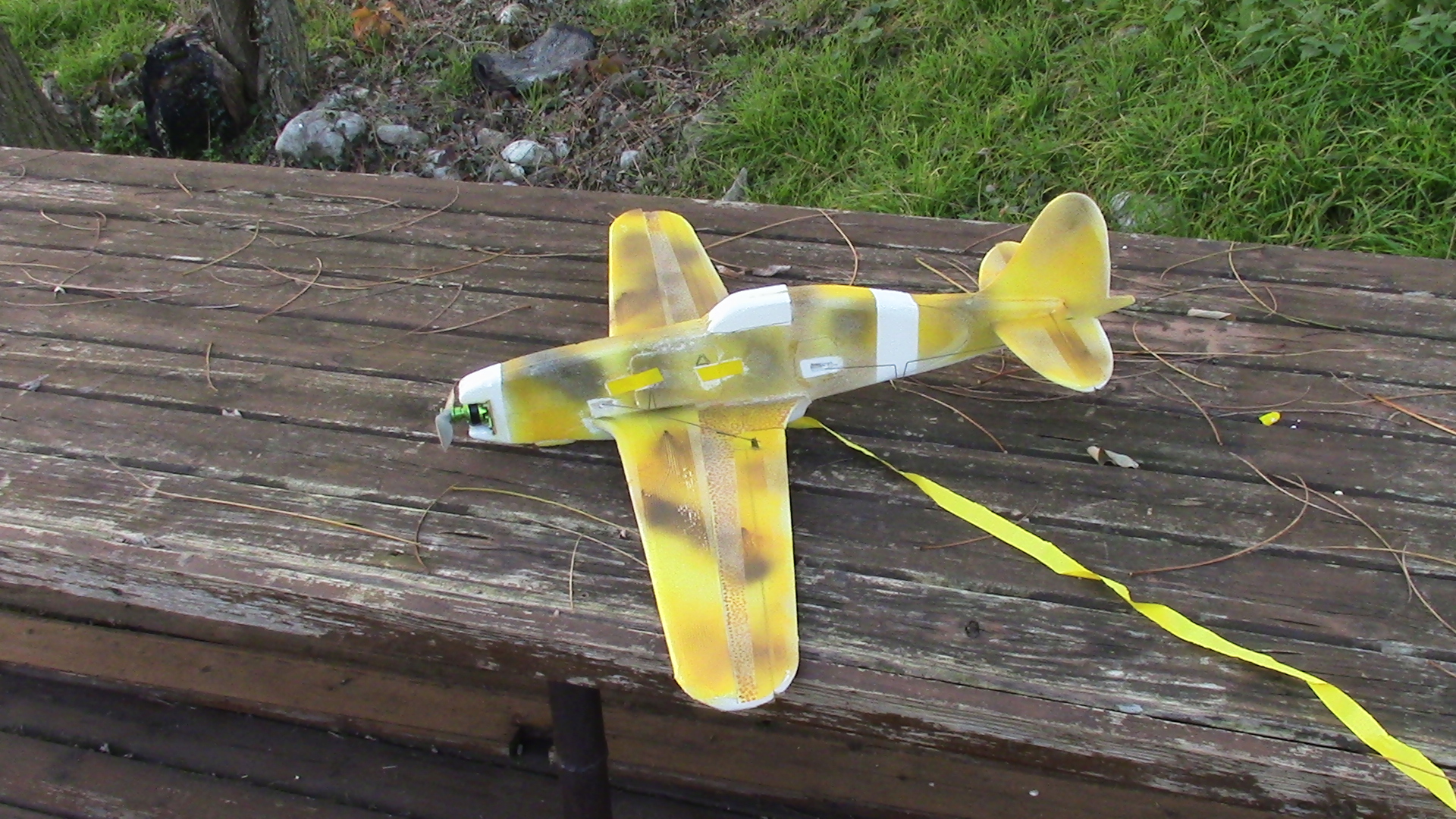

    Hi Ken, really thanks for posting the plans,
    I have seen the macchi was missing from your gallery, so here is mine. It flies on rails and rock solid even without spar.
    Enough easy to cut even with a mkI
    Carlo

  25. actaline
    actaline New Member
    21
    macchi 202 of the vlf series, I have cutted it from depron sheets so there isn't my single skp due to different size
    I have laminated the fuse and wing with liquid polyurethane glue D4 and water drops as accelerator
