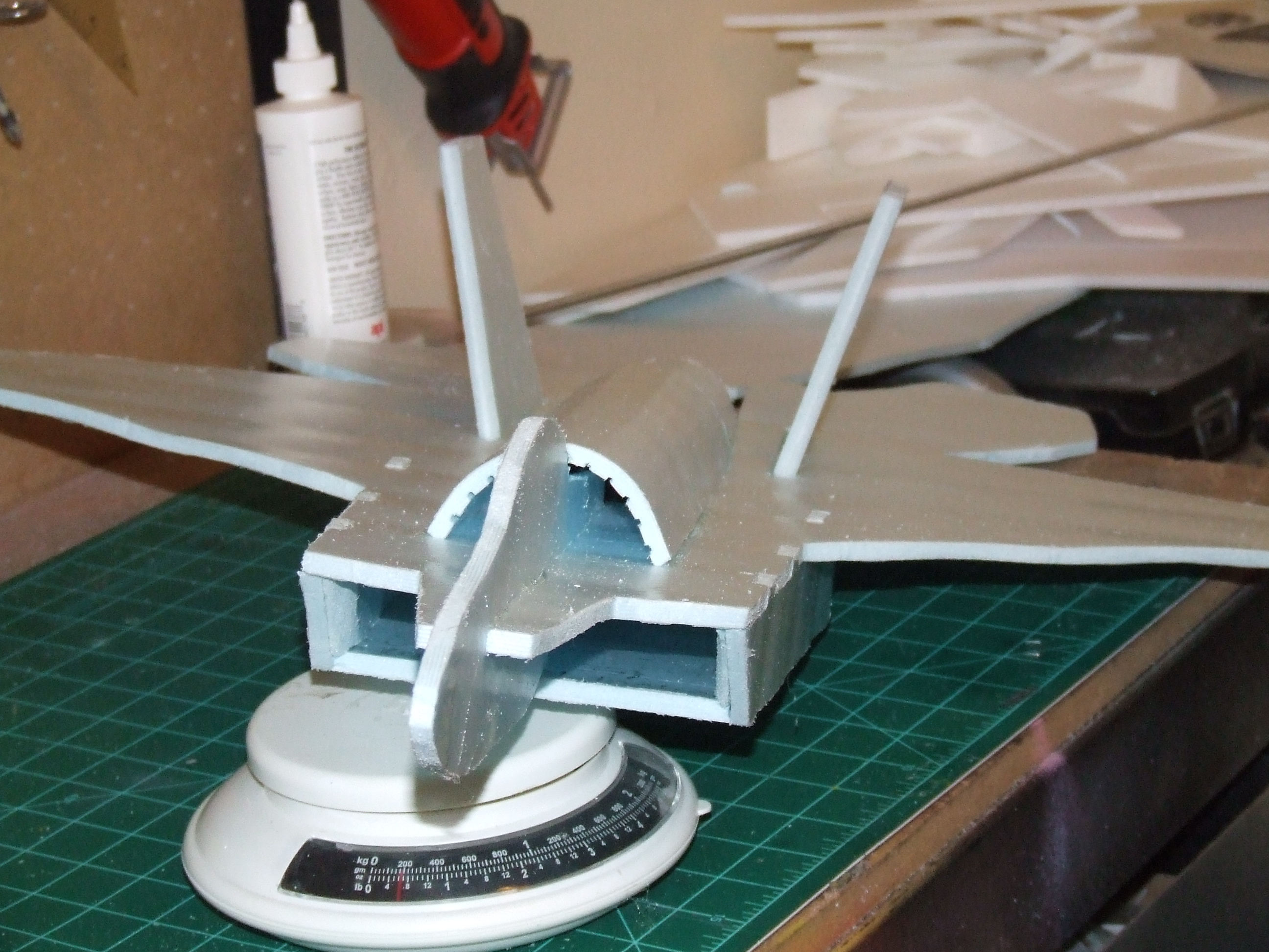

Maiden went pretty good after the winds died last night :roll: I found some changes that needed made and am in the process of cutting a new one out, man i really need that upgrade :evil: I had to move the EDF unit forward for CG issues and will re-maiden hopefully tonight if i can get it done in time. Power seemed decent, top speed could be better though. Attached files

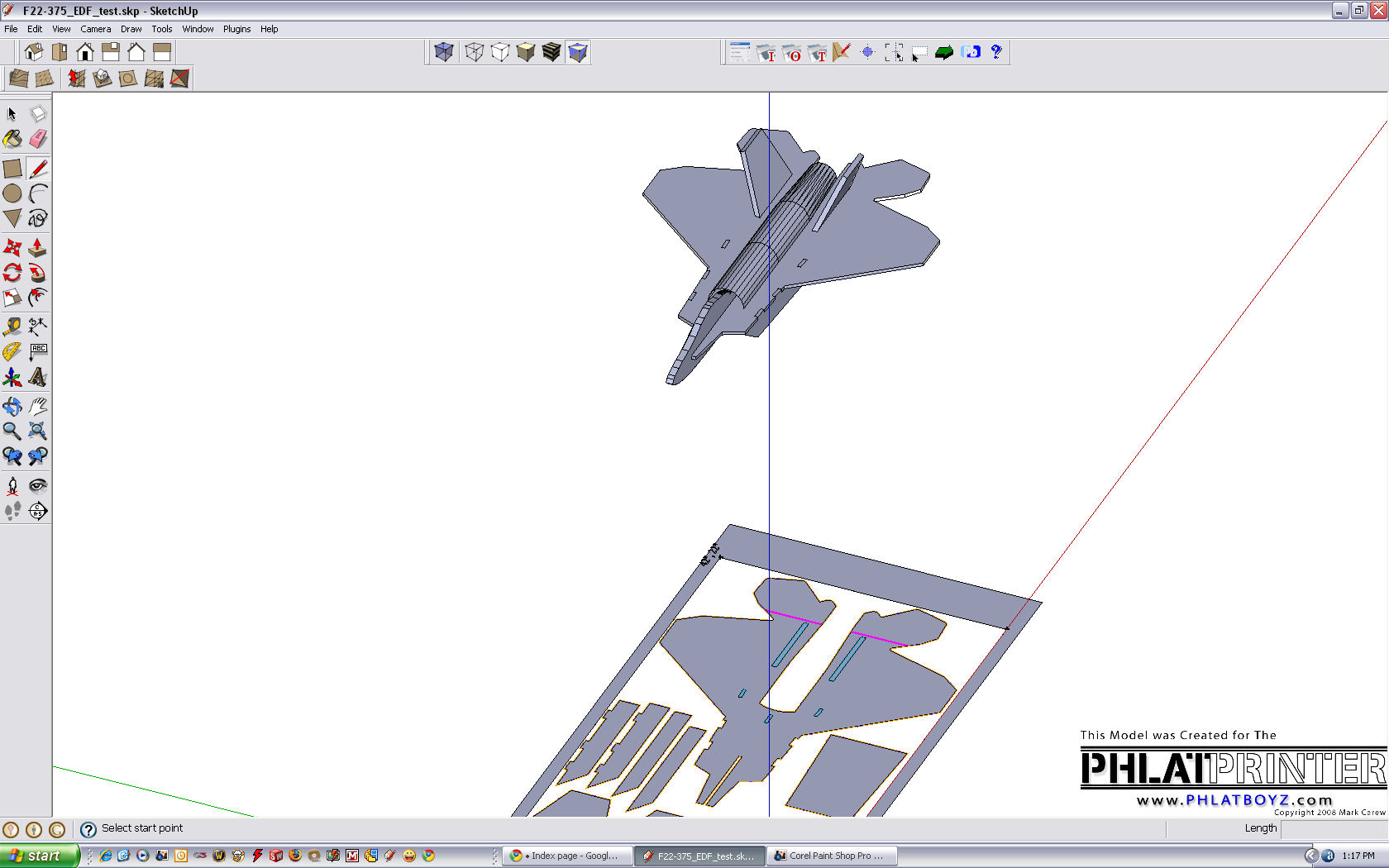

Ok, I am pretty confident about the way this thing will fly now, I will post the files and once I work out the CG hopefully on Wednesday evening I will post best CG location. It is designed for 56mm fan unit (2.25 inches). I used a turnigy 4400kv motor with it. I also used a 1350 zippy 25C lipo, should be using at least an 1800 25C 3S pack. http://www.hobbycity.com/hobbycity/stor ... oduct=4198 Attached files F-22-EDF.rar (426.4 KB)Â
Jnida63, Glad to hear you got the parts Man this one came out cool looking bro! Are you thinking of doing a video for us guys to see it in action? Thanks for sharing this with everyone here Mark
