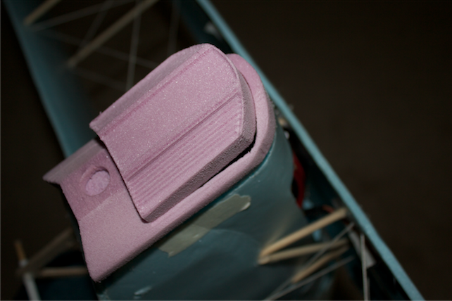

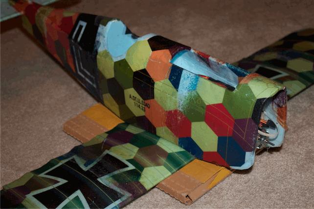

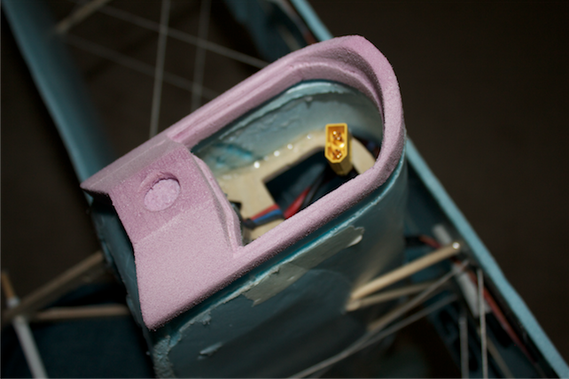

    To be more specific, this are the foam molds on the way of making first plastic parts.
    The big part will be glued on the nose of the plane, but the small one will be detachable to allow access and airflow to the battery and electronics.
    So depending on the stiffness of the nose "frame" I'll have to chose... I can also leave it is from plastic, paint the mesh on it and have the top open around the "engine" for air flow...
    What do you think? Attached files [​IMG] [​IMG]

    It will definitely look better painted and mashed, Watt_the?, don't leave it off!

    That's the plan... and this will be my first attest to a hex camouflage.

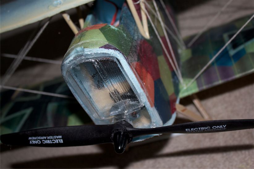

    I had it for tonight... the rest tomorrow...
    In the same time... the new kid on the block... is getting ready :D Attached files [​IMG] [​IMG]

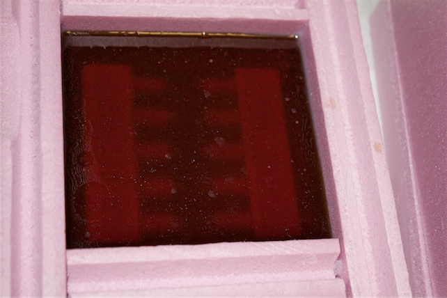

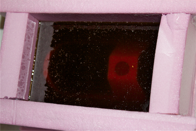

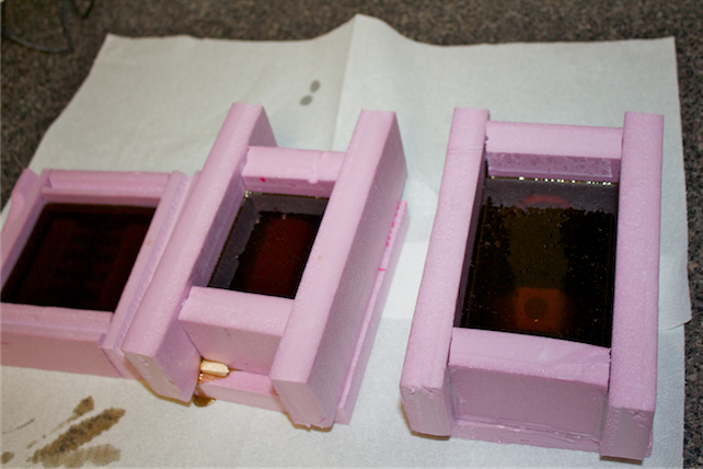

    Waiting for the silicon rubber to become solid... "Motor" and engine cowl...
    And... The foil I use to cover the plane is see-throw ( actually I had no idea that is transparent foil because the paper support is white...) so is not what I'm looking for as a result. I have to paint the plane solid white to take advantage of the see-throw factor. Attached files [​IMG] [​IMG] [​IMG] [​IMG]

    The "motor" is to much for this plane, I'll have one from foam because when the top wing is in place you are able to se only 1/4 of it... so the weight is not justified. The nose is in place, it open for the battery access and will be just painted to resemble a grill. Underneath the cowl will be air scoops for venting.
