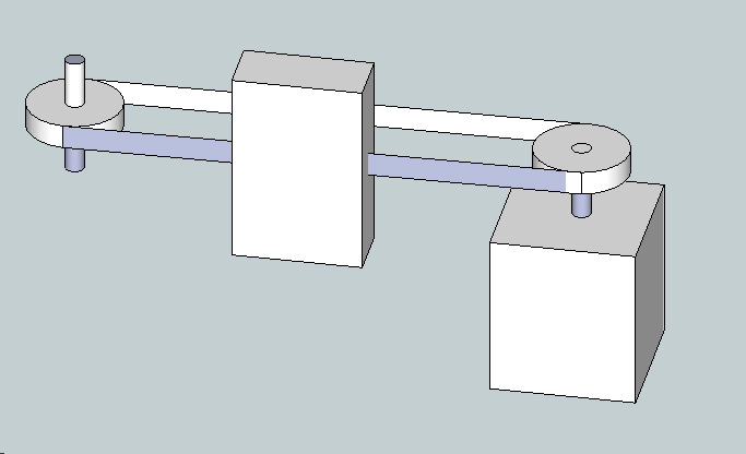

    I need to understand:
    I am associating the belt system in the MK2 as a bike gears/chains:
    - you can go faster if you convert torque to speed (big front, small back)
    -you can climb steeper if you convert speed to torque (small front, big back)
    here, we see the Dremel moving at incredible speeds, and not missing any step. how is this possible?
    I don't doubt the video, they must be legit, I just don't understand how it works...
    The original steppers are puny, and can only deliver so much energy.
    Even an unclear all thread can make them miss steps. and here we have the same steppers cutting 1/2 inch balsa at speeds the MK1 can never even dream of, even with better steppers and increase amps
    Am I missing something. Are there any documentation of this belt system?

  8. Flashsolutions
    I don't know the details of the MKII as yet, but if we assume that it uses a large gear on the stepper motor and a small gear on the all thread shaft, I think it is explainable.
    For example, In order to turn the all thread 1 revoultion with a direct drive system, lets say you would have to apply 8 steps.
    If we instead apply a large gear to the shaft of the stepper motor and a small pully on the shaft of the all threaded rod, those same 8 steps could turn the all thread 10 times for each revolution of the stepper (depending on the gear ratio).
    Stepper motors produce more holding power and torque at lower RPM's. As the number of steps increase, the holding power of the magnets decreases. Slower speed translates to more torque.
    Having a large gear on the stepper drive a small pulley would allow the all thread shaft to turn more revoulutions thereby giving you more speed. At the same time, you get the added benefit of more torque because the stepper motor magnets work best at slower speeds, unlike in the bike example you mentioned.
    The down side to this is that you would loose some resolution. 1 step would result in a movement of say 10mm with the gear system versus 1 step of movement producing just 1 mm of distance with direct drive (assuming 1 revolution of the all thread moves the material 1 mm).
    Again, I don't know if this is how the MKII is setup since we have not seen any video of the actual steppers as yet.

    Thanks for the tip Dennis, i've never tried that before. I must admit that I don't build many Depron models, but I cut some kits for a friend of mine and his one criticism were the 'pit' marks all over the foam.
    Flash, i'm not 100% certain, but I imagine that there's no threaded rods on the MK2. I imagine the belt drive is similar to the carriage on an inkjet printer. Maybe Mark can confirm?
    Si.
    Instead of using the belt to drive the allthread, you can get rid of the allthread alltogether. I'm pretty sure this is what Mark has done. You can use 2 pulleys one on the stepper and one on the other end, then attach the belt to the gantry. This will make it so the pulley diameter dictates the amount of travel per step.
    Which makes me ask...
    Mark what is the outside diameter of the pulleys? Attached files [​IMG]
  11. Flashsolutions
    Ahhhh! Interesting. Can't wait to see more pics of the MKII.

    i think that printer like idea would create a lot of play .... i might be wrong
  14. janbjorn
    janbjorn Member
    130
    Sweden
    If you make the pulley in the oposit end from the stepper spring loaded, I think that there won't be any play. The print heads of an inkjet printer works that way. Mark, could you give us a hint? Please?

    Look inside any bubblejet or inkjet printer and you will see that they are belt driven. They are some of the most accurate pieces of equipment around. I think Mark is on the right track using belts rather than all-thread.

    yes, inkjet printers use belts, but on the other hand, they are not having to fight forces generated by the material they are cutting

  22. rjarois
    you guys are talking about cutting forces, moving gantry mass weight??......the phlatprinter has really nothing like this going on....i have run belt driven cnc equipment that the z-axis head weighs more than a car...talk about cutting forces?? try burying a 6in. dia. shell mill tool .500 depth of cut in a piece of high grade CPM-9V tool steel on one pass..... ok, one more time....ther is nothing wrong with belt driven linear assemblies. its widely accepted standard on alot of cnc equipment in the industry use them. randy.
