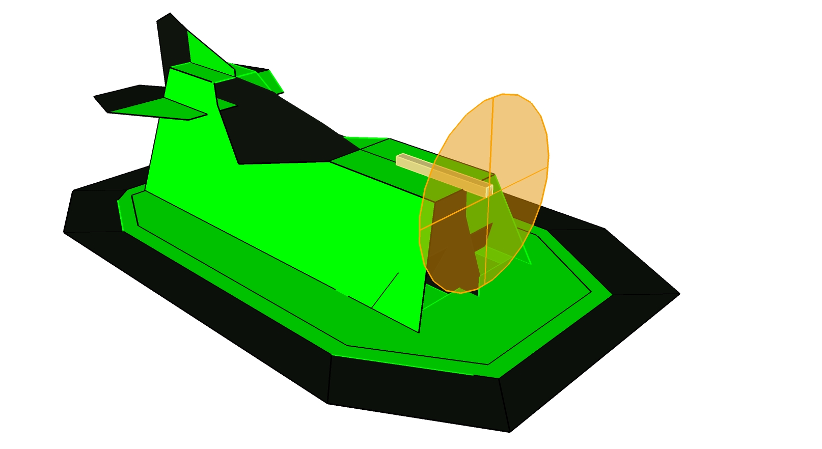

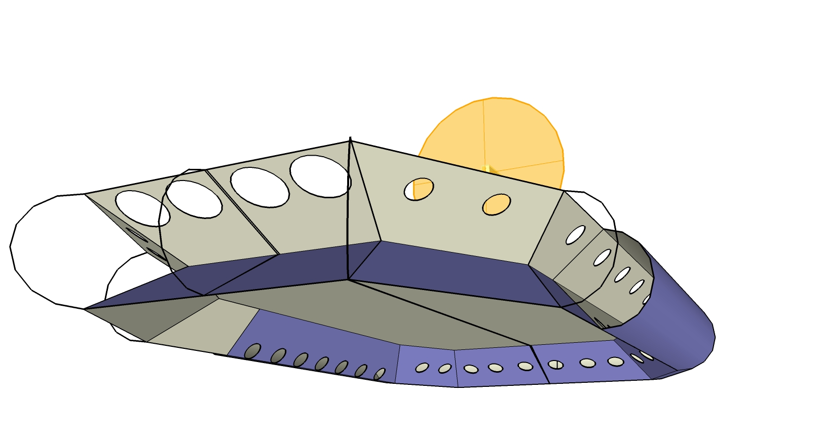

  4. kram242
    Looking forward to this project Tomas
    I like the look of these bad boyz!
    [​IMG]
    I started to make a few designs of these a while back . I will post the files.
    I also have to say CG matters a lot with these craft especially if you are using one shared motor that pumps up the skirt as well as propels the craft forward. I like the fingered skirt design but they are hard to make
    Here is a link to an attempt at a flying hovercraft the hoverhopper that may help
    viewtopic.php?f=37&t=1563&start=0&hilit=hover+craft
    Hope this can be a help Attached files HC.skp (227.7 KB)Â [​IMG] HoverCraft 3B.skp (63.2 KB)Â [​IMG]

    I made one that had a shared lift and thrust motor. Didn't work out all that well.
    The next one I design will separate the fucntions. That way you can adjust the lift for the conditions and not have big changes in control based on speed.
