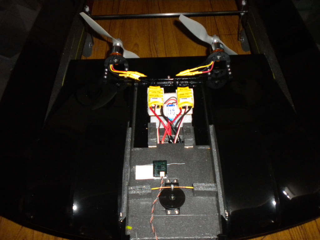

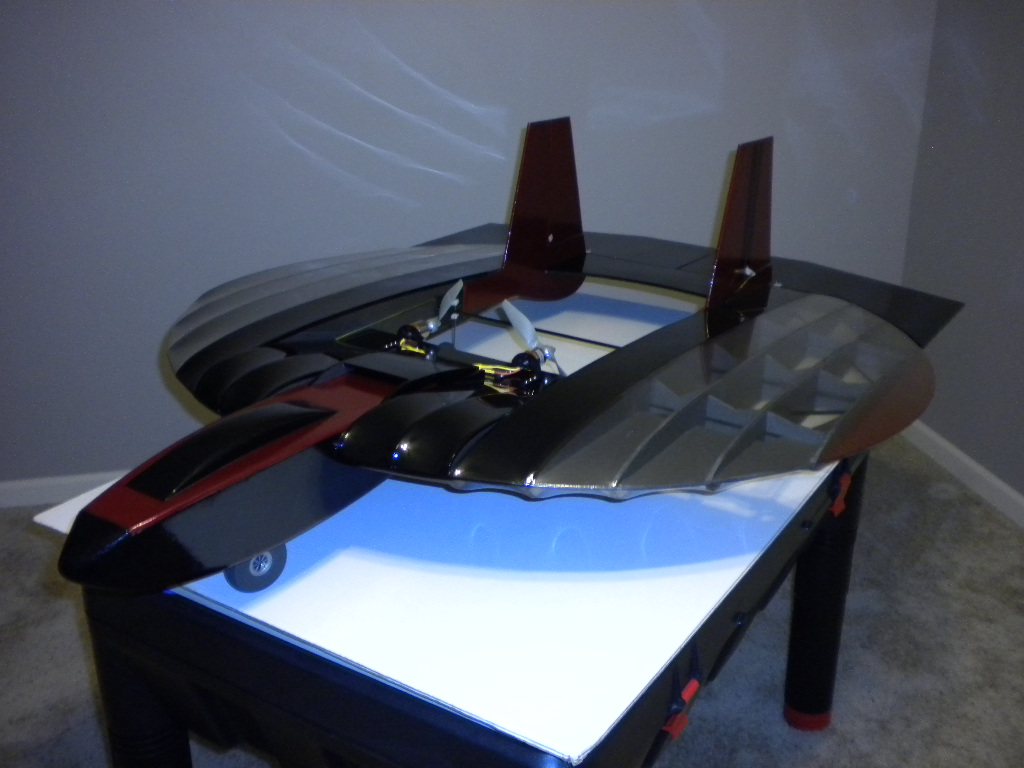

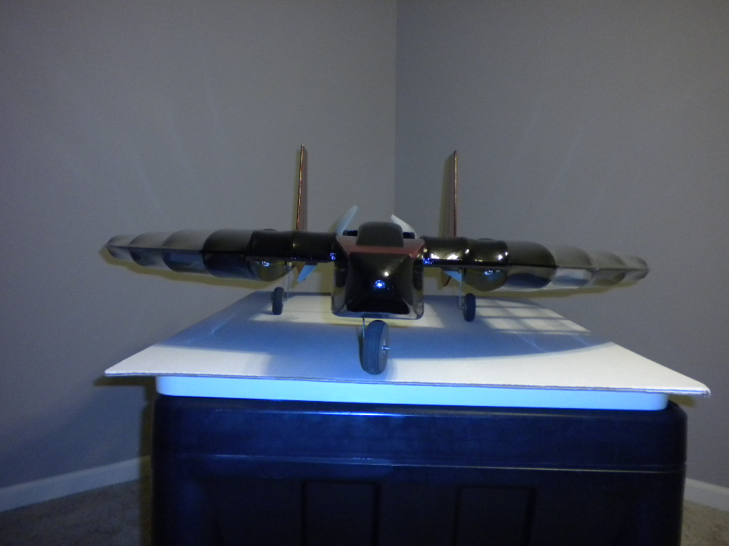

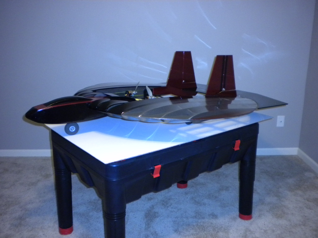

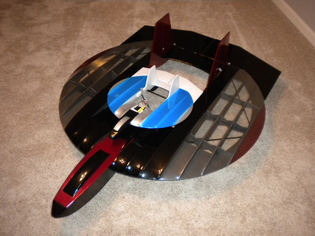

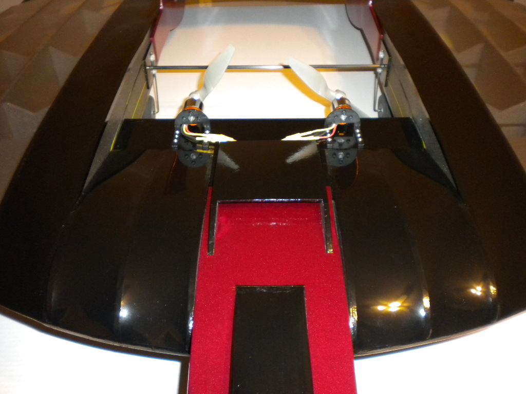

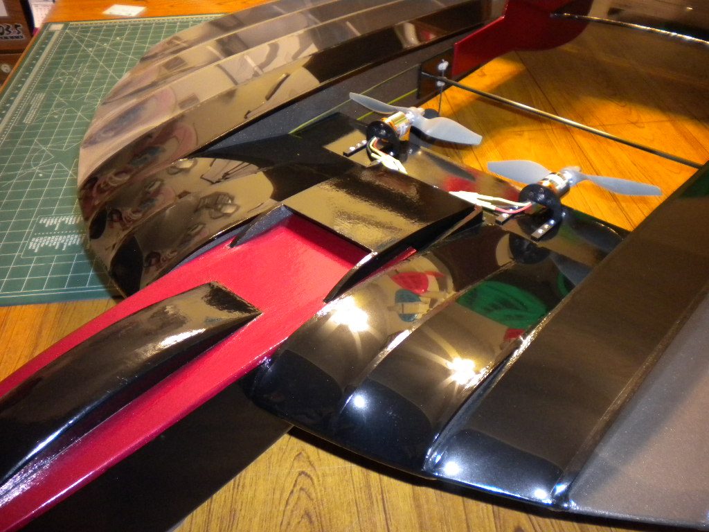

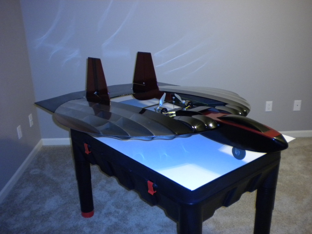

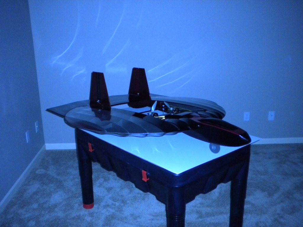

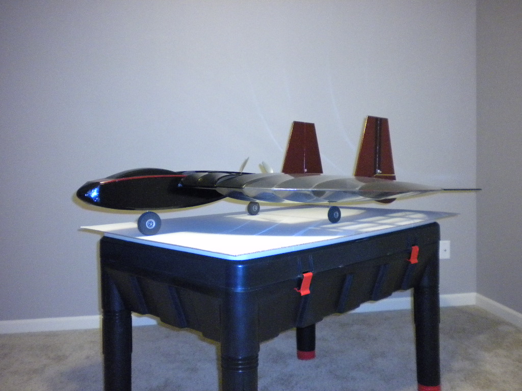

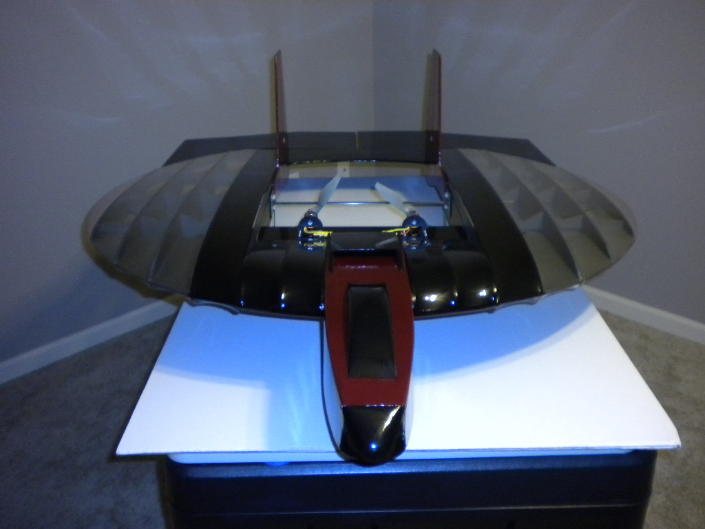

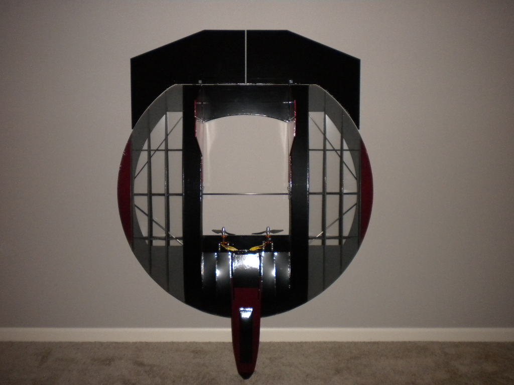

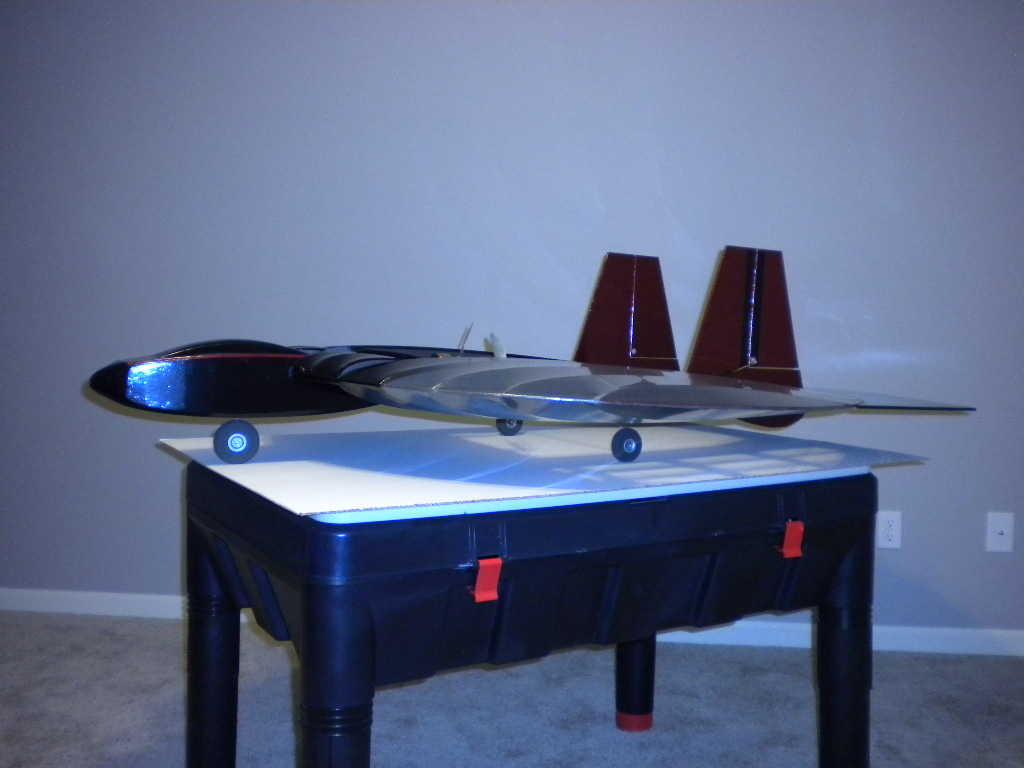

    The 45" saucer is finished. With a 3200mah lipo, it weights about 60oz.
    Here are some pictures of the completed saucer.
    Attached files [​IMG] [​IMG] [​IMG] [​IMG] [​IMG] [​IMG] [​IMG] [​IMG] [​IMG] [​IMG] [​IMG] [​IMG] [​IMG]

    Yes, you and the PhlatPrinter sure opened a door to another dimension with this plane. That is un-freakin believable! :shock: How did you get the covering so tight without warping the depron structure underneath? You have got to get video of this plane in flight!
  9. KX-5
    KX-5 Member
    241
    Urbandale, IA
    meistertek, thanks for the comment! Covering foam is tricky. And very time consuming because of the warp factor. I probably spent 15 to 20 hours on the covering. I've experimented a lot with covering types. The first requirement is a low temp covering like Tower Hobbies 21st Century Microlite film. It has to stretch easily at a low temp. Then the next key element is the temperature of the iron. About 240 degrees seems to work well for me. I use the regular iron to seal the edges. I don't use the regular iron to do the major shrinking step. I think it applies too much heat in too large an area at one time which causes major warping. After sealing the edges well with the big iron, I then use the very small trim sealing iron to do the final shrinking. It applies heat to a very small controlled area. For me, this keeps the warping to a minumum. But, even with careful shrinking, you will still have to work out some warps. But, this is no different than with a balsa built plane. It is one of those type of tasks that are best done in the morning when you are well rested and patience is better. Trying to cover foam at night after a long day at work does not always work well.
