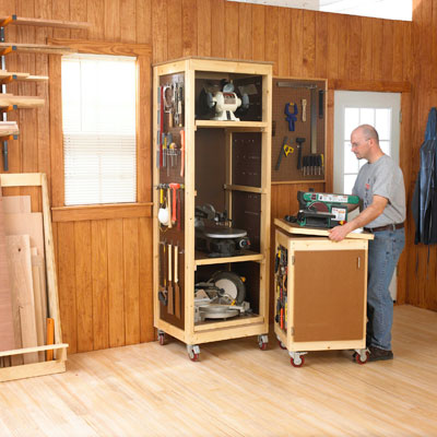

    I've always had organization problems, but ever since I started scratch building and using my PP 3 it has gotten worse. I needed a better way to use and store all of my power tools. I saw this system in the October 2007 issue of Wood Magazine. I decided to make some changes to it and now the building has begun.

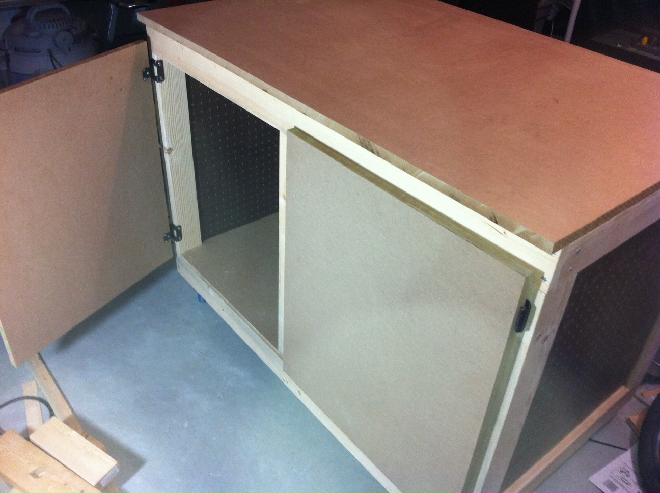

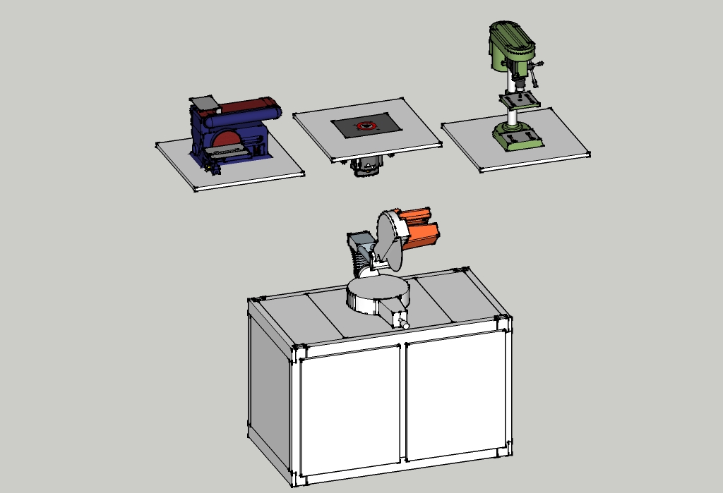

    The universal bench is 4' x 2' 3" and it is 34" high. The left and right sides are made out of Pegboard to store all of the tool related stuff, like sand paper, adjustment wrench, bits, etc. The storage underneath is huge, it's ~21ft^3. It is almost complete, all I need to do is make the cutout on top for the tool base. I'll be adding power outlets, switches, and attachment points for various add ons.
    The Tool rack has not been modeled yet, but it will be very similar to the original one picture below. Both units are on wheels for easy movement.
