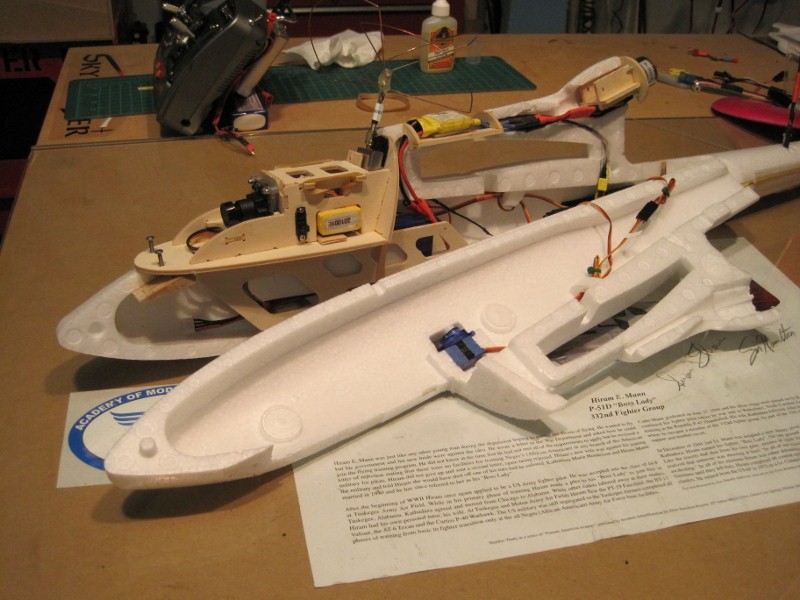

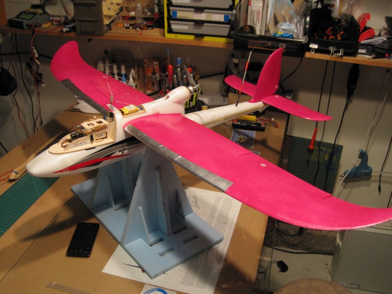

    I bought a Skysurfer (Bixler) about a month ago for migration to it as an FPV platform. Its a pretty nice easy star style plane. Made of EPO foam in a pusher config, these are often sold as beginner planes. I wanted to try it for FPV flight as the SlowSticks, while fun and all, are not exactly aerodynamic with all the gangling bits and they really don't like the weight of additional FPV gear.

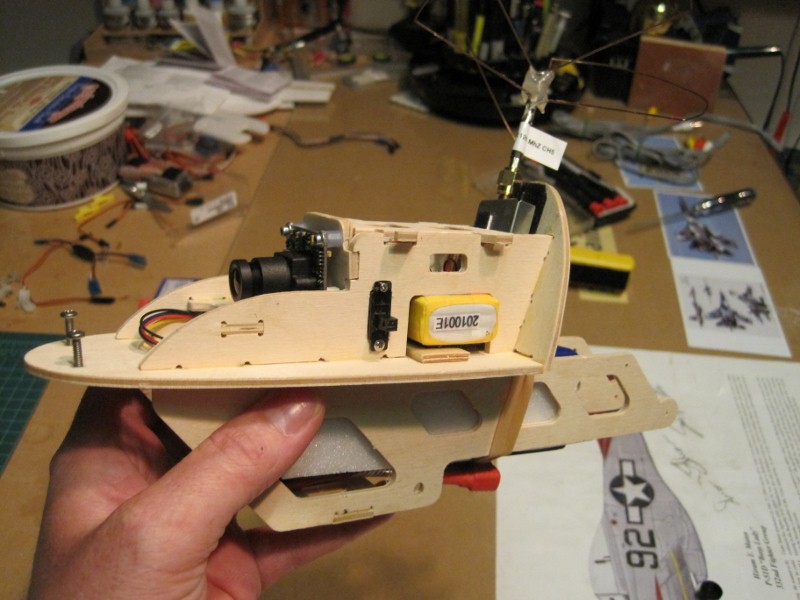

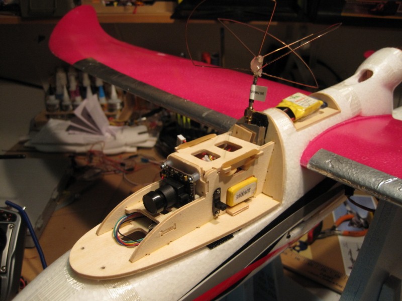

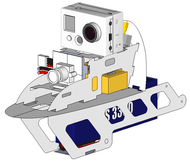

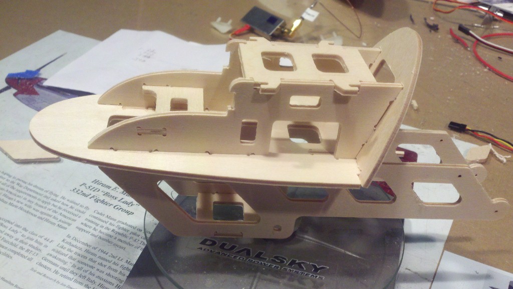

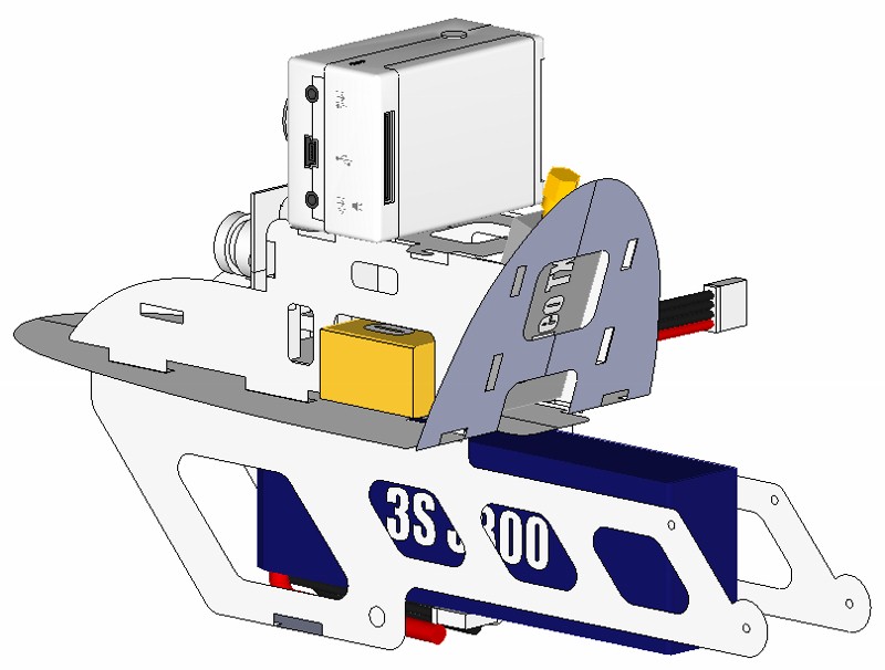

    I saw several neat custom pods designed for adding cameras and protecting gear, but one really caught my eye. Unfortunately, they guy was preparing to sell it through readymaderc.com (good vendor, btw) but it looks like that plan is in a holding pattern. So I took it on myself to design one that was similar, but satisfied my personal needs (like an on-board battery for the video, and support for a gopro optionally). After much contemplation, this is what I came up with:
    I cut out a set of pieces in 3mm birch ply. I had some strange skewing and it had me scratching my head. After fiddling with the mechanicals, I couldn't figure out why I was getting misaligned pieces and cuts that should be straight coming out with diagonal angles. Then it dawned on me, the bit (1/16th chipbreaker) had a worn out tip and that was causing the bit to bite and twist a bit on the surface! I switched out to a new bit and the problem went away.

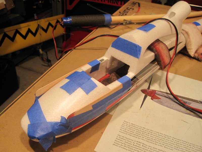

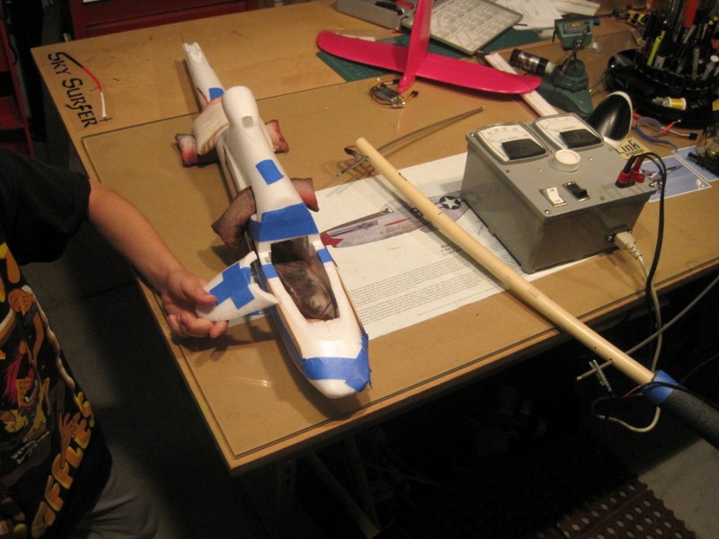

    My son helped me hotwire cut the canopy area of the plane. I used tongue depressors for quick and dirty guides. I also designed and cut a motor mount/ESC tray for the plane.
    Pod assembly required a few bits of work with the dremel to get a good fit. I have the changes noted so that if I make another, it will go together easier.

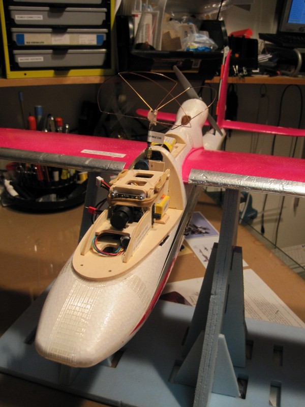

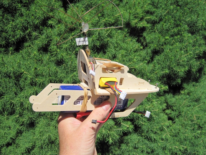

    So, I came up with an AUW of 1070g w/3000mAh 3S pack, 2212-6 motor with 6x5 APC, 30A ESC, Chainlink UHF system, 600TVL Sony SuperHAD DWDR, 800mw 1.3 vTX, homemade RHCP antenna.
    I flew it LOS last night. I was by myself at the field so I didn't dare try FPV. Despite the full AUW (I understand that I could go up to 1.25 kilos on this frame), it flew like a buttery smooth plane. Handled 10-15mph winds nicely and had no lack of power to gain altitude. I flew for 3.5 minutes and use 370mAh of the pack! That works out to potentially 27 minutes of flight time. Really not too shabby as I like to fly local and low.

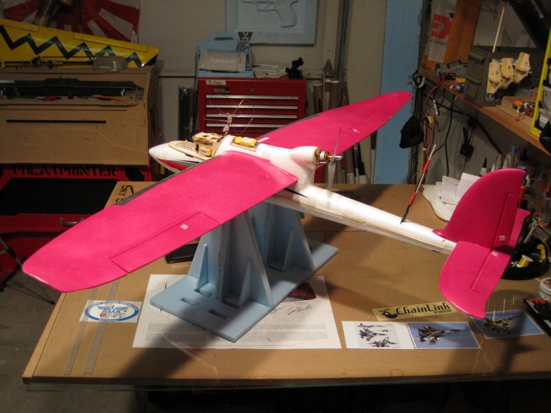

    FYI, the CG balancer/stand is the one posted here: viewtopic.php?f=213&t=1942

    Wow.. That's really cool. I have one of the Easy Stars, and it's a really nice controllable floater stock... I was thinking about the weight being a problem as I was reading the post, but glad to hear it wasn't an issue.
    That sure is an awful lot of down thrust, or is that just an optical illusion?
    Can't wait to see some video out of this one.....
  5. Evil-Tunes
    659
    Southern N.J.
    Because of being behind the CG the down is needed.

    yeah, what ET said. easy star is a fair bit smaller, as well. I was surprised when I needed no trim for the test flight. Have to try it in low wind still. No ballooning on throttle changes and forgiving stall character. Good stable plane so far, I probably want to get another.

    Update: Flew two FPV flights for a combined 35 minutes of flight time. All I can say is....wow. this is the bombdigity! So smooth and easy, and such a floater-even at this weight. I was considering adding a gyro to the ailerons, but after flying it fpv, I can see no need to do so.
    I kinda wish I'd just gone to this platform for my first FPV flights. I don't think I could ever go back to a slow stick for fpv again. Best $49.00 airframe I've ever bought!

    Thanks guys. I've tweaked the design with lessons learned and posted it to the VIP lounge for Phlat owners exclusively.

    Not much by way of updates to projects or anything, but I have been enjoying the heck out the Skysurfer FPV and pod posted earlier. Some people have questioned about the weight impact on the airframe, and truth be told, it adds about 70g to the overall weight. Adding a gopro and with crash case beefs this up even more. AUW with a 3300 is around 1250g (almost 3lbs). That sounds like a ton, but the airframe handles it very nicely. Aggressive flight times are around 15 minutes, and going easy on the throttle gets me about 25 min. The vertical suffers as does the roll response, but it gets 45mph on a straight line and can crawl at a gentle 8-10mph.
