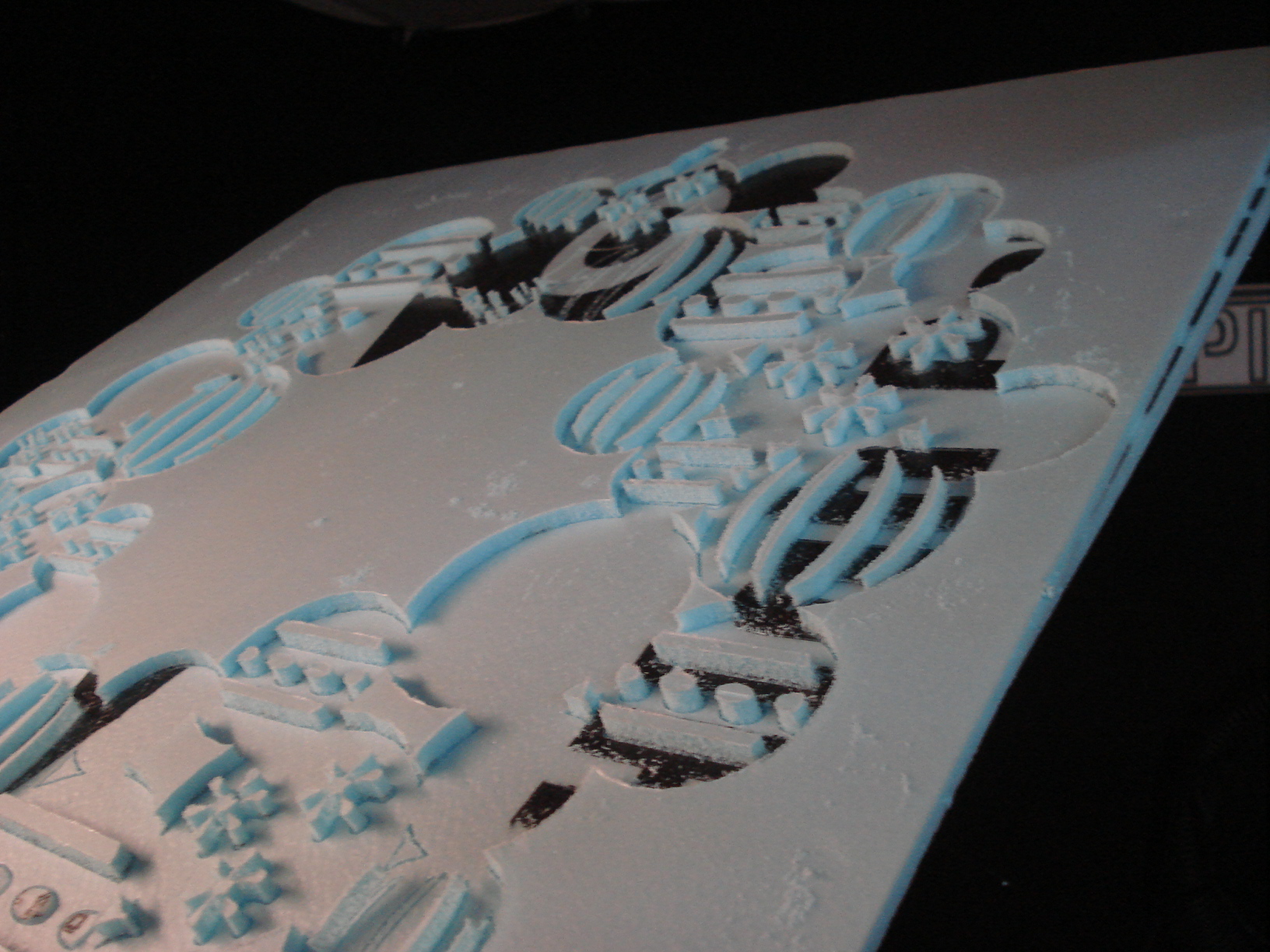

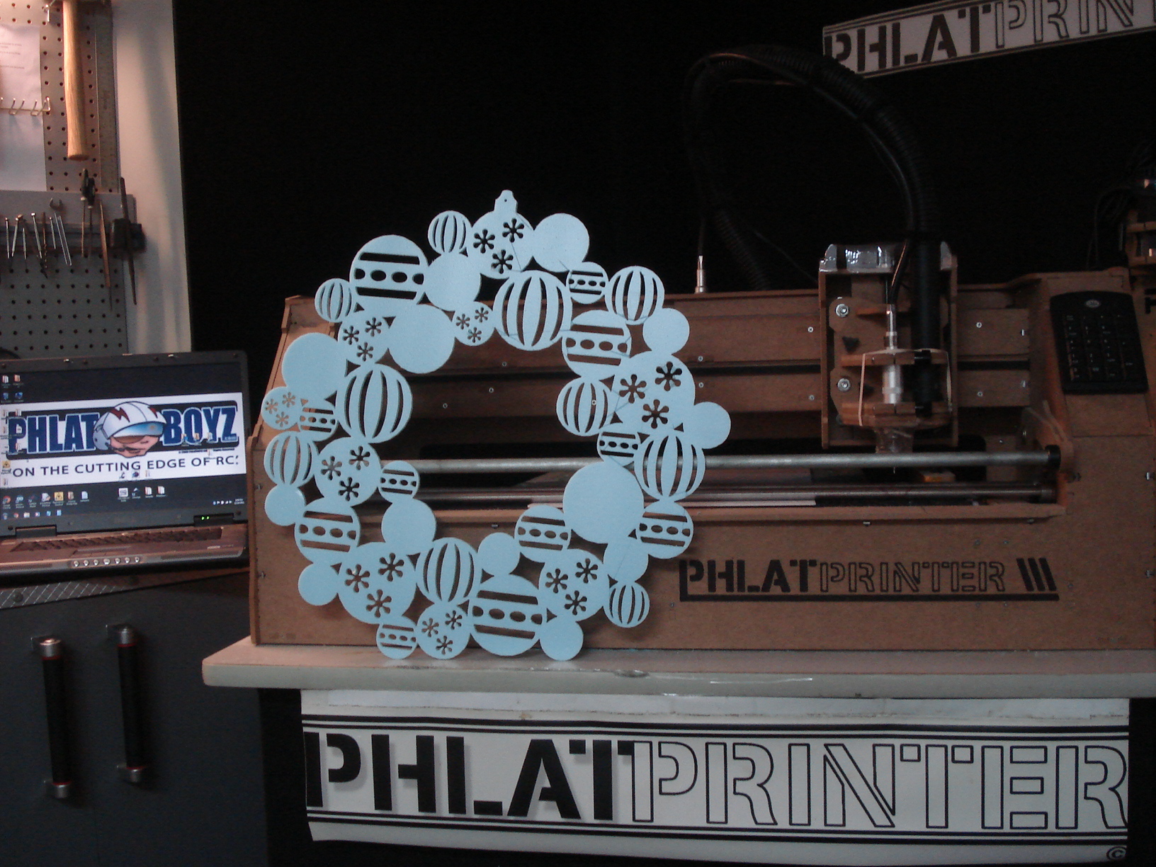

    Christmas Wreath
    Info: On this cut we folded a sheet of fanfold in half to do the tab-less cutting technique You can also do this with depron and it works as well. We used a 1/16" bit using step cuts as well. Here is a video showing tab-less cutting on a complex model.

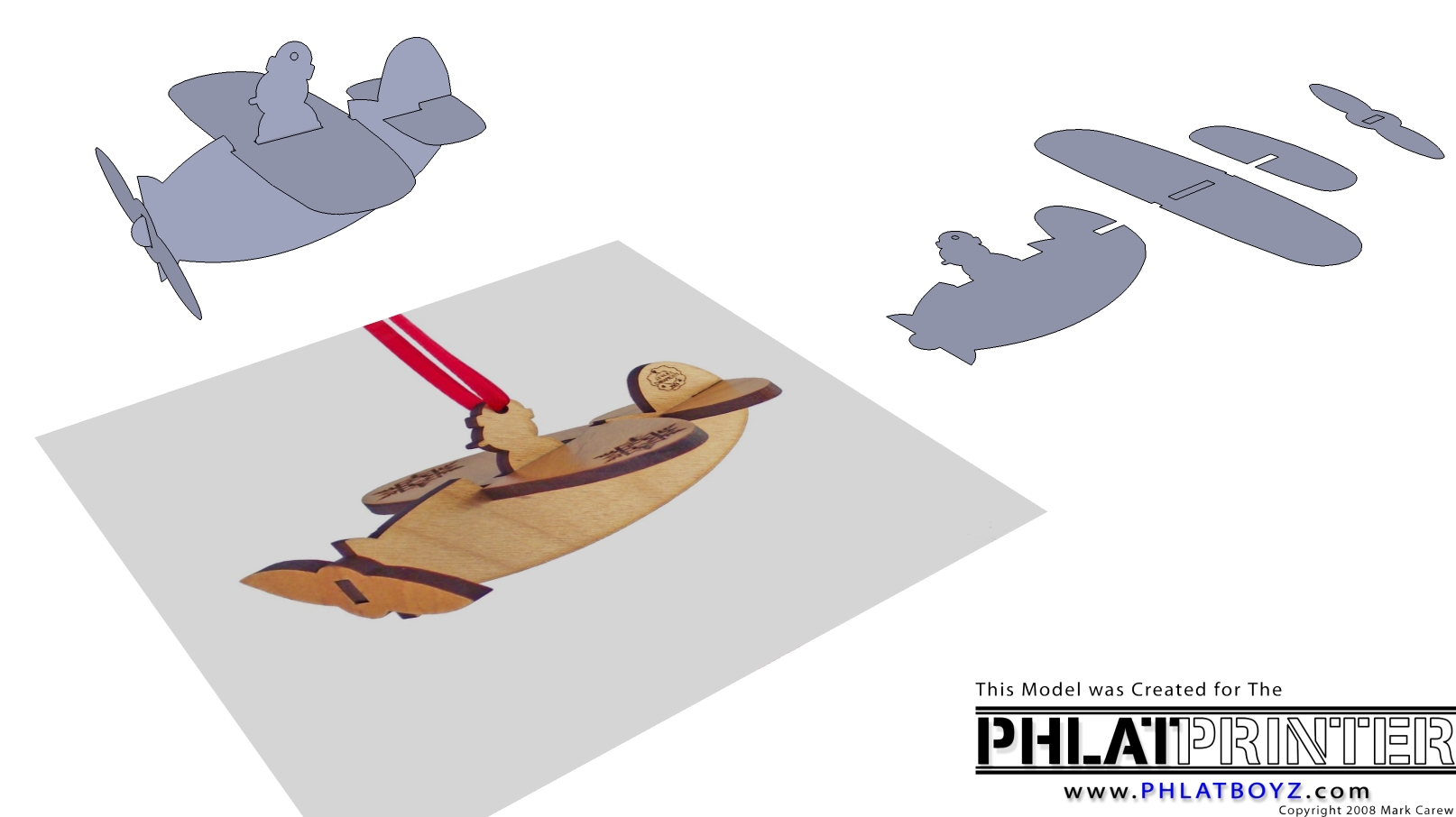

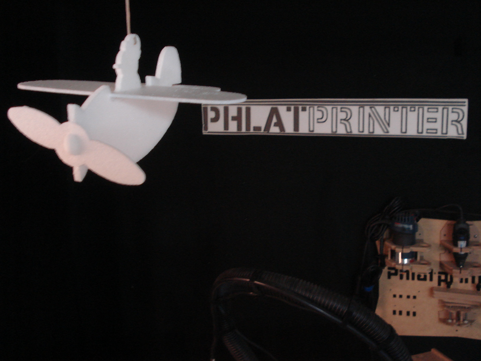

    Christmas Plane
    Info: We used 3mm depron with this cut and a 1/16" bit

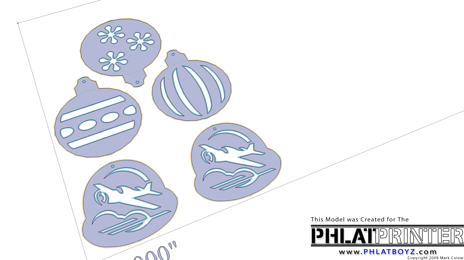

    Christmas Ornaments
    Info: We did not get time to cut this one out, let us know if it works for you. Set up is 3mm depron with a 1/16" bit.

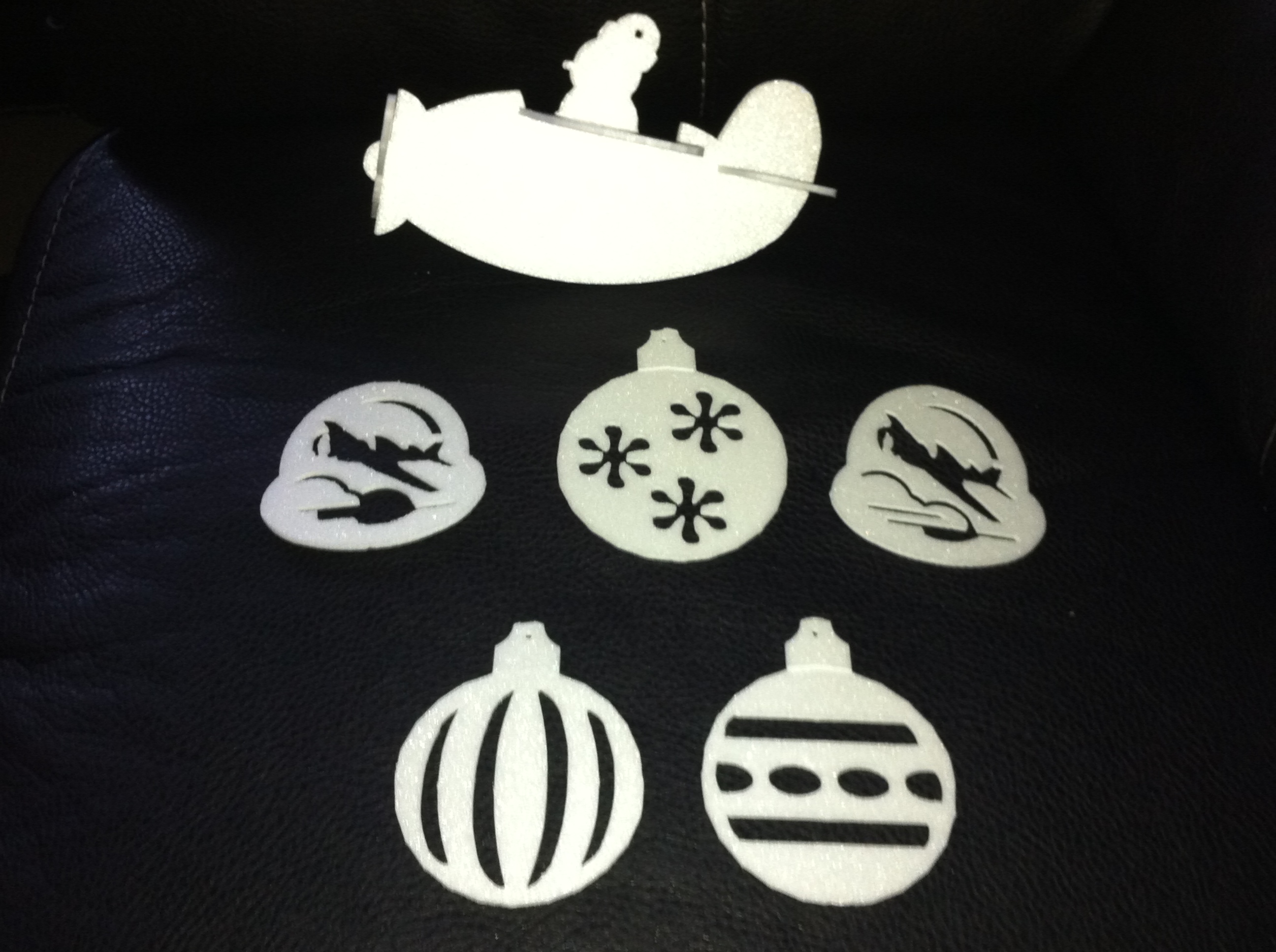

    Well, thanks to the awesome support and generosity from Mark and Trish, my PP 3 is back up and running. I got it running right after this weeks show, so I used these to test the machine. Everything turned out great. The swirl on the propeller did not come out perfect, but it still looks cool.
    Edit: I forgot to add the photo. Attached files [​IMG]
