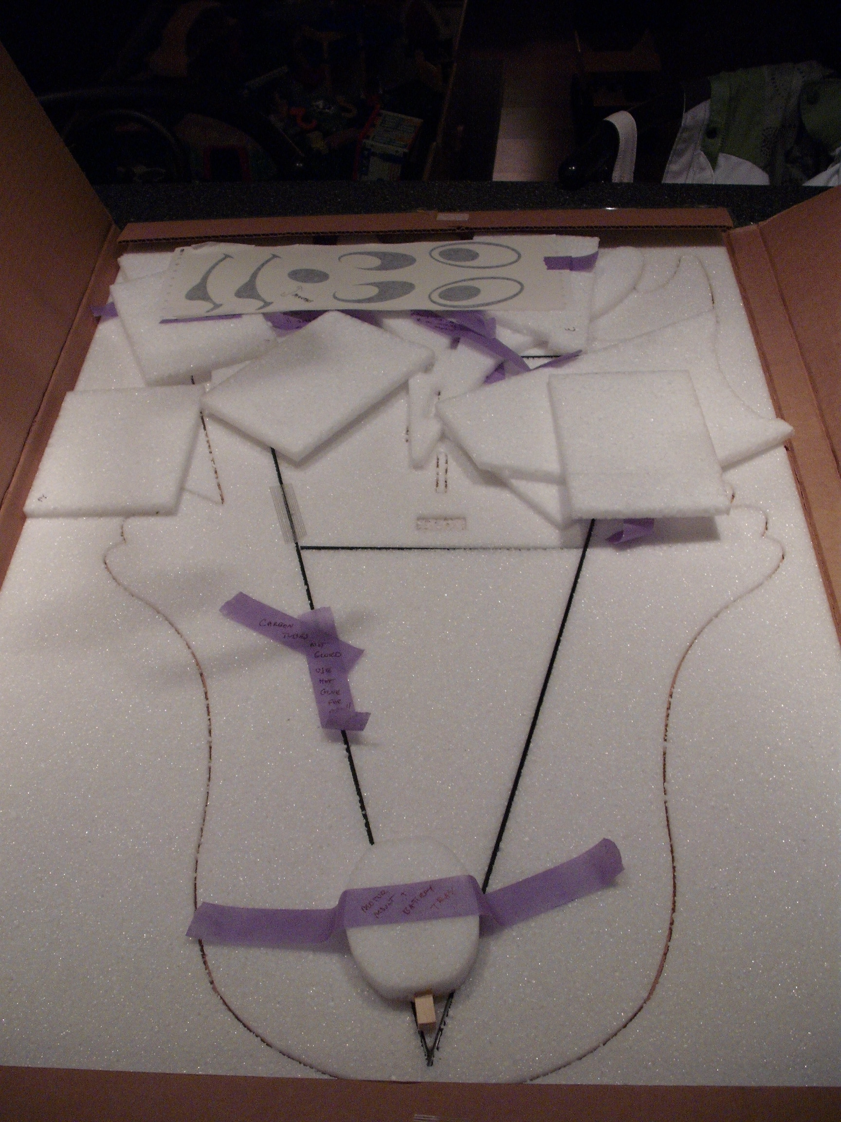

    I recently got an http://www.XtremeFoamies.com "Flying Ghost Plane" and figured I would share the build and my thoughts with you all.
    The kit arrives nicely packed, in a box sized perfect for this airplane. There is no wasted space, and you can actually get this one back in the box, if you don't start building it the second you take it out for the first time.

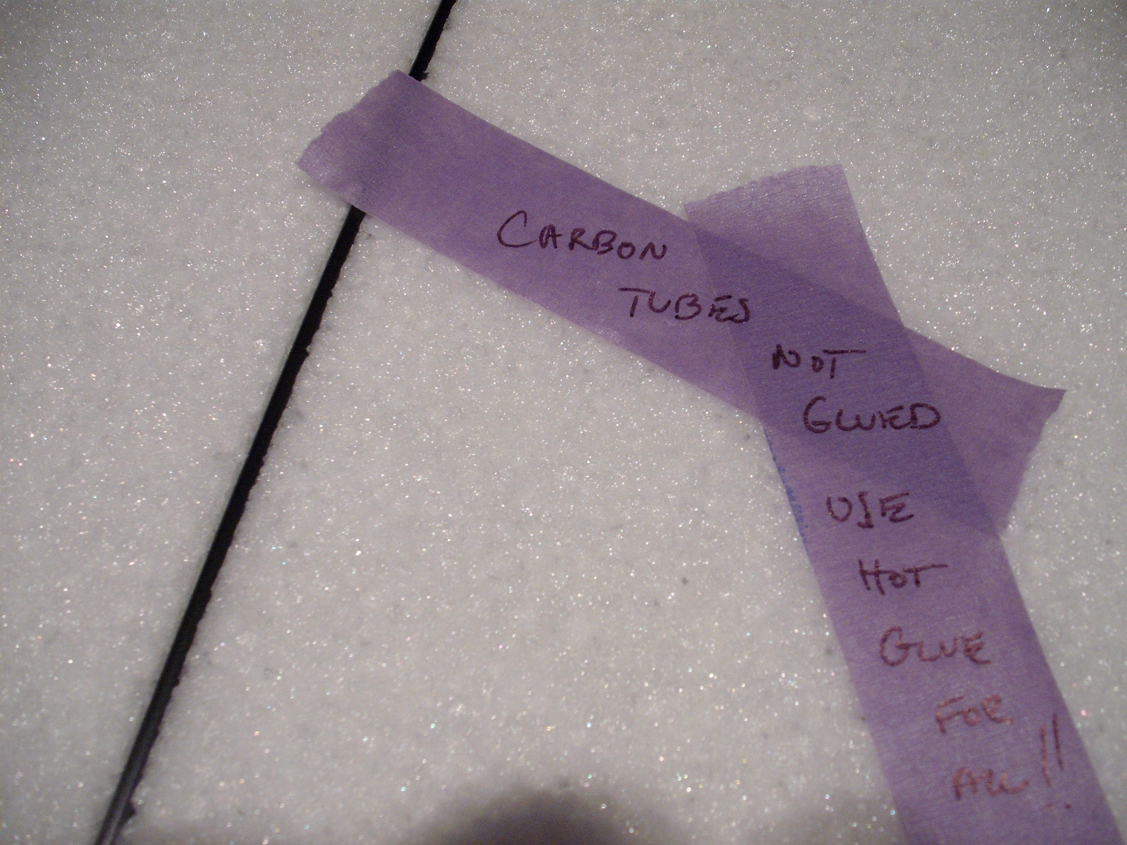

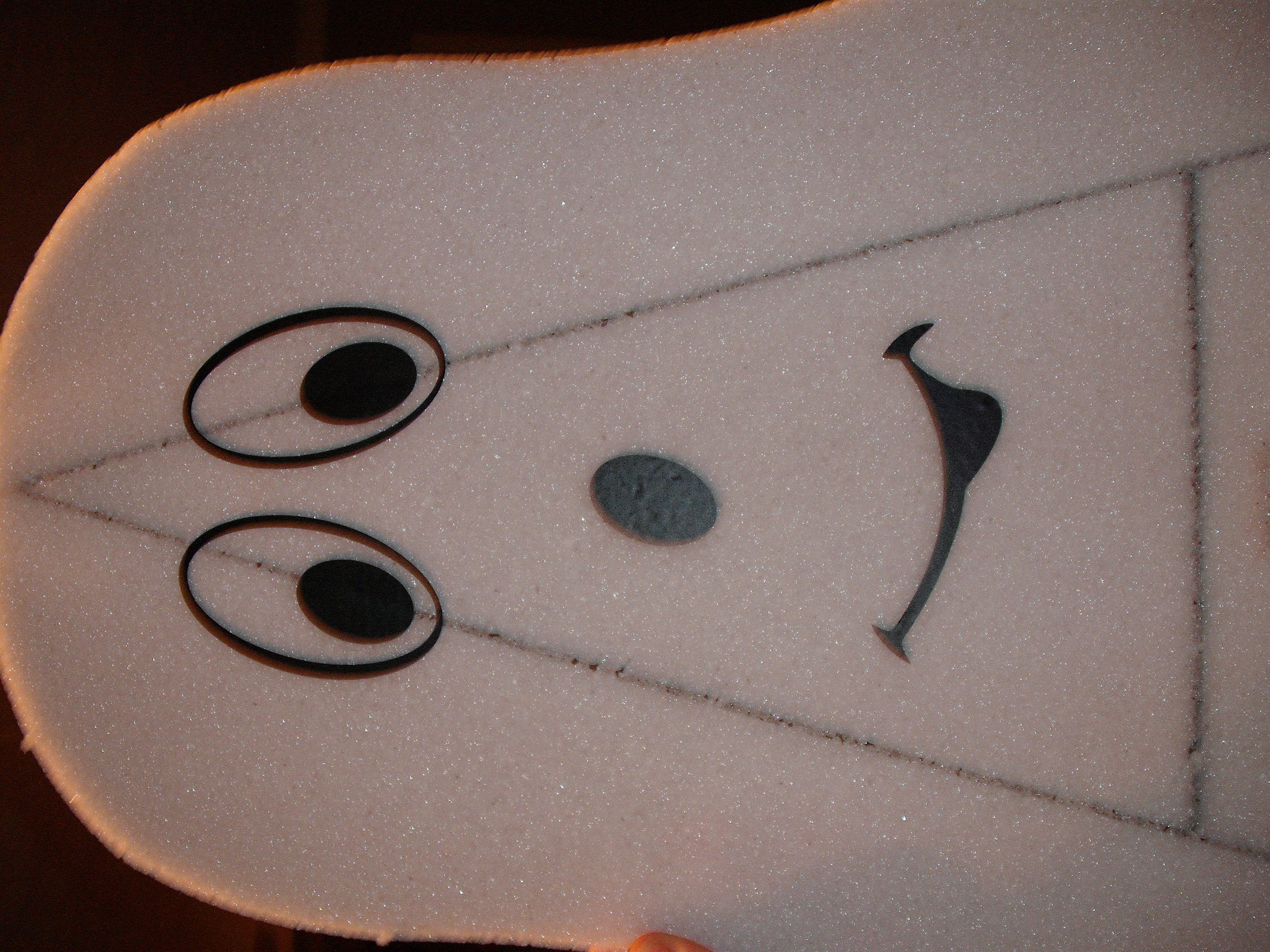

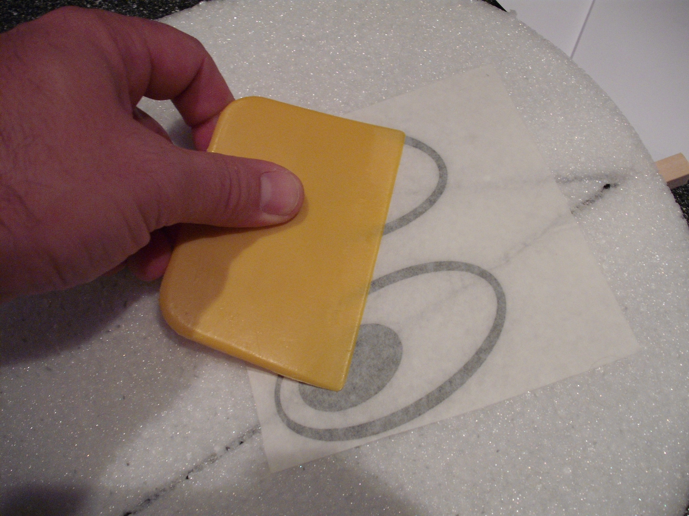

    All the parts are labeled, and the carbon rods are placed in their respective slots. They even include some nicely cut vinyl decals of the eyes, nose and mouth! The labels point out several important points, such as the correct way to install the rudder, and what the parts of foam are for. They even include some spare EPP for repairs!

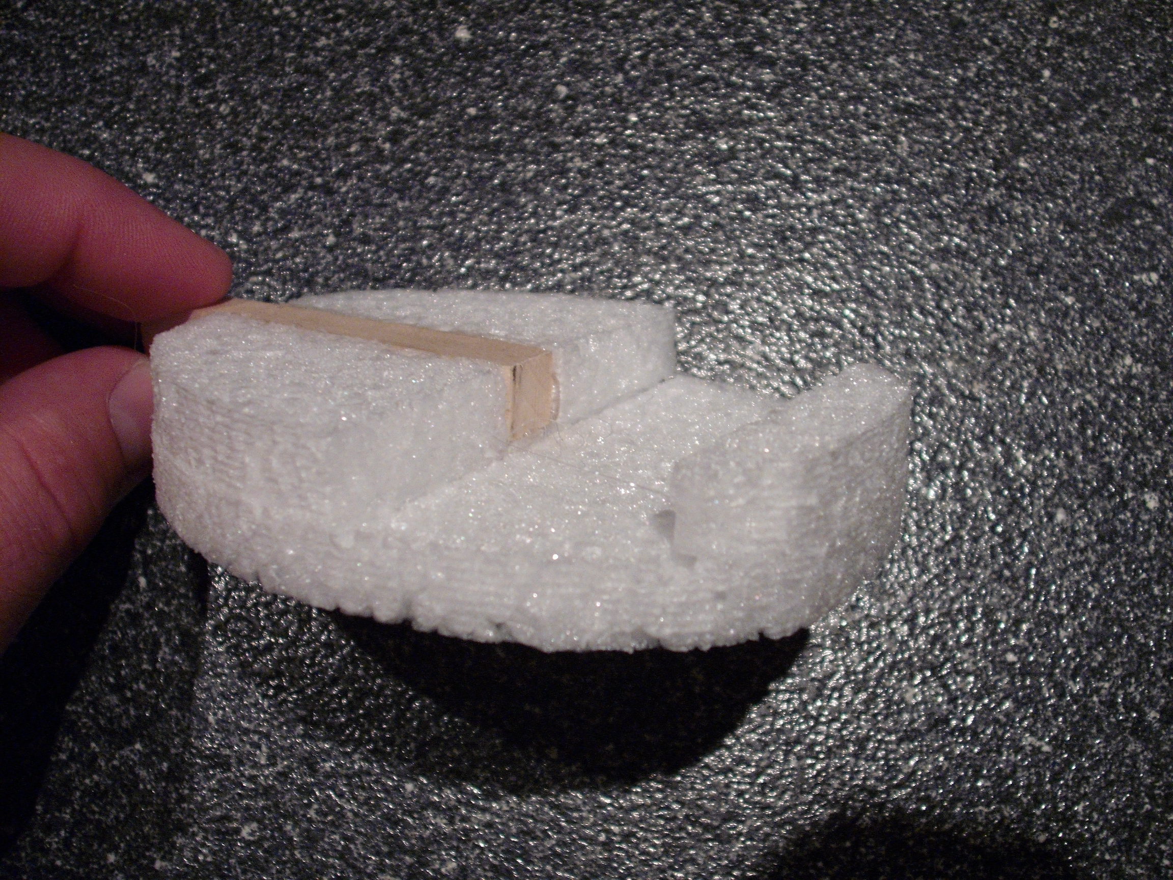

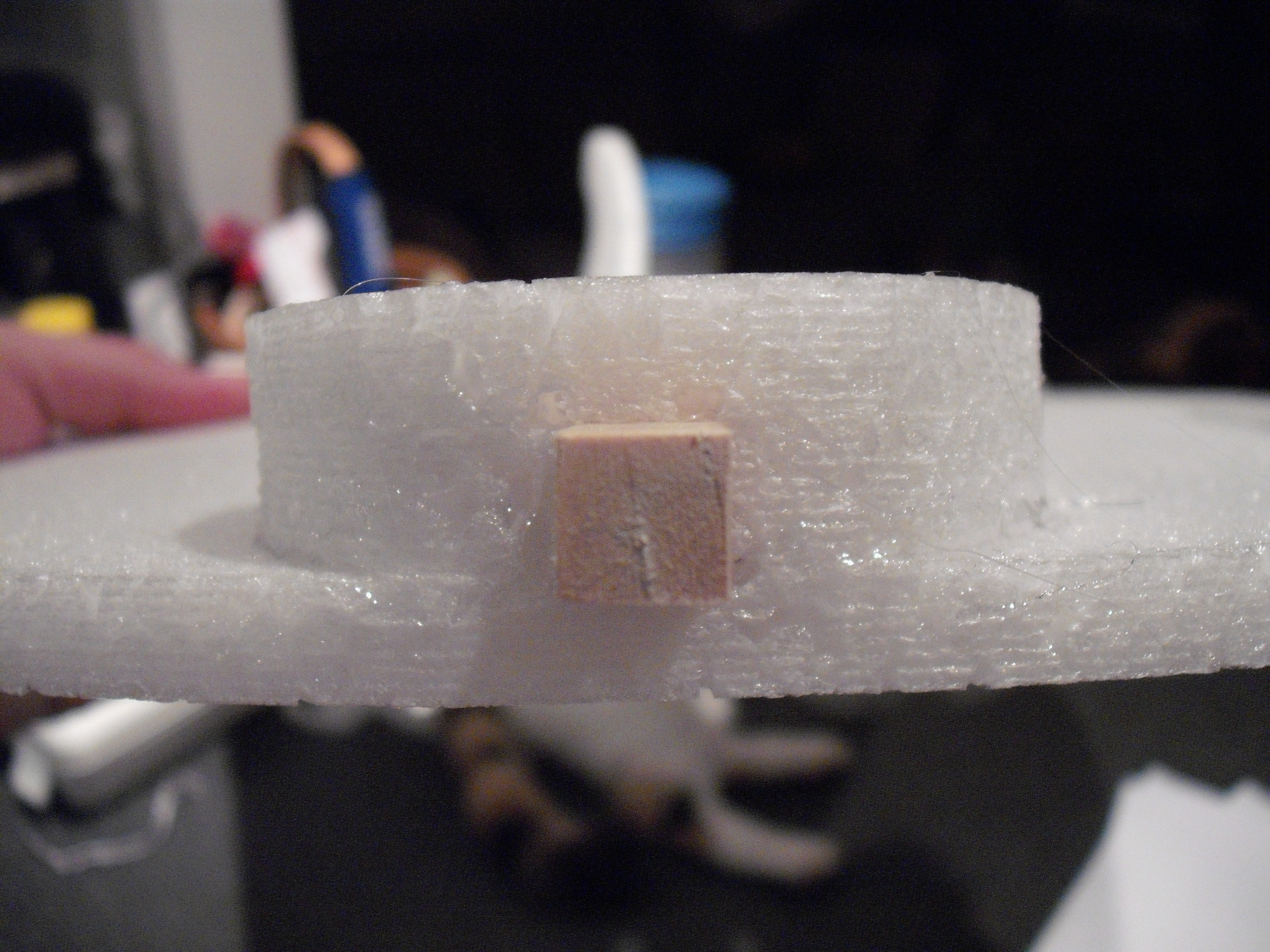

    The motor mount/battery holder comes pre-assembled...glued up and everything, which helps to speed up the build time!

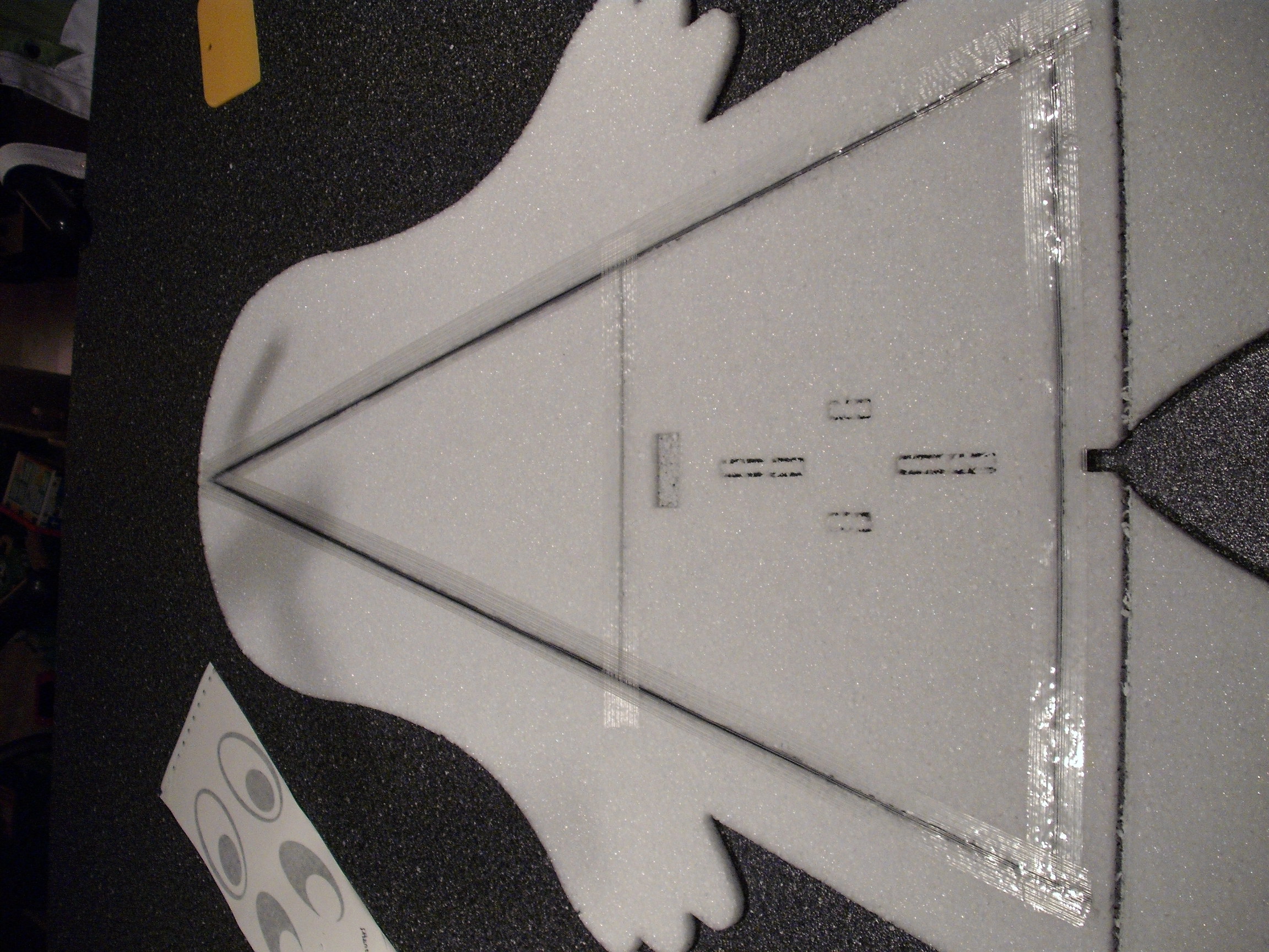

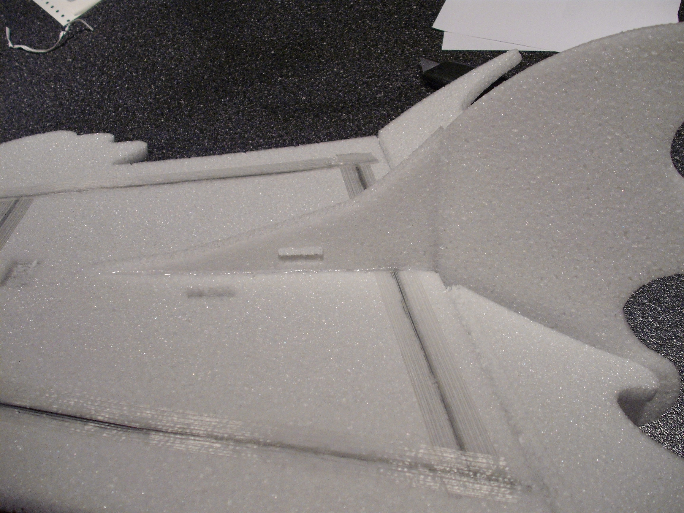

    The kit is CNC cut, and everything fits together well, from the slots the spars slide into, to the rudder and motor mount. Total build time, including installing the electronics was 1 and 1/2 hours. Hot glue was used as recommended, and the assembly is very straight forward.
    You run a bead of glue and lay in the spars, then tape over them with strapping tape. After that, you install the rudder/stab in the same manner, making sure they are at 90 degrees to the body. After that, you simply glue on the motor mount assembly, and it is time to install the electronics. Oh...I forgot to mention hinging...maybe that is because it isn't required!! This kit is CNC cut with a PhlatPrinter, and the hinges are already beveled and the surfaces are attached to the plane already. This is done by carefully selecting the depth and path which the router bit travels.

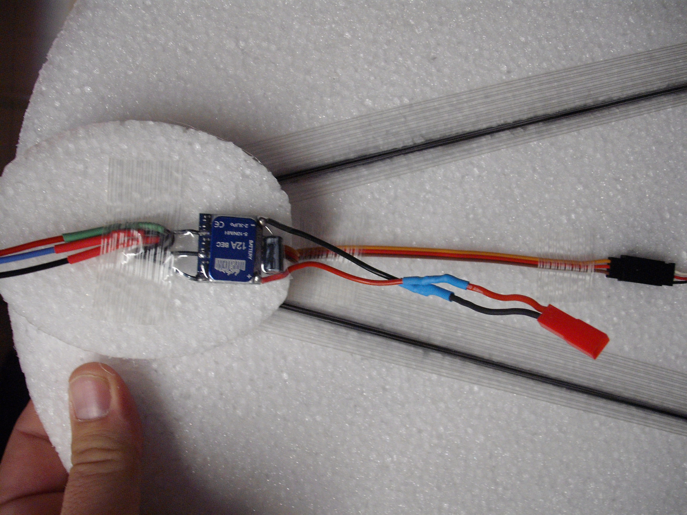

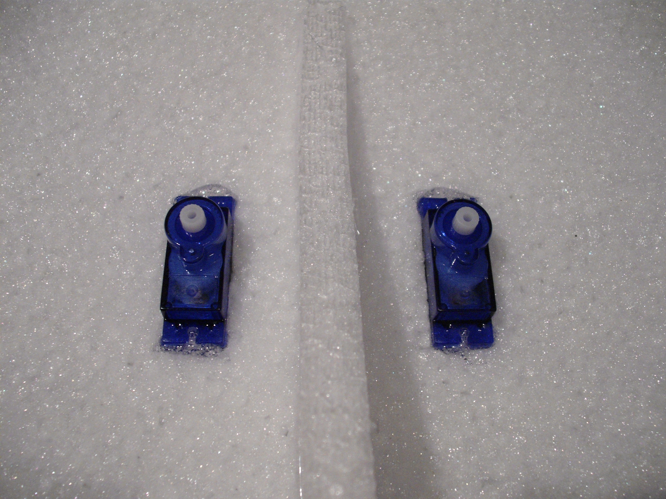

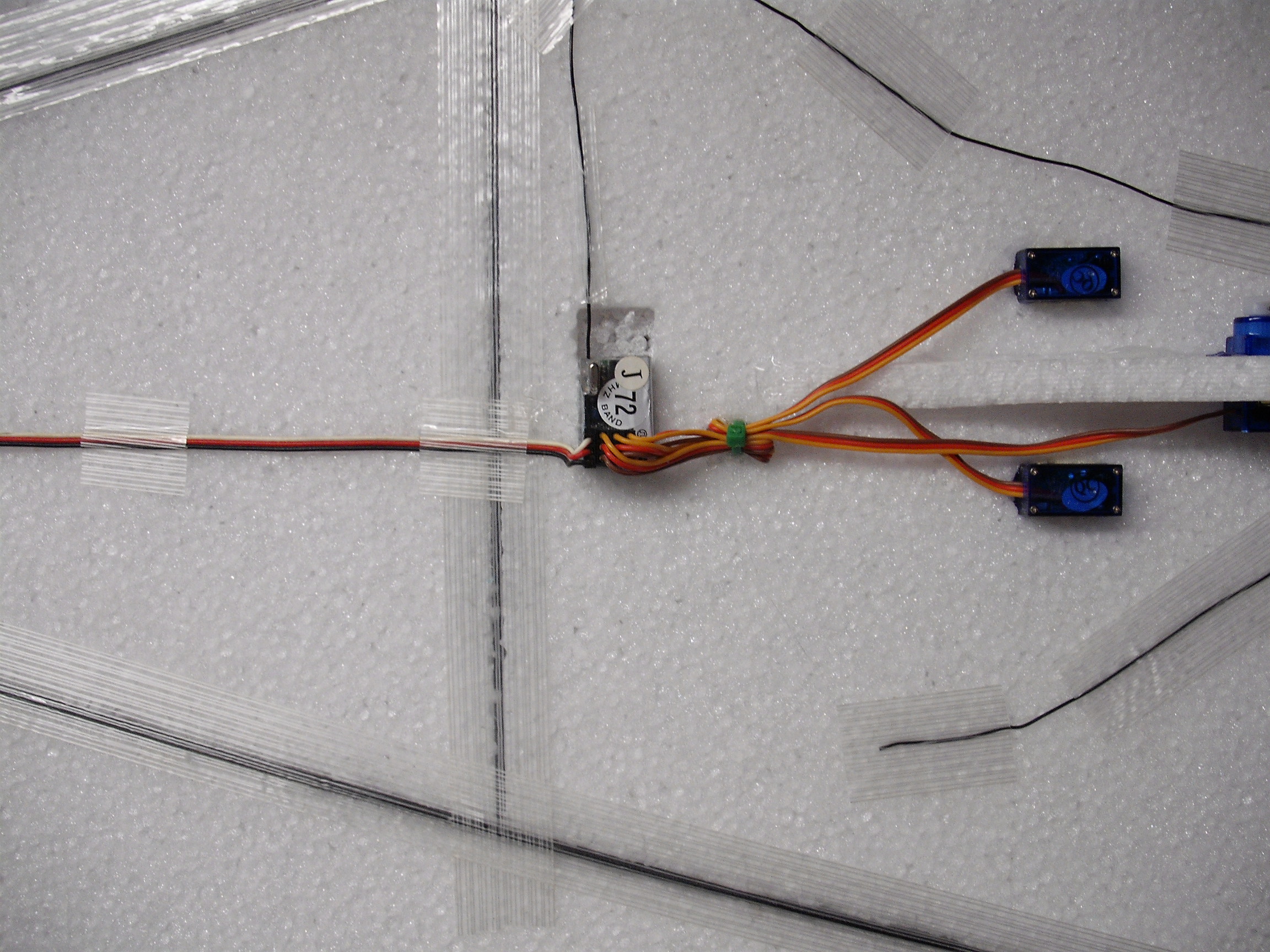

    The electronics install is simply as well. the servos have pre-routed locations, as does the receiver. The motor has a stick mount, ready for the installation of the suggested Blue Wonder!
    I deviated from the recommended setup, because my Hobby King order hadn't come in yet. I used 3 HXT 9 gram servos, They recommend 2, 5 grams on the elevons and a 9 gram on the rudder. I also didn't have a 1700KV Blue Wonder on hand, so I used a 2205c 1400kv motor. I had to make a mount plate, but that was because of my motor choice. I also am powering mine with a 2 cell TP 480.
